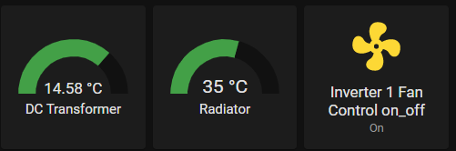

Aahhh, okay. I have not seen or noticed the internal fan/s. The unit is pretty well sealed, so I do not know. I was concerned with the constant high temps on my unit so opted for adding air flow.
My fans are running from a Sonoff basic, which is part of my Home assistant setup. Currently I am managing it manually via the HA app. Switching 'on' in the morning and 'off' later the evening. Automation should not be major issue.
