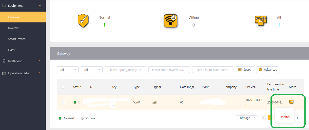

If you go on the remote sunsynk page
Under gateway you will see this. Some documentation I have seen shows a upgrade option there.
It is more for curiosity :)
I don't have an upgrade option there. Only Unbind is available (same as yours).
23 hours ago, Gary Waterworth said:
Hmmm ok, so not the same version as mine and looks older. This doesn't look like a software upgrade then that did this.
If you click on the ... does it have an upgrade option or just the unbind ?
