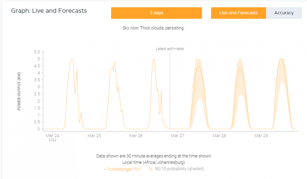

zsde Posted March 26, 2022 Posted March 26, 2022 (edited) You can open a free account at Solcast and monitor their forecasted yields compared to your actuals. They are pretty accurate. Remember you should add your site data in terms of Azimuth and tilt as accurately as possible. Also their forecast models are based on best available solar radiation forecast models and actuals do vary at times especially with broken clouds around. Here is their write up about the forecasting models. https://articles.solcast.com.au/en/articles/2963469-solcast-probabilistic-forecasting-fields-what-are-they-how-do-we-create-them Go to the "Add Site" link and create your free account. https://toolkit.solcast.com.au/ Here is an example of what my site data forecast is right now, including the actuals for the past 3 days and the forecast ahead for the next 3 days. Edited March 26, 2022 by zsde Quote

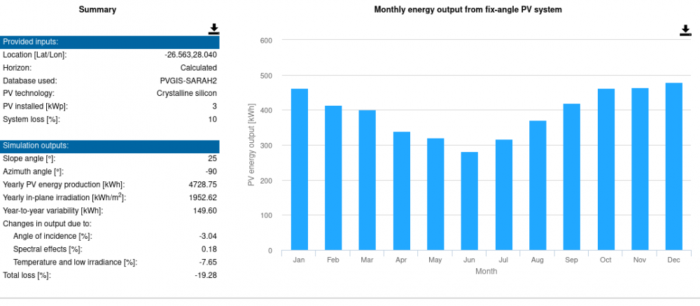

P1000 Posted March 27, 2022 Posted March 27, 2022 https://re.jrc.ec.europa.eu/pvg_tools/en/tools.html#SA Around 13kWh/day in March, assuming no shadows and you utilize 100% of it. (I guessed you are somewhere in Gauteng) Kalahari Meerkat 1 Quote

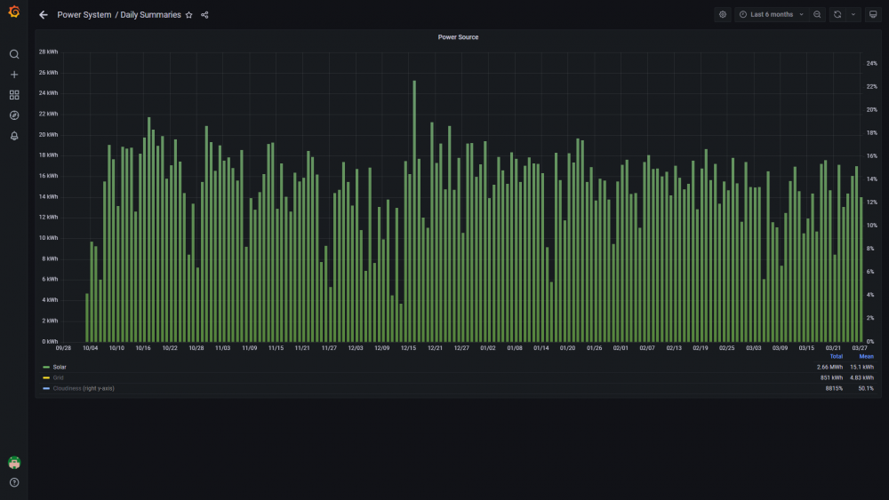

werner.potgieter Posted March 27, 2022 Posted March 27, 2022 I have 8 x 460W panels, facing N at approx 30 deg tilt. I am in Pretoria-East area. My generation graph below: Clint 1 Quote

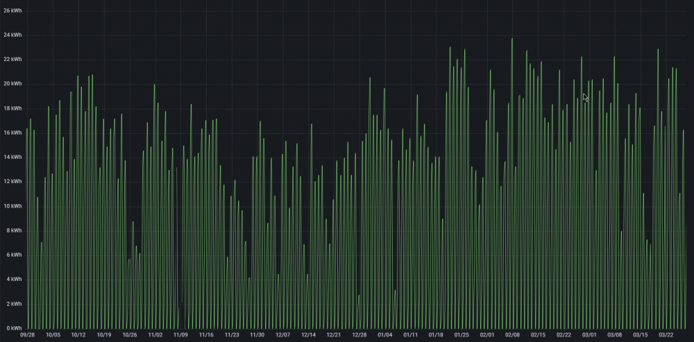

Antonio de Sa Posted March 27, 2022 Posted March 27, 2022 @Joerg and @Werner Pieterse I have 12 X 410 W panels two 5000 W growatt inverters here is my solar production since installation. very similar to the one above Quote
Froggie Posted March 27, 2022 Posted March 27, 2022 Just note OP's panels are facing east Antonio de Sa 1 Quote
Joerg Posted March 27, 2022 Author Posted March 27, 2022 10 hours ago, P1000 said: https://re.jrc.ec.europa.eu/pvg_tools/en/tools.html#SA Around 13kWh/day in March, assuming no shadows and you utilize 100% of it. (I guessed you are somewhere in Gauteng) Thank you. That's what I'd expect, also. I am in Knysna but the values shouldn't differ too much...Wondering why they are so low... Quote

Froggie Posted March 27, 2022 Posted March 27, 2022 (edited) 32 minutes ago, Joerg said: Thank you. That's what I'd expect, also. I am in Knysna but the values shouldn't differ too much...Wondering why they are so low... Because they're facing east. You should be getting about 12kWh per day in March as per the photovoltaic GIS. Edited March 27, 2022 by Froggie Quote
