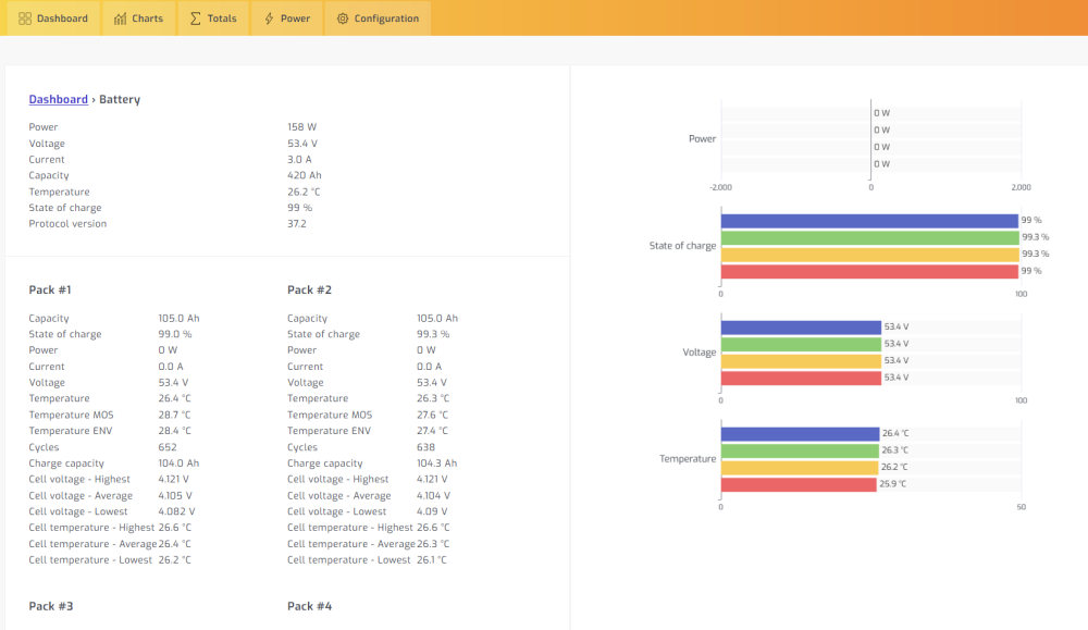

system32 Posted August 25, 2022 Share Posted August 25, 2022 (edited) FYI: Good News, Solar-Assistant Software version 2022-08-25 is now reporting the correct temperature from Hubble-AM2 batteries: https://solar-assistant.io/help/updates/changelog 2022-08-25Beta New features: Add WiFi country code selection to network configuration. Upgrade of underlying frameworks and libraries. Basic support for EASUN SMG II and PowMr inverters that use with RS232 WiFi dongle and SmartESS app. Select inverter type "Sumry". Support for most important setting of Must and SRNE inverters. Support for adjusting more Deye and Voltronic settings via MQTT. Corrections: Correct temperature reading of USB serial protocol. Edited August 25, 2022 by system32 Quote Link to comment Share on other sites More sharing options...
shovelhead Posted March 2, 2023 Share Posted March 2, 2023 Picking up on this old thread, I do not see all the values as above but very limited battery dashboard with solar assistant? Only capacity, SOC, power, current, voltage and temperature. Quote Link to comment Share on other sites More sharing options...

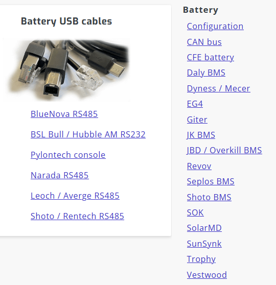

system32 Posted March 2, 2023 Share Posted March 2, 2023 (edited) 3 hours ago, shovelhead said: Picking up on this old thread, I do not see all the values as above but very limited battery dashboard with solar assistant? Only capacity, SOC, power, current, voltage and temperature. Do you have a cable connecting SA to your battery? You required a cable to connect so SA can read the detailed data from the battery. solar-assistant.io shop: Edit1: would be nice for SA to provide cell voltages Edit2: Not all information is available on all batteries. Edited March 2, 2023 by system32 Quote Link to comment Share on other sites More sharing options...

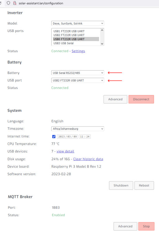

shovelhead Posted March 9, 2023 Share Posted March 9, 2023 Thanks for this @system32. I ordered the cable and have it plugged in but still don't see anything. Is a config change required in solar assistant? Quote Link to comment Share on other sites More sharing options...
MdF Posted March 9, 2023 Share Posted March 9, 2023 45 minutes ago, shovelhead said: Thanks for this @system32. I ordered the cable and have it plugged in but still don't see anything. Is a config change required in solar assistant? Is your battery listed in the supported batteries in SA when you do the setup? If not, then you will only get the limited data that is read by the inverter. I too am in the same position with the brand of batteries I purchased. One thing I will definitely have a look at in the future when it comes time to replace them, is are they supported by something like SA as the extra data is very usefull especially when it comes to monitoring things like cycles and cell performance. MdF Quote Link to comment Share on other sites More sharing options...
system32 Posted March 9, 2023 Share Posted March 9, 2023 (edited) 52 minutes ago, shovelhead said: Thanks for this @system32. I ordered the cable and have it plugged in but still don't see anything. Is a config change required in solar assistant? See https://solar-assistant.io/help/battery/configuration The below is for Hubble-AM2 connected via RS232 console port: Solar-Assistant->Configuration->Battery Edited March 9, 2023 by system32 Quote Link to comment Share on other sites More sharing options...
shovelhead Posted March 9, 2023 Share Posted March 9, 2023 I can see the second USB port, but can't select it, and the battery setting only has "use inverter values" ? Tried rebooting Pin also but hasn't changed...? Quote Link to comment Share on other sites More sharing options...
system32 Posted March 9, 2023 Share Posted March 9, 2023 (edited) 8 minutes ago, shovelhead said: I can see the second USB port, but can't select it, and the battery setting only has "use inverter values" ? Tried rebooting Pin also but hasn't changed...? Click Disconnect first. Change the USB settings Click Save Click Connect when done. Edited March 9, 2023 by system32 shovelhead 1 Quote Link to comment Share on other sites More sharing options...
abd7 Posted March 9, 2023 Share Posted March 9, 2023 You have to press disconnect first, then choose it shovelhead 1 Quote Link to comment Share on other sites More sharing options...
