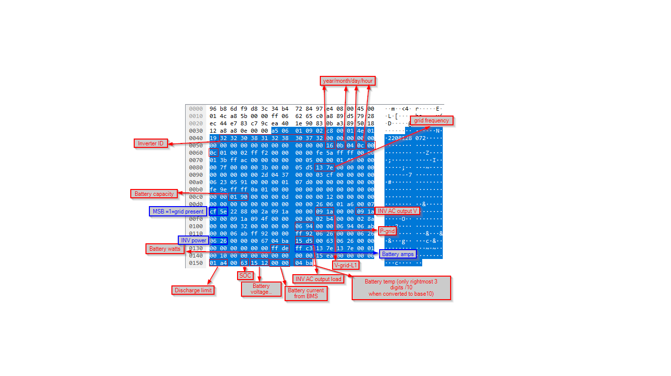

Hi all, don't know if this thread is still alive but here is what I have deciphered so far, in the 292 bytes payload of the dongle. If anyone else can maybe confirm that this corresponds to their inverter data as well, I have the SUNSYNK-5K-SG01LP1
@PLCguyit's a bit tricky to read the offsets from that view since they don't start at zero, so at a glance I'm not able to say if it all lines up, but it seems promising! I've pushed my work-in-progress to Github, and you can see the fields I've decoded here. I'll take a look this weekend to see if they match yours and add any you have that I'm missing (I don't think I have any of the static fields like discharge limit). Note that some fields seem to be duplicated so for example I've noted battery temperature in a different place to you.
Neat! Nice work!

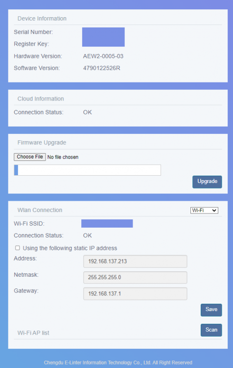

I have also checked and it's only port 80 open on the unit, the web server is mongoose6.7 but don't know if there are any exploits to try and get root on the unit. cgi-scripts that can be executed on the unit are, and there are others:
http://<device-ip>/config?command=status
http://<device-ip>/config?command=devinfo

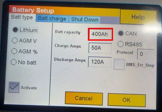

For what you identified as battery capacity: is that in Ah? That does seem to fit with my battery.

On 2022/11/04 at 10:00 PM, PLCguy said:
bytes 42/42 (from 0) is also some form of a counter that increments every 4 or 5 transmits, this is not consistent, but it keeps increasing (this may be a totalizing value), will confirm.
Bytes 41 and 42 are always in the range 0-59 so I'm fairly sure they're the minute and second of the timestamp.
Bytes 0 - 10 -> payload header
Byte 2 = A1 when packet from server, = 01 when packet from wifi dongle
Bytes 9-10 -> Actual data byte count from byte 11
Byte 11-20 -> Inverter ID
Byte 37 -> Year
Byte 38 -> Month
Byte 39 -> Day
Byte 40 -> Hour
Byte 41 -> Minute
Byte 66-67 -> Daily battery charge totalizer (resets to zero @ 00:00) | kWh = raw value / 10
Byte 68-69 -> Daily battery discharge totalizer (resets to zero @ 00:00) | kWh = raw value / 10
Byte 74-75 -> Total battery discharge since beginning of time | kWh = raw value / 10
Byte 82-83 -> Total grid import since beginning of time | kWh = raw value / 10
Byte 84-85 -> Grid instantaneous frequency | Hz = raw value / 100
Byte 96-97 -> Load usage totalizer since beginning of time | kWh = raw value / 10
Byte 140-141 -> Battery capacity (Battery setup screen parameter) | Ah = raw value
Byte 182-183 -> V-grid-L1 | V = raw value / 10
Byte 186-187 -> Inverter AC output
Byte 190-191 -> Unidentified voltage
Byte 192-193 -> Unidentified voltage
Byte 212-213 -> Grid power (Instantaneous) | watt = raw value
Byte 216-217 -> Unidentified power
Byte 218-219 -> Unidentified power
Byte 220-221 -> Inverter power
Byte 228-229 -> Inverter load output | watt = raw value / 10
Byte 242-243 -> Battery watts (instantaneous)
Byte 244-245 -> Battery current (instantaneous)
Byte 246-247 -> Unidentified frequency
Byte 248-249 -> Unidentified frequency
Byte 280-281 -> Battery capacity (0 when grid present, capacity value when grid off)
Byte 282-283 -> Discharge limit
Byte 285 -> SOC (State of charge) | % = raw value
Byte 286-287 -> Battery voltage from BMS
Byte 288-289 -> Battery current from BMS
Byte 290-291 -> Real time battery temperature (range -99.9 degrees to +99.9 degrees scaled between 0x01 AND 0x7CF, where 0 degrees = 0x3E8
