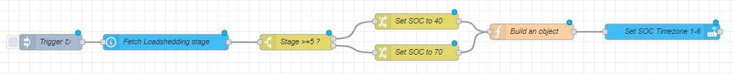

Been Working on this further : Converter into fewer enteties , but with a ton of attributes. Makes it easier to use in templates and dashboard
Top half gathers all the info
Bottom Half is all to do with automation and notification.
Algorithm for forcing charge before load shedding is now getting pretty complex. Also takes into account of how much time is needed to charge up to a predefined soc level depending on how long load shedding is anticipated to last for
Edited by Gary Waterworth

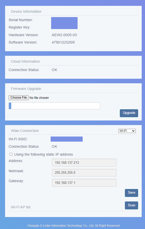

On 2022/11/04 at 8:32 PM, PLCguy said:
I guess it's the branded one as it has "Sunsynk" printed on it, but it also does have the red and green LED's. The same one posted earlier by @valienté with the picture. Below is the UI served from it.
I have also checked and it's only port 80 open on the unit, the web server is mongoose6.7 but don't know if there are any exploits to try and get root on the unit. cgi-scripts that can be executed on the unit are, and there are others:
http://<device-ip>/config?command=status
http://<device-ip>/config?command=devinfo
but the interesting one is this:
just going to keep digging...
@PLCguy Did you get any of the other queries that return data from the interface.
I lost thwe link from here and am not sure if you followed up on this.
Would be keen to see what else can be retrived this way please.
I have an ESP32 integration with the Inverter to pull the data into HA sensors, and I'm trying to update the SOC depending on what stage loadshedding is going on: this is the idea:
I can manually slide these sensors in HA, which updates the Inverter settings (number.set_soc_timezone1)
What I'm struggling with is to understand the configuration of the call service node. Any ideas?
Hi @Gooseza
Great minds think alike 🙂 , I have been working on doing this exact same thing but using an automation in Home assistant rather than NodeRed.
Am trying to put together a video of it as I think it will be useful to a lot of people and will have it out as soon as I work out the all the wrinkles (have lots at the moment)
Would also like to switch the Load/Battery Priority based on the Solar Forecast from Solcast for the day to ensure that the battery gets charged to the required level to make it through load shedding without charging the battery from the grid.
Have been thinking that is may be easier to just create an entity to switch between custom settings for different levels of load shedding (not sure, comments anyone?) .

It's exactly these entity values I'm trying to change via node red, but I just don't know what settings must go in the callservice node to change them.

If you have an ESP32 you should already be able to do it, what code are you using on the ESP32, I am using the code from @slipx 's dash https://github.com/slipx06/Sunsynk-Home-Assistant-Dash  and it works out the box.
Yes, I'm using Slipx integration, but his solution does not use Node Red. Sure, I can slide the sliders in HA manually, but I want an automation via NodeRed to do that depending on the level of loadshedding.
I am working on a Home Assistant automation to do the automatic adjustment of battery settings based on the load shedding levels as well as the solar forecast for the next day.
Will post a video when I have it all worked out 🙂
Pretty sure I can get it done without having to go to Node Red.
