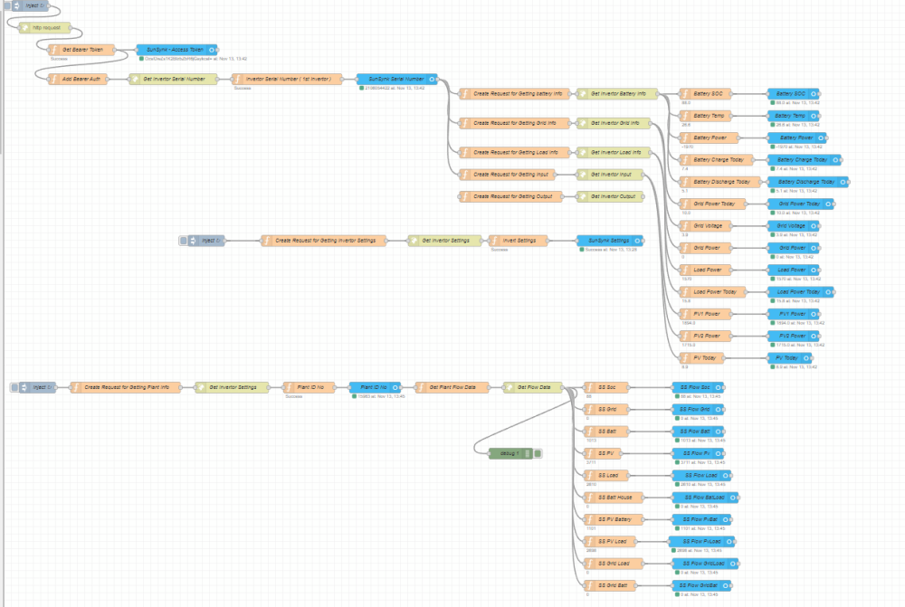

I have been putting together some flows in Home Assistant NodeRed to query the SunSynk API on the website directly.
Been working on endpoints. Looks like I have access to all readings and Inverter settings now.
I have only pulled out some of them into sensors so I can use them in HA.
Still need to make/find some nice cards.
Busy looking at how to set some settings. Basic process is there, just need to make sure it all works :)

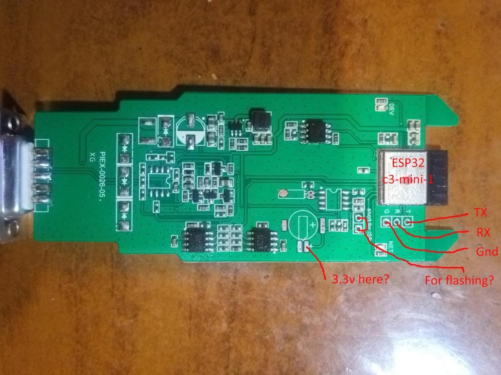

  • Have a look at the card I created for HA. I'm sure you can pull all the necessary sensor data through the API.   This is what my dashboard currently looks like
  • Is an ESP32 MCU, would be cool to reflash with ESPhome and pull all the data from the inverter that way.
  • To confirm do you want to pull the firmware from the nodemcu, or just utilise their API?   It might be easier to just write some HA integration which directly talks to the SunSynk cloud APIs

Useful Endpoints and Information.
My flows are being changed daily atm with error checking and optimisation. When I have things more stable I will post an export.
I must admit I love NodeRed integration in Home Assistant. Makes things like this easy to do with minimal outside components required.
General Function Code I use to pass into the web request :
I save the access token and inverter serial number into 2 sensors beforehand so they can be reused

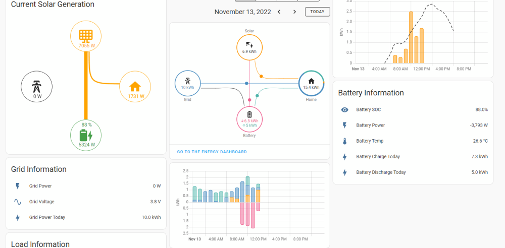

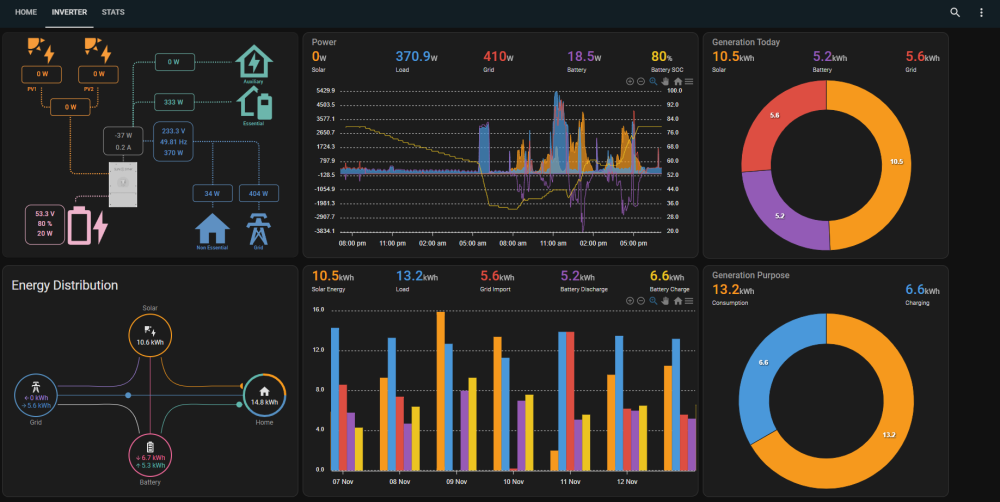

Just a sample view I am working on in the HA dashboard
Current Solar Generation ( Tesla Power Card )
Summary Solar Generation ( HA Energy Management )
Solar Gen Graphs and Predication
Stacked Graph of Summary ( Apexcharts )
Was during loadshedding and rain/cloudy ( grid V was 3.8v lol ) . So Numbers are all over the place
Need to just look at the numbers in defferent scenarios for the tesla card and make sure the calculation logic is correct
Edited by Gary Waterworth

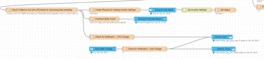

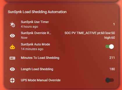

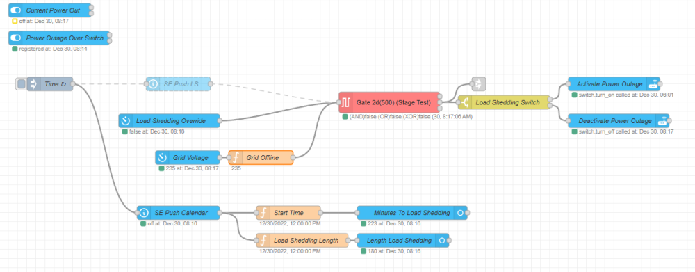

Done some more work on this
I have a situation where I like to cycle the batteries down to 20% to 30% of soc every night to save on importing eskom.
But then I sometimes have a situation where if I have loadshedding early and it is cloudy etc then I have to skimp.
Theory is that if I can calculate when load shedding is coming up ( using Eskom SE ) I can then turn off the "use timer" and basically leave it on ups until I am at a certain soc, based on a few other params as well .
I have managed to figure out how to set this with the sunsynk website api.
Going to be testing this logic for a while and then may need to tweak a bit
// run every 15 min
// 1. If time left till LOS < 180 Mins
// 2. If SOC < 60%
// 3. If PV being generated < 4000
// 4. If Use Timer = 1 <- Enabled
// Set Use Timer = 0 <- Disabled
// Otherwise
// If Use Time = 0 <- Disabled
// Set Use Timer = 1 <- Enable
// Otherwise stop message flow

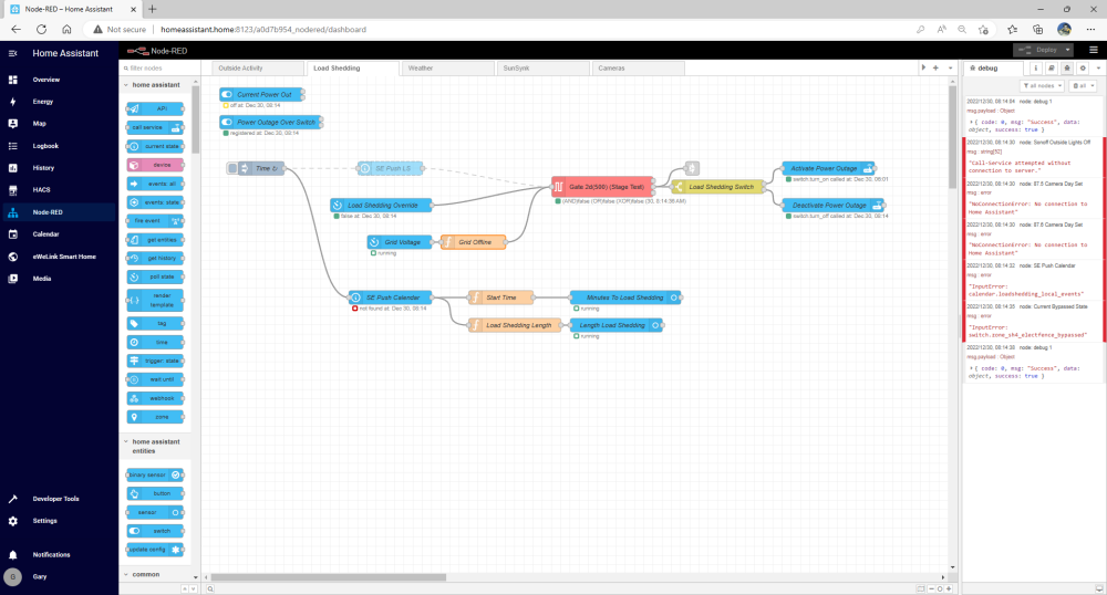

And the flow for the Eskom SE Calendar Calcs

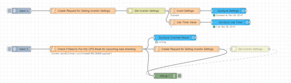

On 2022/12/06 at 2:49 PM, Gary Waterworth said:
Hi Gary, Did you get anywhere writing settings to the inverter? I've managed to recreate what you have done in Node-Red and can read all of the values. I would like to control state of charge added overnight based on an estimate of solar generation. However, I can't see anything in the API documentation suggesting this can be set? Thanks.
Hey Ian
Yes, I have actually been testing something for that, but I went with a different approach
I basically enable and disable the "Use Timer" on whether I want to force charge batteries up to a certain value when load shedding is coming up. The duration of time before and soc levels I want are based on the duration of load shedding expected.
None of this is in the documentation. I have been emulating what the app does, which is also different to the api docs on the reading of values. AT some stage I need to figure out the signing requirements for the openapi and move most of mine to the openapi instead of what I am doing now.
You can set any values that are available in the app. If you want I will extract the raw list of variable names for you.
Currently the way I set my system up is :
var soclow = 50;
var sochigh = 60;
var pt = 60;
if (lls > 180) { pt = 120; soclow = 60; sochigh = 80 }
if (lls > 240) { pt = 180; soclow = 80; sochigh = 95 }
if (lls > 300) { pt = 240; soclow = 95; sochigh = 98 }
So if expected Load Shedding Length is
<= 180mins , then start charging 60 mins in advance starting at 50% and stop charging at 60%
180.01 mins > 240mins , then start charging 120 mins in advance starting at 60% and stop charging at 80%
240.01 mins > 300mins , then start charging 180 mins in advance starting at 80% and stop charging at 95%
300.01 mins > infin , then start charging 240 mins in advance starting at 95% and stop charging at 98%
I am busy testnig and refining these, but they will be individual based on your size and usage of your system
Function Code for the actual check, outputs a 1 or 0 that is used to enable/disable the User Timer.
I know the code is still a bit klunky and also has a number of checks because I am paranoid
There is also functionality for a override switch to force the USE TIMER mode as well a switch to enable/disable use of the logic.

Code for creating the request to enable/disable the USE TIMER
notes :
bearer is the bearer access code
sn is the unit serial number
peakAndVallery is the variable sent to sunsynk to enable disable the USE TIMER function
var states = global.get('homeassistant.homeAssistant.states');
var bearer = states["sensor.sunsynk_access_token"];
var sn = states["sensor.sunsynk_serial_number"];
var timeruse = states["sensor.sunsynk_use_timer"];
if (timeruse.state != undefined) { } else { node.status("Undef");return null }
if (bearer.state != undefined) { } else { node.status("Undef");return null }
if (sn.state != undefined) { } else { node.status("Undef");return null }
if (parseInt(timeruse.state) === parseInt(msg.payload)) { node.status("No Action") ; return null } else {}
msg.headers = {
    Authorization: "Bearer " + bearer.state,
    "Content-Type": "application/json",
    "User-Agent": "Mozilla/5.0 (Windows NT 10.0; Win64; x64) AppleWebKit/537.36 (KHTML, like Gecko) Chrome/103.0.0.0 Safari/537.36",
    "Connection": "keep-alive",
    "Accept": "*/*",
    "Cache-Control": "no-cache",
    "Origin": "https://sunsynk.net",
    "Referrer": "https://sunsynk.net"
msg.url = "https://pv.inteless.com/api/v1/common/setting/" + sn.state + "/set";
//msg.payload = "{sn:xxxx,"safetyType":"2","battMode":"-1","solarSell":"0","pvMaxLimit":"8000","energyMode":"1","peakAndVallery":"0","sysWorkMode":"1","sellTime1":"00:00","sellTime2":"04:00","sellTime3":"09:00","sellTime4":"15:00","sellTime5":"22:00","sellTime6":"23:00","sellTime1Pac":"8000","sellTime2Pac":"8000","sellTime3Pac":"8000","sellTime4Pac":"8000","sellTime5Pac":"8000","sellTime6Pac":"8000","cap1":"50","cap2":"40","cap3":"30","cap4":"90","cap5":"70","cap6":"60","sellTime1Volt":"49","sellTime2Volt":"49","sellTime3Volt":"49","sellTime4Volt":"49","sellTime5Volt":"49","sellTime6Volt":"49","zeroExportPower":"20","solarMaxSellPower":"9000","mondayOn":true,"tuesdayOn":true,"wednesdayOn":true,"thursdayOn":true,"fridayOn":true,"saturdayOn":true,"sundayOn":true,"time1on":true,"time2on":true,"time3on":true,"time4on":true,"time5on":true,"time6on":true,"genTime1on":true,"genTime2on":true,"genTime3on":true,"genTime4on":true,"genTime5on":true,"genTime6on":true}"
msg.payload = { "sn": sn.state , "peakAndVallery": msg.payload }
node.status("Action Sent");
return msg;
I Use the Eskom SE Push integration to calculate the next load shedding time and length of it
MINS TO NEXT LOADSHEDDING
var origmsg = msg.payload;
if (origmsg.start_time != undefined) {
    var startdate = new Date(origmsg.start_time);
    var start = startdate.getTime();
    var currentdate = new Date();
    var current = currentdate.getTime();
    var diff = start - current;
    msg.payload = parseInt((diff / 1000 / 60).toFixed(1));
    node.status(startdate.toLocaleString());
    if ( msg.payload <= 0 ) { msg.payload = 99999 } else { }
    if ( origmsg.state === "on" ) { msg.payload = 99998 } else { }
} else {
    msg.payload = 99997;
    node.status("No Events");
return msg;
// Error States
// 99997 - No new event
// 99998 - Current Event Running
// 99999 - Start time has passed
LENGTH OF LOADSHEDDING IN MINS
msg.payload = 0;
if ((origmsg.start_time != undefined) && (origmsg.end_time != undefined)) {
    var enddate = new Date(origmsg.end_time);
    var end = enddate.getTime();
    var diff = end - start;
    if ( diff <= 0 ) { diff = 1 }
    // add 60 min due to se being 2 hours instead of 3 hours
    msg.payload = msg.payload + 60;
} else {
    return null;
return msg;

Back to the original topic of hacking the dongle itself, I have interposed a pair of rs232 dongles back to back, and used “socat -x /dev/ttyUSB0,b9600,rawer,nonblock /dev/ttyUSB1,b9600,rawer,nonblock” to dump the traffic in either direction. I did also have to inject 12V on the RI pin feeding the dongle, in order to provide sufficient power to actually run it. Quite clever actually, as any RS232 interface would have to be 12V tolerant on all pins.
The data transferred certainly does look like simple modbus traffic as suggested in an earlier post, so flashing it with esphome and using either the streamserver integration or the modbus integration is definitely an option. And yes, I understand that altering the firmware of the dongle will prevent it from updating the firmware of the inverter itself. One could either keep a copy of the original firmware handy to flash back onto the dongle if needed, or look into reimplementing the protocol between the website and the dongle. Not too sure how worthwhile (or future proof) that would be.
It also looks like connecting to this port could be a really easy alternative to the rs485 adapters that many folks are using (but sometimes struggle to get working). I’ll test in a bit whether the kellerza Sunsynk integration “just works” if I point mbusd to the rs232 adapter instead of the rs485 one, or if it needs some additional configuration and tweaking. That could also be a solution for folks that have multiple inverters in parallel, but that all want to be masters on the RS485 bus.
I guess I also probably want to get the dev container running, and a fake mqtt server or similar to avoid polluting my hass installation with extra entities!
This post was recognized by Energy-Jason!
RoganDawes was awarded the badge 'Great Support' and 50 points.
Yup, confirmed that you can simply use mbusd and query the exact same registers via RS232 that you can via RS485.
/usr/bin/mbusd -d -L - -P 503 -v 2 -C 32 -T 0 -p /dev/ttyUSB1 -s 9600 -m 8n1 -N 3 -W 500
Just realised that it might be possible to run the firmware in the Wokwi ESP32 emulator (or other RISC-V ESP32 emulator, I guess), pointing it to mbusd which can multiplex/share access between multiple clients.
This sounds pretty cool @RoganDawes. I've been thinking about going the RS485 route, but didn't really want to spend money on hardware for it when my current solution is working well enough. If reprogramming the original dongle will work that would be awesome.
I'm a software guy so I have no idea how one would go about flashing the dongle. What tools would one need?
You just need a USB-UART dongle, just make sure that it is 3.3v, not 5V. And a few jumper wires, probably, just to do the hook up from the dongle to the UART.
Basically, the ESP32 has a serial boot loader that you can invoke and interact with by pulling a pin low at power on. Usually, that is done automatically by the USB-UART if all the lines are connected for you, but the bare minimum is GND, RX, TX to the UART, voltage supplied to the ESP32 *somehow*, and some way to ground GPIO0. That can be as simple as pressing a jumper wire against a pin while applying power, doesn't have to be sophisticated.
