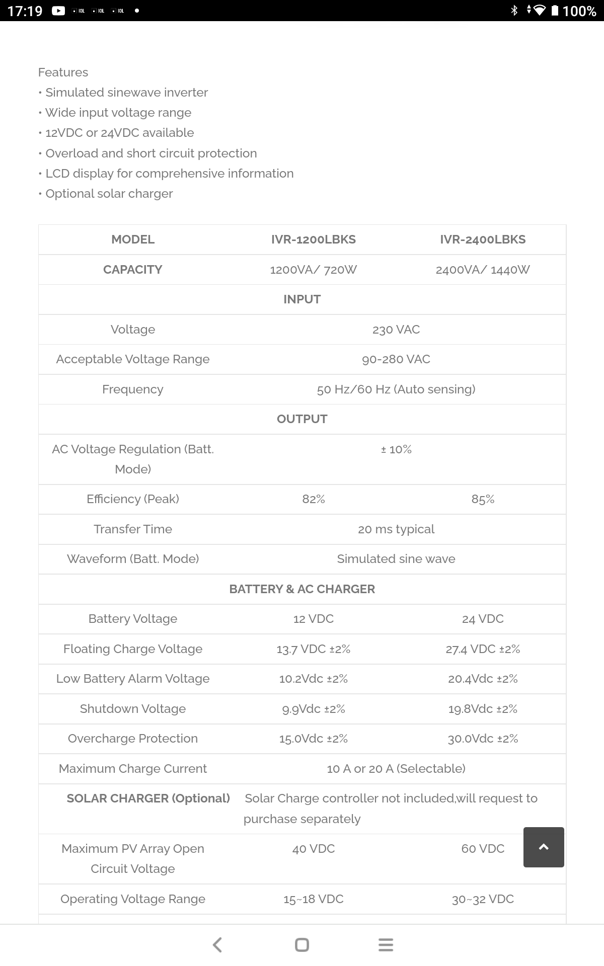

Do you know if the charge and low battery cutoff settings is adjustable on this inverter. The default settings of this inverter will not be OK for Pylontech batteries. I also want to know but can't see in the manual if the settings is adjustable.
Just make shure that the charger can handle a lithium battery - I dont think the BBONE can . Your alternative is probably the Blue Nova drop in 12 V batteries . But if something goes wrong then they going to ask how you charged them. Time probably to invest in a better inverter .
On the BBONE i would just replace it with Lead acid again - or sell the BBone and upgrade .
The charging side seems to be fine on the BBONE inverter. It is really the low cut off that presents problems on lithium.  Just add a Victron battery protector to cut off the battery at the 23.6 or 24V level and you fine. Cost is about R800.
