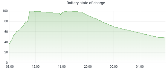

its not close to 15 per day. here are my battery usage stats:
Those stats will definitely be at least 2 cycles per day.
My Hubble has been in use since last year in Aug and I am now at 344 cycles, i.e. 21 cycles away from 365 which gets me to 6 days short of one calendar year usage as I had 6 instances of exceeding the battery capacity in one day within this year.
So I can only state that in my case the cycle count has been pretty accurate. These are the last couple of days
First day looks like 1 cycle and the rest like 2 probably if it was counting reasonably .Do you know which days counted 3 cycles ?
I don't know. I will keep note of them in the future

I don't disagree with you. From my observations, any SOC below 50% before recharge seems to log 1 cycle and it seems as soon as 20% SOC is reached and a 80% recharge is required then it counts the second cycle. I am not defending Hubble on the cycle counts, but I have a sneaky suspicion that a certain elapsed time between the last charge cycle and the next charge actually triggers a cycle too. No, I have no proof, only my observations.
My battery is normally between 30 and 40% SOC in the morning but I have had days where it was 50+% in the morning and as soon as the first solar charge starts, the cycle count increases by 1. So without knowing their programmed logic, we can only guess what parameters they apply to do the count.
Up to now I have been satisfied as I had no reported loss of capacity, but my cycles increase by 1, no matter what the SOC in the morning. Having said that, I have never been able to test it with lets say 80 or 90% SOC as my system is off-grid. Nothing but solar.
