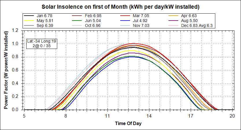

The tables at the top of the graphs below show PV yields (kWh per day per kW installed) for a North facing installation, and one that is a combination of East/West.  Roof angle is assumed at 35 degrees.
What you can see is that the East/West combination is slightly better in January (7.1kWh/day vs 6.8kWh/day, and a flatter distribution) but July is a disaster: 2.5kWh/day for East/West vs 4.9 for North.  Average for the year is about 28% better for North facing panels.
The effect will vary with roof angle (steeper is worse) and latitude: further from the equator is worse.  I can run the graphs for your location / roof angle if you send me the details.
North facing:
East/West facing:

For many (most?) people the system design is driven by winter demands.  The problem with the East/West configuration is winter - it never produces more power than North facing panels and only half in total.  Look at the curves for July.
Also, 50% less in winter, 28% less annual production stretches my understanding of "slightly lower peak production" 🙄
