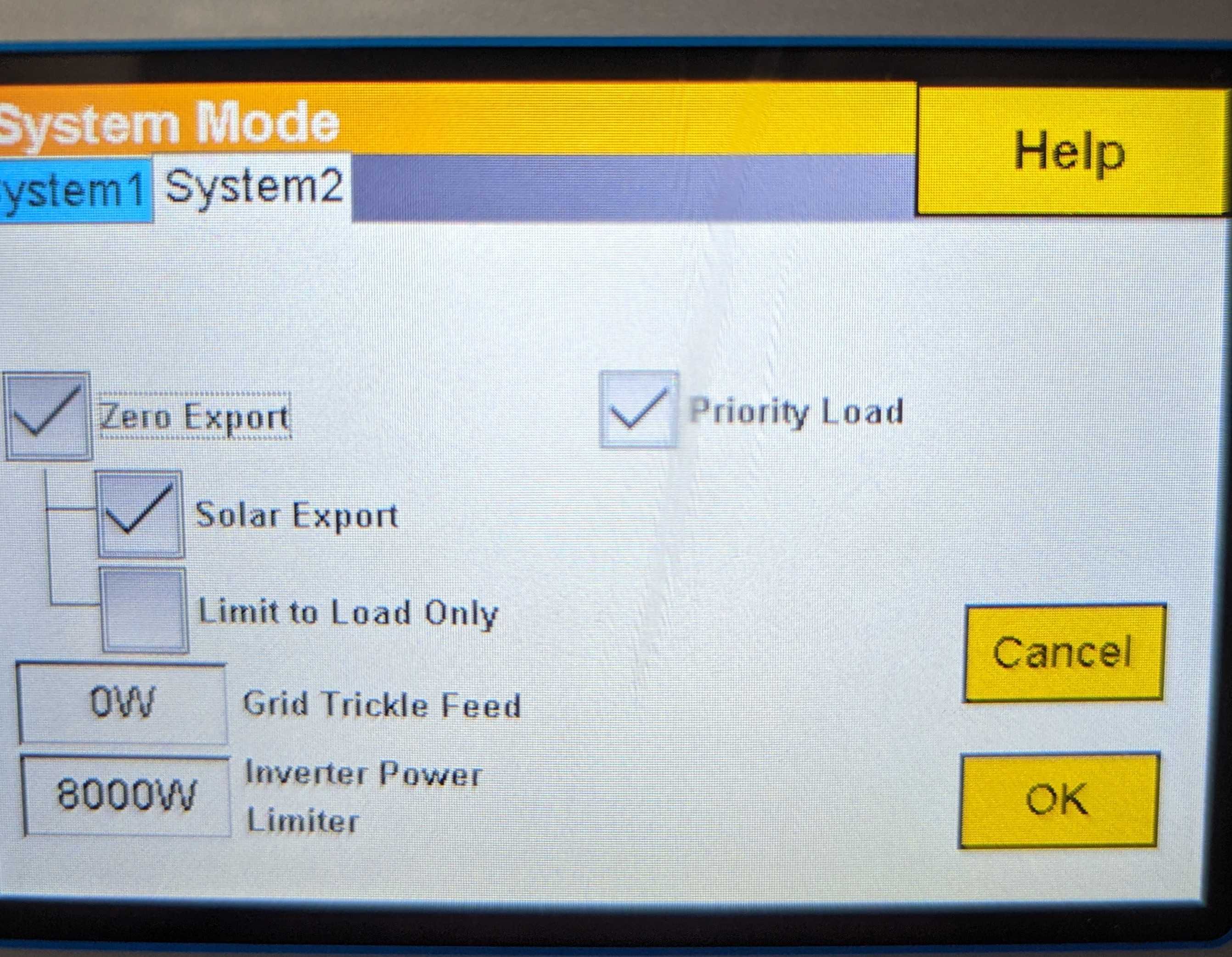

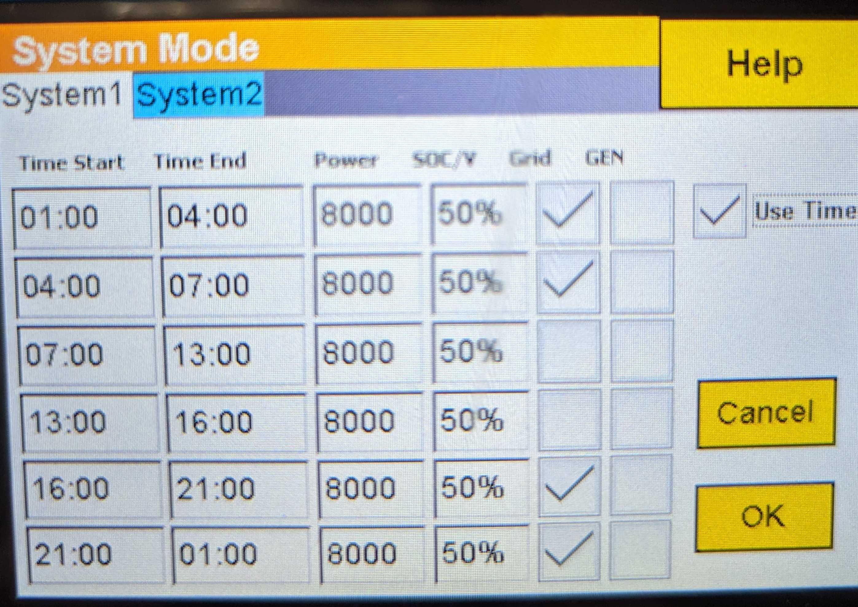

Hi, the CT is critical and must be installed correctly. Untick solar export and set "Grid Trickle Feed" to 20W. This prevents exporting. If you are going to use the Aux later, set up for Aux and untick "On grid always on". This setting allows one to use the grid through the Aux when solar power is low.
The way the table is set up the battery SOC will never go below 50%. The way I have set up and tested my table is the grid supplies whenever the battery is below the SOC values I have set.

I checked the CT and it looks correct. It did measure input from the grid correctly, before the solar panels were added. I'll see if I can force the system to draw current from the grid to test the CT.
How do I get the system to export to the grid if there is excess solar? I thought that was what the "Solar Export" check box was for. I don't have  a prepaid meter.

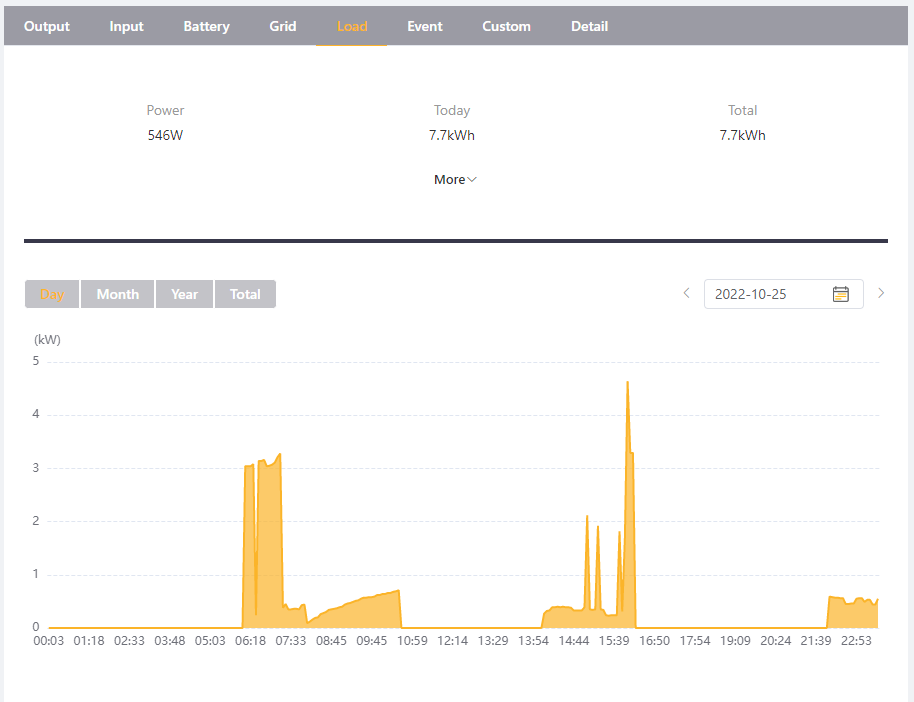

I have a similar problem. Installed yesterday and load and grid only shows values when there is load shedding... 3 times already today...
Load only shows during the load shedding times and battery charging in the morning
  •  0600Hrs -0800Hrs
  • 1400Hrs - 1600Hrs
  • 2200Hrs likely to 0000Hrs.
  •  0600Hrs -0800Hrs
  • 1400Hrs - 1600Hrs
did you ever solve your problem?
I'm having a 8Kw doing exactly that occasionally, it displays no consumption when utility is up, on load shedding the load displays.
It's like its bypassing the inverter without reading even grid load yet there is...
I suspect the relays internally might be sticking
