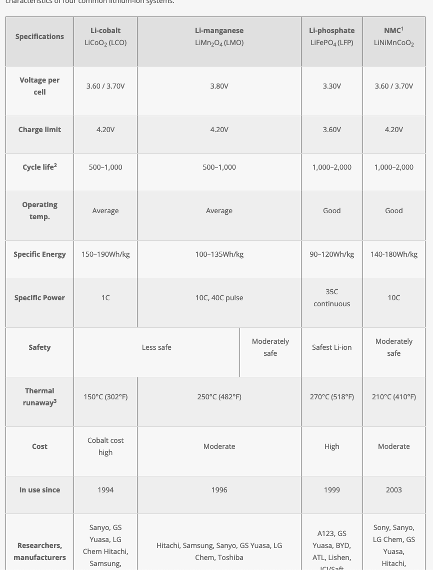

the maximum Voltage per cell is 3.6V and not worth aiming for, since you will shorten the expected life of your cells... and at 60V bulk which is 3.75V per cell, assumption still is a 16S battery, you are exceeding the individual cells max Voltage by 150mV and this will guaranteed hurt them...
See attached screenshot from batteryuniversity.com, note the Li-phosphate charge limit of 3.6V...
