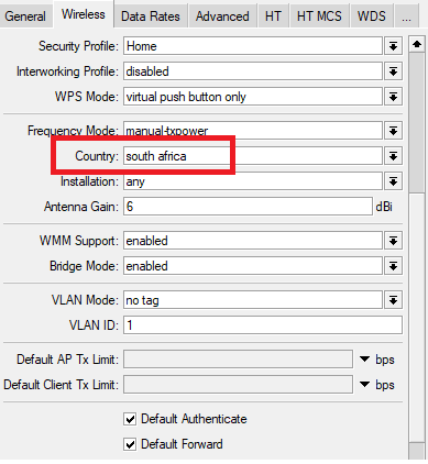

I have a mikrotik and have to disable some of teh security mechanism's for a lot of iot devices to work as a lot of them do not handle the auto negotiation very well.
EAP should never be enabled in home networks at it is very unlikely you will have enterprise style auth options available.
WPA is older and more widely supported.
Also sometimes offering both aes ccm and tkip also causes negotiation problems.
The other things to also check is to make sure your access point is setup to a country specific standard. If you set to ALL channels, so clients that will only talk on legal channels will not connect as the channel that the ap listening on is outside the range
Last thing to make sure is that cts/rts is enabled, esp on the 2.4 band as there can be a lot of interferance. Cts/RTS will help a ton.
