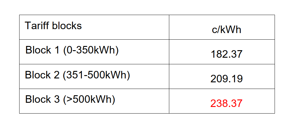

Because it is a stepped rate and I use very little power over summer and more over winter. I but the maximum amount without going buying power at the higher rate and stock up a bit over summer so I don't have to buy at the higher rate over winter. Almost 30c extra per kw/hr when you go from level 2 - level 3 so if you are using more than 500kw/hr a month in winter but less in summer makes sense to stock up.

Nersa controls the R/kWh that CoJ can charge.
Nersa does not regulate the service & capacity charges:
This allows CoJ to charge very high service & capacity charges (relative to other metros).
R825.60 per month on post paid just to be connected 🤬

Yes this is fake as correct. Each munic do set their price. Just look at Ekurhuleni giving 100kWh for free on a specific tariff plan. Tshwane do not offer it and I doubt COJ give it. Then the actual rate and even the blocks and each blocks price is not the same. Easy to confirm by looking at each metro's website.
Just looking at the graph from system32. The 1st 100 units for CoJ is R2.10 a unit. Tshwane is R2.41 for the same block.

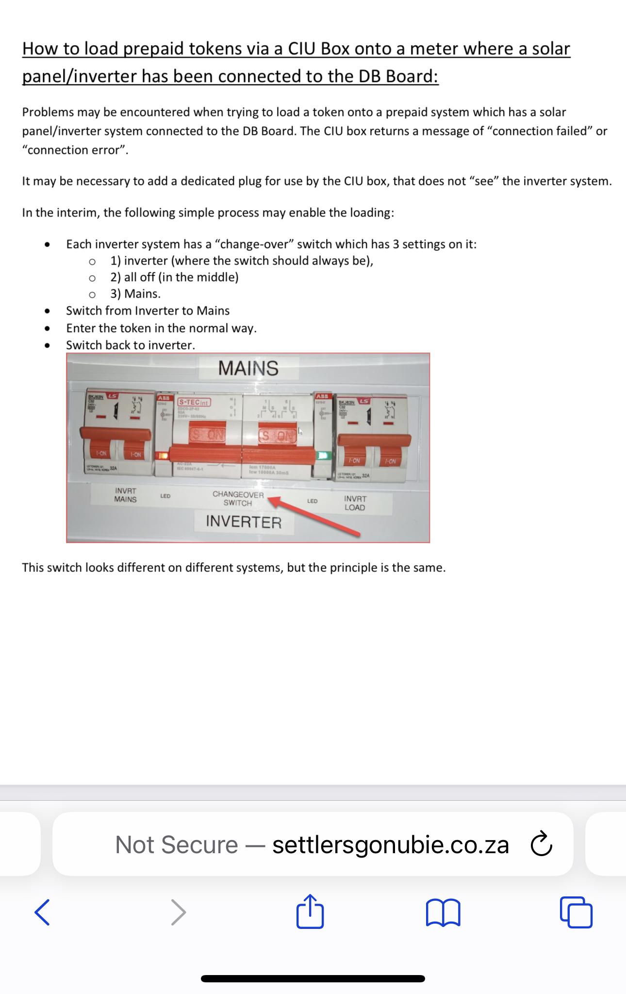

Got my ciu-ph04 yesterday and is now activated. I battled to load vouchers just to find out my meter wasn’t registered correctly. That is now sorted. The actual CIU is installed in my garage which means every time I need to recharge I will need to go into my garage and input the voucher. I moved the device into my house but it couldn’t connect to the main board outside, According to the coj contractor I need to move the CIU onto my DB board as apparently it doesn’t play nicely with inverters. So have to get my electrician out to move it. Based on the attached it seems to be true….not sure if anyone has had similar experiences.
So this workaround with the inverter doesn’t work…going to get my electrician to connect it to the DB board my worry is now I have run out of electricity and I’m hoping it doesn’t give me issues when trying to recharge
So this workaround with the inverter doesn’t work…going to get my electrician to connect it to the DB board my worry is now I have run out of electricity and I’m hoping it doesn’t give me issues when trying to recharge, tried at my neighbors and that also didn’t work
Got it working and connected to my DB board. Funny story, using one of the banking apps to recharge it SMS’s you a number of ‘vouchers’ those vouchers aren’t actual vouchers you need to go back into the mobile app to check the voucher number. I now have R700 worth of prepaid electricity…let’s see how long that last with it charging my batteries🤦🏼‍♂️
Hi I had the same meter installed. I had a plug installed before the inverter so there are no communication issues with the meter.
When purchasing using the FNB app the sms contains the voucher number.
