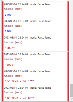

Hi @Gary Waterworth I've had a look and I don't see the DC and AC Temps anywhere so I'm guessing those aren't included in the sensors that or I'm blind, which is also possible.
If you are planning on any updates in the future could I make a suggestion for those to be included if at all possible.  Would be nice if one could to be able to keep an eye on it via HA as I want to try and integrate a fan or cooling solution on my inverter based on the Temps as my garage do get a bit toasty in the summer.  According to the installer I need not worry but hitting 80 C on the DC temp just feels a tad bit high.
If not there is the old school solution of just slapping a fan with temp probe on there 😅
Edited by -cK-
This was actually on the back of my mind a few days ago.
I have yet to find a place where it gives it as a number 😕 as a point in time.
I have found the web query where it asks for the data for that graph, so worst case I can allways get the last figure from there. This is just not the type of query you want to run every few seconds.
It is a really fugly way to get the data though
Definately Doable tho :
Will work on this tomorrow
Edited by Gary Waterworth
AC/DC Temp Data.
Added a sensor : sensor.sunsynk_temp_data
in it there are 2 attributes added : actemp and dctemp
Will update every 3 minutes.
Kept all the graph data in there as well. Going to see what I can do with apex graphs

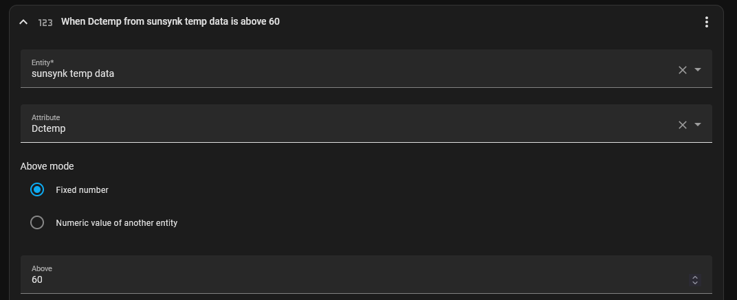

Much obliged @Gary Waterworth
The apex card is working.
Did a quick test with a simple Warning Message Automation and it does the job just as required.  Now I should be able to do fan mod on the inverter with a smart switch and a fan hooked up to it to kick in with something like this 👍

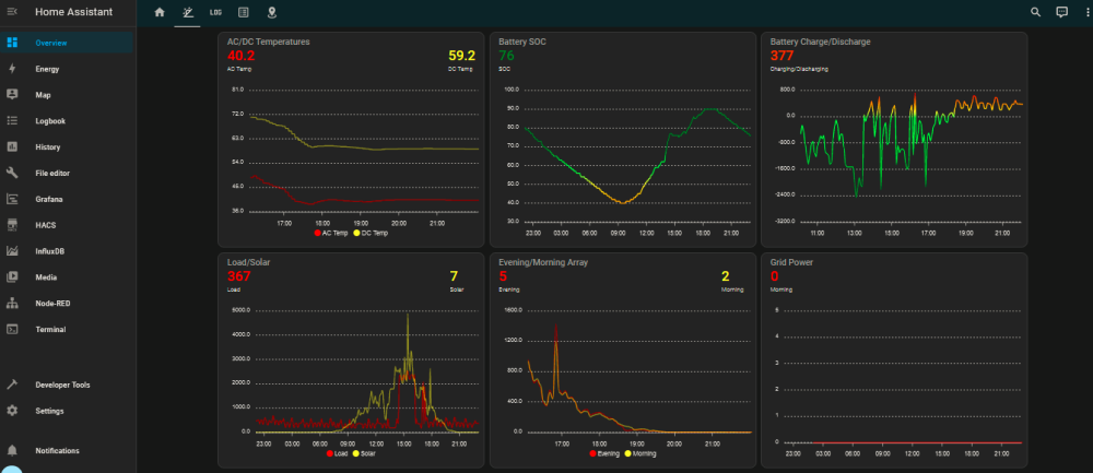

This is the route I went using apexcharts and mushroom
Fantastic. Can you export this? It is basically everything I am looking to achieve, only auto mode for me will be use timer or grid charge now.

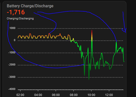

A bit off the topic but do you perhaps know if one can match the top readout of the value to match the colour of the thresholds you have set when using
experimental:
  color_threshold: true
E.G. in my charging/discharging card it would be nice if I coud have that top value match the current graph colour so if charging the reading is lime or green and when discharging it is = to whatever the current mix of yellow orange red I have set is.
Hope that makes scense currently it is set to a fix colour as per from the source of another graph I used to make this.  Should probably go check in that repository where I saw this graph style but thought I'd ask if not no prob.

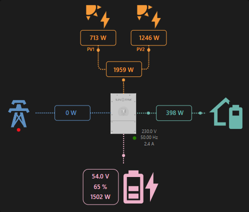

3 hours ago, slipx said:
@-cK- you can find the latest power flow card here https://github.com/slipx06/Sunsynk-Home-Assistant-Power-Flow-Card
I've added some animations and other improvements.
If you want some Dashboard ideas https://github.com/slipx06/Sunsynk-Home-Assistant-Dash

On 2023/03/18 at 5:55 AM, Gary Waterworth said:
Sure, please post the json when you are ready. Will be useful to someone, even as a reference
could you share the modified power flow card yaml for the power flow card based on your sensor names? thanks

On 2023/03/18 at 6:34 PM, Gary Waterworth said:
Thanks. I was looking for your origional post to link :)
I took yours and removed the excess stuff ( for what I use ) and added some of my own
I've been working on a "lite" version if you don''t need Aux or Non-Essential
Uploaded to GitHub if you want to give it a try
Edited by slipx

Thanks for the digging into this. Hopefully not too difficult for you to workaround.
I imported some of your cards; looking really nice now.  I do not have the entity sensor.sunsynk_battery_temp so commented out lines 30 and 31 for the card to work.
Home-Assistant---E-Linter-Logger---Sunsynk/Sample Card Code AC_DC Temperatures ( Apex Charts ).txt at main · gdwaterworth/Home-Assistant---E-Linter-Logger---Sunsynk · GitHub
