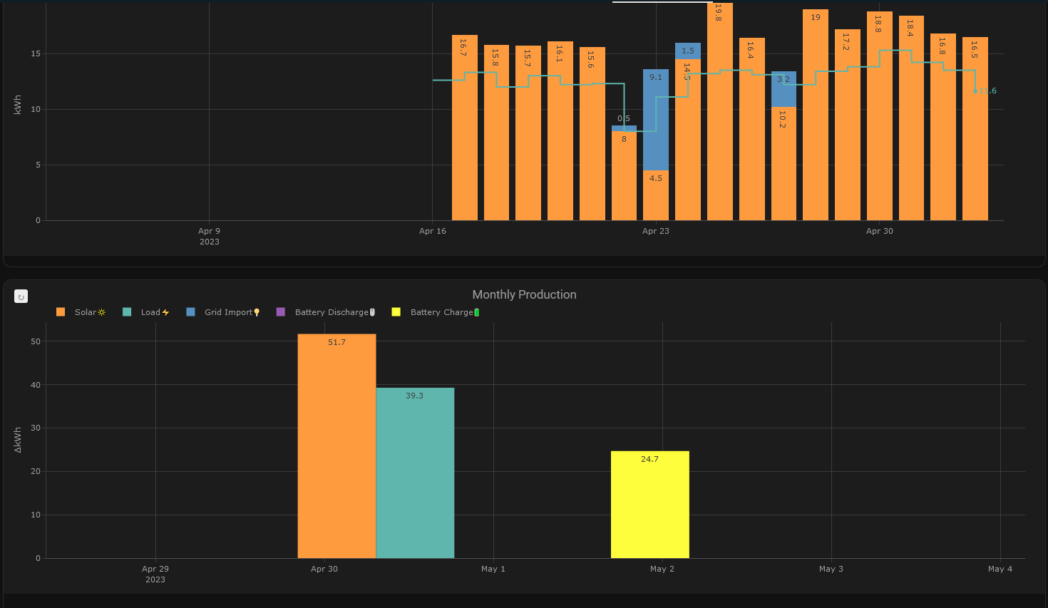

@randomfool Quick question I see the monthly Production has started populating and is summing the daily values into the month.
My question is more about the bar width.  From what I can figure it is supposed to give you your last 6 months at a glance per month.  But is would seem it is condencing the sum totals on the first day of the month and not spanned over the complete month so the 6 month will have very thin bars spaced out really far or am I missing something perhaps 🤷‍♂️  It started populating on the 1st for me so after 3 days it is still just showing on the first with these thin bars so not sure if I'm jumping the gun again 😁
Was this the intend view or is this something that will need to be tweeked.  I've tried to firgure out and to tried to widen the bars with no luck so far.
Default
If I double click on it, it seams to jump to a single month I've clicked on where you can see it looks to be x axis is listing all the days of the month and the sum is happening on the 1st day.
Sorry if this was asked/answered already.
Default
I think plotly does not have enough data yet so it doesn't know how wide to make the bars.  You can try adjust the width and offset by adding the following to each data set. I suspect that you will need to remove once you have a months data.  Play around with the values to adjust the width. Also you cant use the same offset for every entity as they will draw on top of each other

@slipx I think I might be jumping the gun again and the bars will widen as the data set increases, I think the 3 day data was still to little to see a notable difference but it looks like it but will confirm once I'm home tonight that it's not just an optical illusion being on a different monitor at work 😅
Looks like you are right again, not enough data yet. Looks a little thicker today vs yesterday so should fill up the month once a full month have passed 👍
