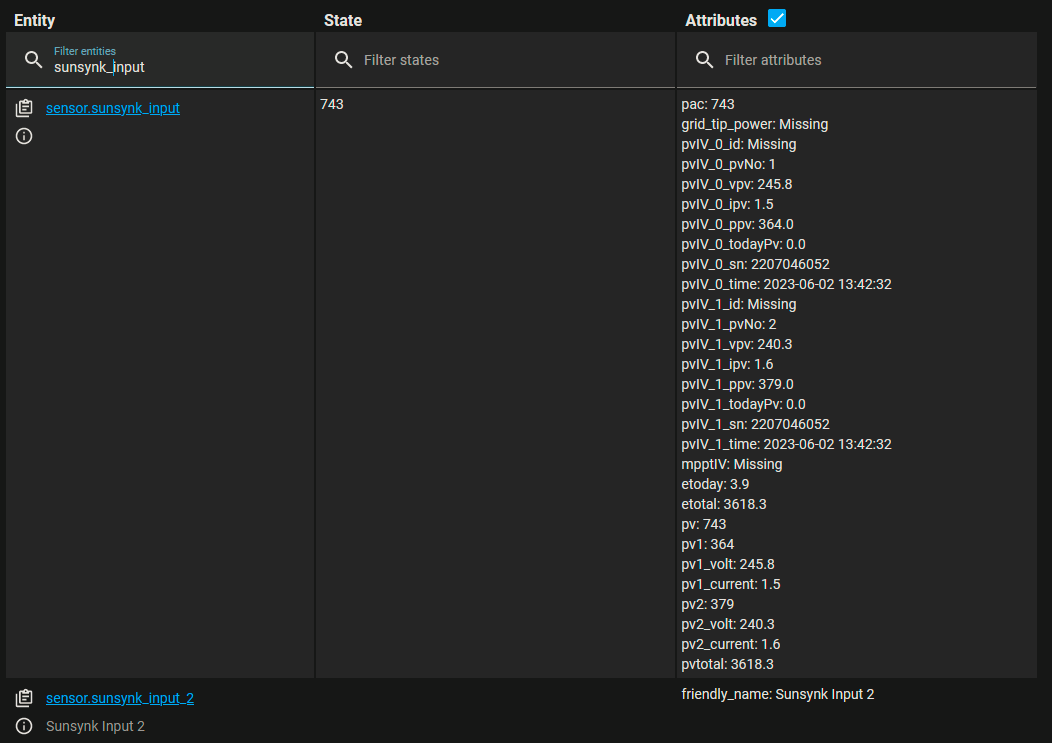

Hi ok I have figure most of this out.
Got the flow card working finally.
But it seems the sunsynk integration is not pulling any data from pv 3.
I noticed on the phone app only the first 2 strings show up but the desktop version shows all 3 strings.
Probably need to include the mppt in your template sensors, currently only 2 in the template, current one should look similar to this, add the 3rd one for voltage and current.
