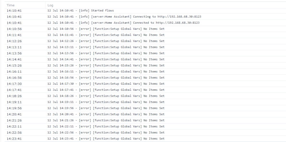

6 hours ago, Gary Waterworth said:
@Gary Waterworth pretty sure its all connected, below is the log from Node-Red. I use the IP address of the server as opposed to local host as this is recomended when using a NAS setup (I have however also tried with local host and get the same message). I have also done a fresh install on a VM I am running on a laptop and get exactly the same error.
  • Replies 949
  • Views 137.1k
  • randomfool
    randomfool
  • randomfool
    randomfool
Post a screenshot of this plse as per that post I linked on your system
The reason for that error is that the entity is not being seen
Also include the HA variable shown in my pic

10 hours ago, slipx said:
Make sure you tick the "Enable global context store" when setting up your server node
@slipx you are an absolute genius 🙂 ... I have just enabled this and everything has populated. Thank you so much !!
