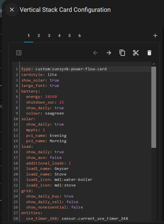

Hi all, new the the forum after watching @Sc00bs videos, Thanks btw :) and great work @Gary Waterworth and Other who have contributed!
I'm struggling to get my card to show data after following instructions via these two videos (Link 1 / Link 2)and and I'm only getting battery state, any ideas?
I am however seeing daily totals as per below and seeing the stats pull through against the correct entity's
Edited by chessmaster

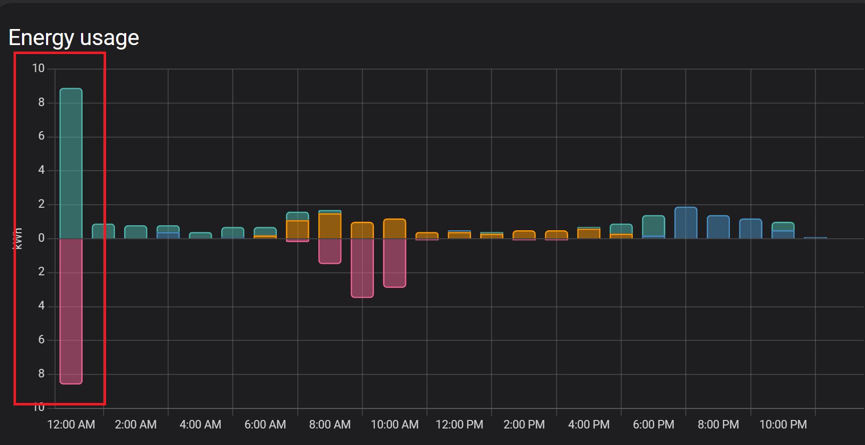

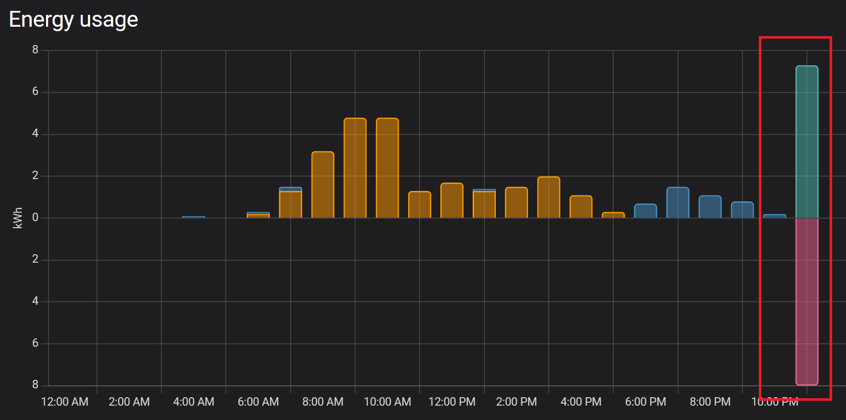

Hi all, been using the integration and it's been rock solid, however and this maybe what you were referring to @Gary Waterworth the integration seems to be behind, I am using this in the UK and the clocks have just gone back so not sure if this has any effect?
For example here is the website
And here is the integration
Notice the battery SOC?
Regards
Edited by Ivan Endicott

Region 2 ?
global.set("SS.url.i1.battery", global.get("SS.url.hostname") + "/api/v1/inverter/battery/" + global.get("SS.Invertor1sn") + "/realtime?sn=" + global.get("SS.Invertor1sn") + "&lan");
That is the url that is build to retrieve battery data. We dont embed a "time" to get data for. We request the latest available
You will probably find Region 2 server has a time quirk now that daylight savings has come in.
The bug I was referring to above was when some totals just stop "running" and then catch up hours later.
Edited by Gary Waterworth

14 hours ago, Gary Waterworth said:
Region 2 ?
Yes region 2.
Thanks for the update Gary. SunSynk servers are not stable at the moment from posts on other forums.
Appreciate all the hard work you are doing with this product. 👍

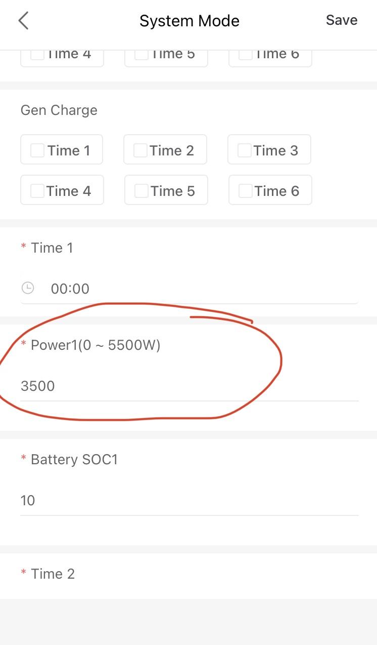

I’m busy with arranging the timer and power settings within home assistant, instead of changing it through the sunsynk app.
Does somebody know how to write the timer power settings and battery charge settings? This in order to steer the speed of discharging and speed of charging.
thanks in advance!
