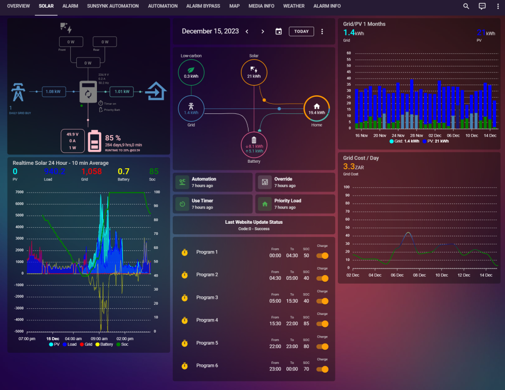

Dashboards
7.) How to setup a really cool dashboard :)
Install xyz additional packages
Create dashboard, add card, import code from a here
add additional cards from here...

This is ultimately where everyone is trying to go, to help with the DSF, how to export and import easily with a single click or using automations

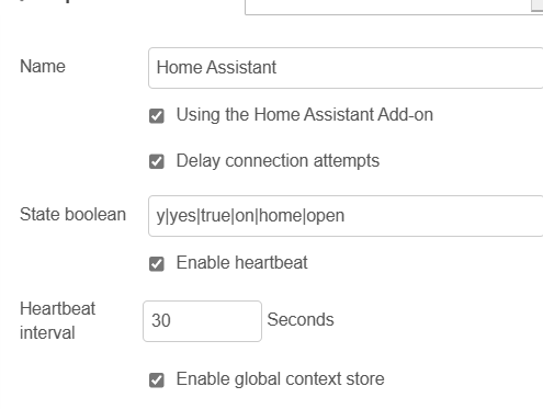

I've now followed those steps and added the flows into node red, also wasnt sure if I needed to add sensors to the yaml file? from  https://github.com/gdwaterworth/Home-Assistant---E-Linter-Logger---Sunsynk/blob/Stable-Release/V1.1/Templates ( Region 2 ) - Sunsynk.txt
I'm now getting a "No Items Set" in the node: Setup Global Vars image.thumb.png.a0e7c8b049c68a5a5577dd785805c2fc.png
Also can't see any entities being pulled through in Dev Tools - States, yet!

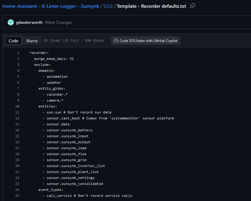

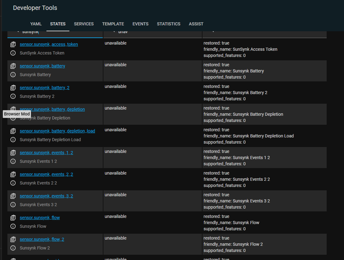

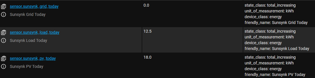

@Gary Waterworth two questions:
1) Any reason why I'm still seeing the old sensors from v1 in my developer tools -> states as unavailable?
I've deleted the v1 flow from node-red and and from my config file and I've rebooted HA. 🤷‍♂️
2) The purge recorder is it supposed to be referencing the old entities or should those be the new ones?
sensor.sunsynk_usable_XXX
Purging these won't affect my ploty card data as long as they are not included in the list?
e.g. that 90 day looks at these
Those are pulled from these effectively:
  - sensor:
      - name: "Sunsynk Grid Today"
        state_class: total_increasing
        unique_id: "sensor.sunsynk_grid_today"
        device_class: energy
        unit_of_measurement: kWh
        state: >
          {{state_attr('sensor.sunsynk_usable_grid', 'dailyusedin')|float}}
  - sensor:
      - name: "Sunsynk Grid Export Total"
        unique_id: "sensor.sunsynk_grid_export_total"
        state: >
          {{state_attr('sensor.sunsynk_usable_grid', 'totalusedout')|float}}
  - sensor:
      - name: "Sunsynk Load Today"
        unique_id: "sensor.sunsynk_load_today"
        state: >
          {{state_attr('sensor.sunsynk_usable_load', 'dailyused')|float}}
Edited by -cK-

Thanks CK
Have used your file, but still getting the "No Items Set in "Setup Global Vars" in nodered.
Have also setup the secrets file with email, password / Set sunsynk_sn_flow to 0 with the serial number for SN_data
Struggling to figure out how do to these checks, perhaps could be related to the error im getting:

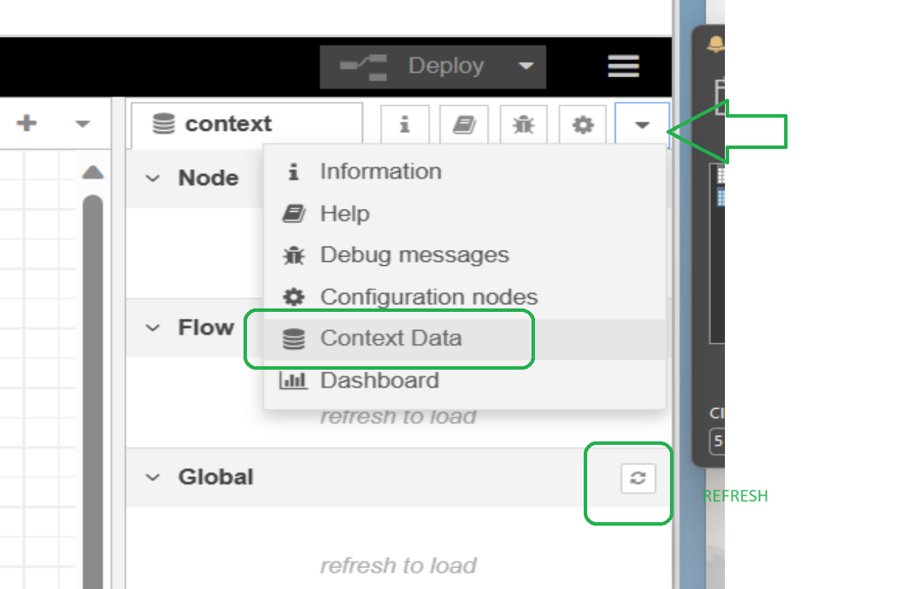

13 hours ago, Gary Waterworth said:
Global Context
You may need to open teh debug view then pulldown top right , select context data , hit refresh button
SS :- General Work Area
SS_Consolid :- All Data actually pulled from account
SS_EXport_Data :- Processed Data that will be populated to the sunsynk_usable.* entities
This is the single function that is on it's own on that extra flow page.
Designed that way so it can be swopped in and out for different plant inverter setups.
Needs a lot of documentation so people can see how to edit it for their own needs
Because we are exploring all plants and inverters in an account , we cant just export everything to a single entity. I tried it and HA was not happy with a sensor of over 16k bytes :D
You should find the SN and ID here. 👆

On 2023/07/27 at 10:37 PM, slipx said:
Make sure you tick the "Enable global context store" when setting up your server node
Mayby check this, on v1 someone else also had a similar error and this I think resoved it.  Check page 16.  Might be a miss configuration of node-red
  - sensor:
        state: >
  - sensor:
        state: >
  - sensor:
        state: >
1. Old Entities :- You need to clean those up . They are unavailable as you are not providing them anymore
Settings -> Entities -> select them, delete/erase
2. I will fix the purge recorder 😕
3. Any entity referencing a purged entity is fine. Keeps its own statistical
  Entities having main data in statistics wont have attributes ( which most of my core ones are ) as statistical data.
Enable these and make your life easy.
Should be default if I remember correctly
As long as teh Node Red Companion integration is added it will work. Then teh long life token will only be needed for teh other config node

1 hour ago, chessmaster said:
Thanks CK
#####                   Do a run through then in node red look at global context data under
#####                   SS_Consolidat -> Config Data -> Inverter Plant
#####                   [Inverter SN]:[Plantid]
##### sn_flow:          Plant ID to use for flow data
Extra note for others :
Dont do this :)
...  Set sunsynk_sn_flow to 0 with the serial number for SN_data
Only put in the plant and sn id's when you have them
The flows look for xxx as an error check

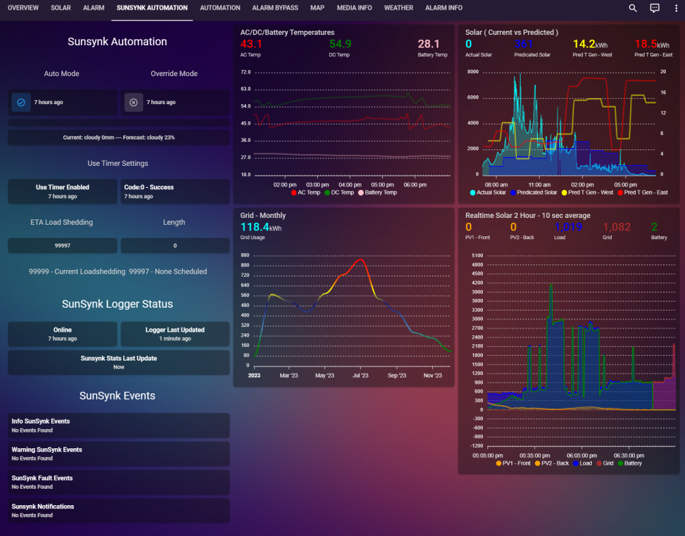

Dashboards look great btw, curious as to what you have in your Automations tab?
9 minutes ago, chessmaster said:
😀 I must go back and sort this
This is South Africa Specific :D
1. Calculate ETA next load shedding and length of it
2. Modify 2 x SOC values based on weather predictions
3. Make sure that when load shedding is due I have a specific SOC in the battery by manipulating the "use timer" to force charge if needed. Fairly complex logic calculation taking into account :
a. current pv
b. time of day
c. weather predictions ( current and future )
d. when is load shedding
e. how long is it going to be
   and some other variables :D
4. Also some notifications on grid/use timer change. had to rewrite some of this to ude teh new v2 base to set inverter values instead up updating the sunsynk directly
5. Also a lot of error checking that logger is connected, sane data is being fetched etc
Edited by Gary Waterworth
