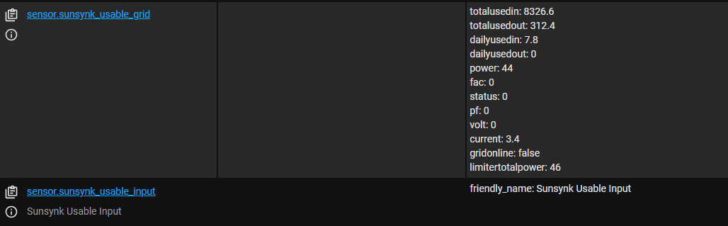

Need the rest of the info :)
But send Screenshots of all the sunsynk_usable_* entities so we can see what is populated ad a sscreenshot of teh flows so we can see what has been successfully completed
Here are the screenshots
image.thumb.png.30f0ed799bd26560026fb29220e9020f.pngimage.thumb.png.f0aee7c25d31cda532140d01f7e04fda.pngimage.thumb.png.318c76a2b440b7d194ecbd6b5a5c7c2d.pngimage.thumb.png.a33ccd24ff5191718a9a3940e63e30c7.pngimage.thumb.png.f89217db00193293b3768dbaa836e492.pngimage.thumb.png.36be1fb7e2402594e16220684cdd263f.pngimage.thumb.png.70e5dc8c16f199489179c34f8b07ed0a.pngimage.thumb.png.1eba7af586654b98f85dc96f16031b41.pngimage.thumb.png.35d27fc77921293387a869b5a79a255a.pngimage.thumb.png.432c08dc10bdbfec4e187de6e5a84d3a.pngimage.thumb.png.023c32c450fd49ff7dac002242c226ec.pngimage.thumb.png.be29d82f1d4213140235cee229a5c845.png
Look slike your secrets file is not being read properly
Check it again for space before and after the sn and plant id
Then reboot the home assistant device , not just a home assistant restart
This will reset the global context data which survives a HA restart
Also send me a screenshot of teh flows so I can see if everything has run correctly

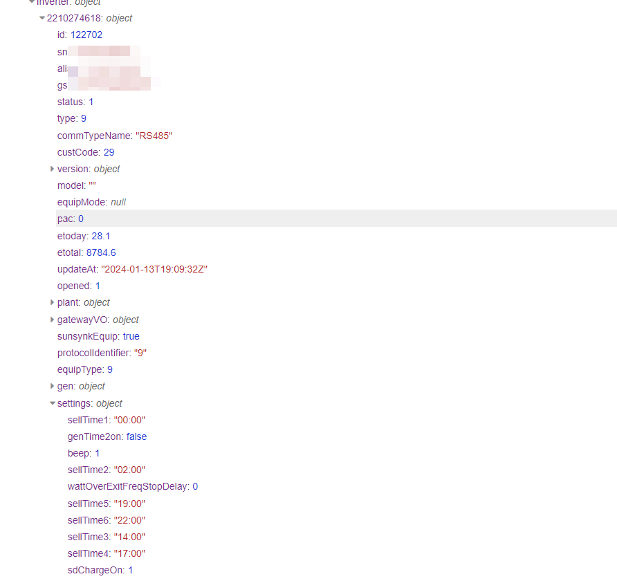

2 minutes ago, Gary Waterworth said:
That looks correct for teh flows that matter for gathering. Can you also show me that single flow that is on its own tab
7 minutes ago, HowserMD said:
@Gary Waterworth, context data as requested.
Turn off all the debug nodes that you have turned on . This is looking definately like a plant id/sn issue
The source data is fine. The exporting to usable sensors isnt and it looks like all values where a "sn" is used
Where teh "tab" is extended
Then clear debug mesages
Wait for a gather run and send me the debug messages list
There is not a lot of error checking in that export node yet, so may have to add some
Edited by Gary Waterworth
