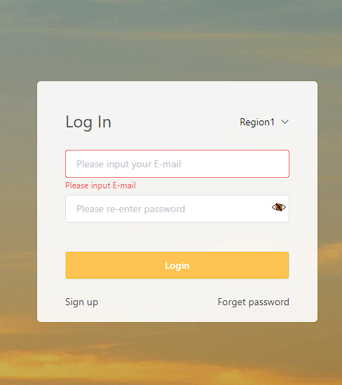

Hi all,
I loaded everything correctly according to the instructions for v2.2. I am able to log in to pv.inteless.com and api.sunsynk.net (Under region 1) and I see my plant.
I changed the yaml file to reflect region 1 but I get the following on Node Red:
Funny enough I can also login with my credentials under region 2 but no plant comes up. If I change the yaml file to region 2, the flow goes correctly until the end of "Get Plant List" where it obviously doesn't find a plant
Any idea on how to fix this would be greatly appreciated!
3 hours ago, Gary Waterworth said:
I don't have a plant in region 1 anymore so I cant see what they have changed. I thought everything has moved to region 2 ?
If you want you can send you login details to me privately [email protected] and I can look
Thank you Gary. I've sent an email.
Really appreciate the assistance.
