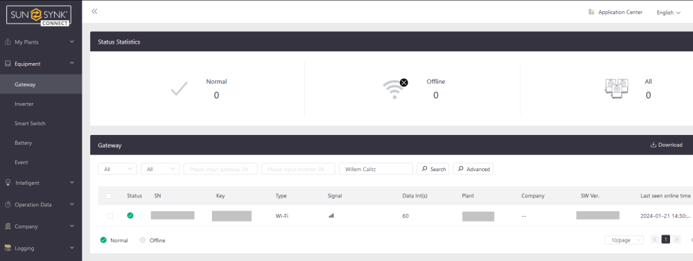

I've done a shut down and boot up again after importing the new flows.  This is what that section is returning:
What I'm noticing is where yours shows a total: 1, mine shows 0 and the info is array[0] and no drop down.
Not sure if this could be related to how my account is setup.  In the Equipment section I need to first search my gateway under the plant name which show my plant name then is shows up and then I can edit it.  Nothing is listed in the Equipment section, I only have access to my settings via My Plants.
Edited by -cK-
That is teh problem...
You cannot see your gateways. This may be a permission your installer has not given you
I will have to put a "override" in the config to ignore this
Edited by Gary Waterworth

7 hours ago, -cK- said:
Thanks, will appreciate it.  Will go chat with the installer before trying this but I see there is an option to add a gateway and I do have both the sn and key which I can see if I search my gateway now that my account is elevated to Advanced User (was hoping my stuff would get listed under the equipment section automatically but alas no such luck).
Dont do this. Your gateway is there , you just cant see it 😕

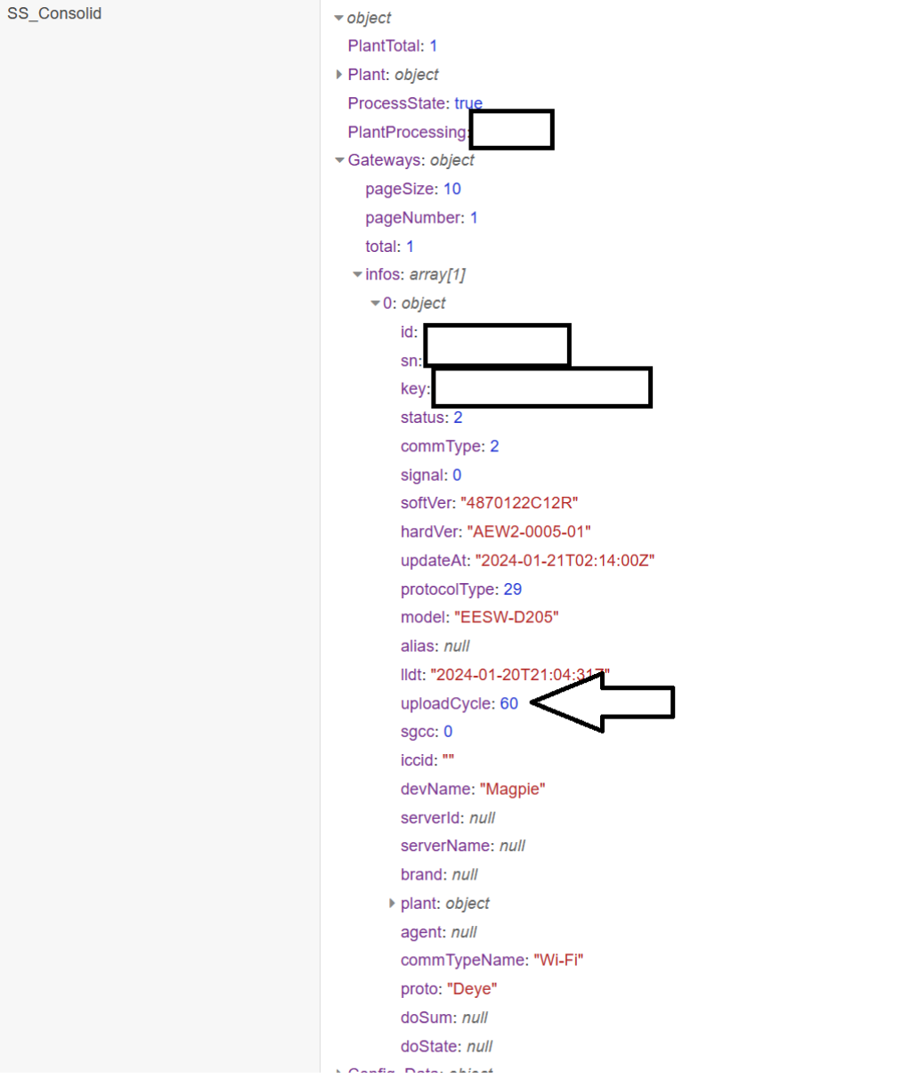

Check permissions under global context SS_Consolid:
I am interested in what gateway.* ones you have
Will look into this. i may need to do gateways by plant, but then will neeed extra logic
On which version you want this info there is now technically 3 I can do for you or will it be the same across them all:
1) 2 updates back, pre the 60s logic
2) 1 update back. pre override logic (believe I still have a copy of this instance)
3) latest update with override logic
On nr 1 the info looks like this:
If you need it on the updated versions I'll need to do that tonight when I'm home for you.  But if it is going to be the same across the board I see inverter.settings.name is array 1 on yours but mine seems to be on array 3.  I'm guessing this is part of the problem that the arrays don't line up with what is in the flows.

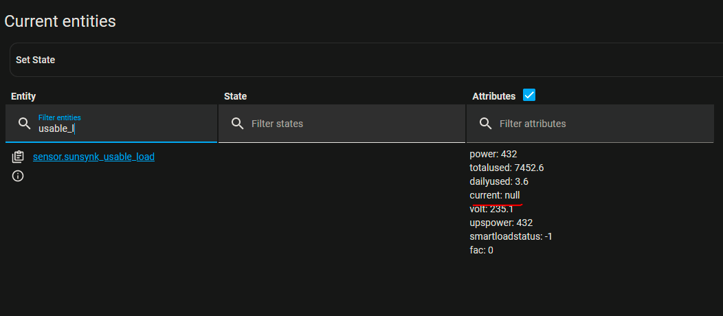

On a side note I've noticed that current is returning null under the usable_load
Shouldn't this be returning the load current that the inverter is giving to the home (so if the power is 432w the current should be around 1.8A if my math is correct), not sure if this has been addressed in you updates and or if this is another "me_bug" as I'm still on the older flows.
Edited by -cK-
Ok I found a logic bug in 2 of my functions
I am busy looking at it , but I need to doa whole of of checking to make sure what I am chaanging doesnt break automation
EDIT Ok , while fixing a bug on my side I can see a bug on Sunsynks side :)
Their payload show 0 current on the load :D
Probably going to have to put in a manual calculation for this.
Thanks this is fine. Still the same over all the versions
You have some interesting permissions I dont have. Cannot see why you cannot list all the gateways ~shrug~
Okay cool, it's not just me 😁
Yea as an interim workaround I just edited the sensor that needs this in my config to do the calculation instead of trying to pull it from the attribute itself until it is sorted 👍.
{{ (state_attr('sensor.sunsynk_usable_flow', 'load_power') | float / state_attr('sensor.sunsynk_usable_load', 'volt') | float) | round(1) }}
