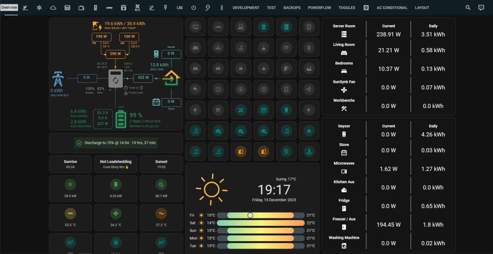

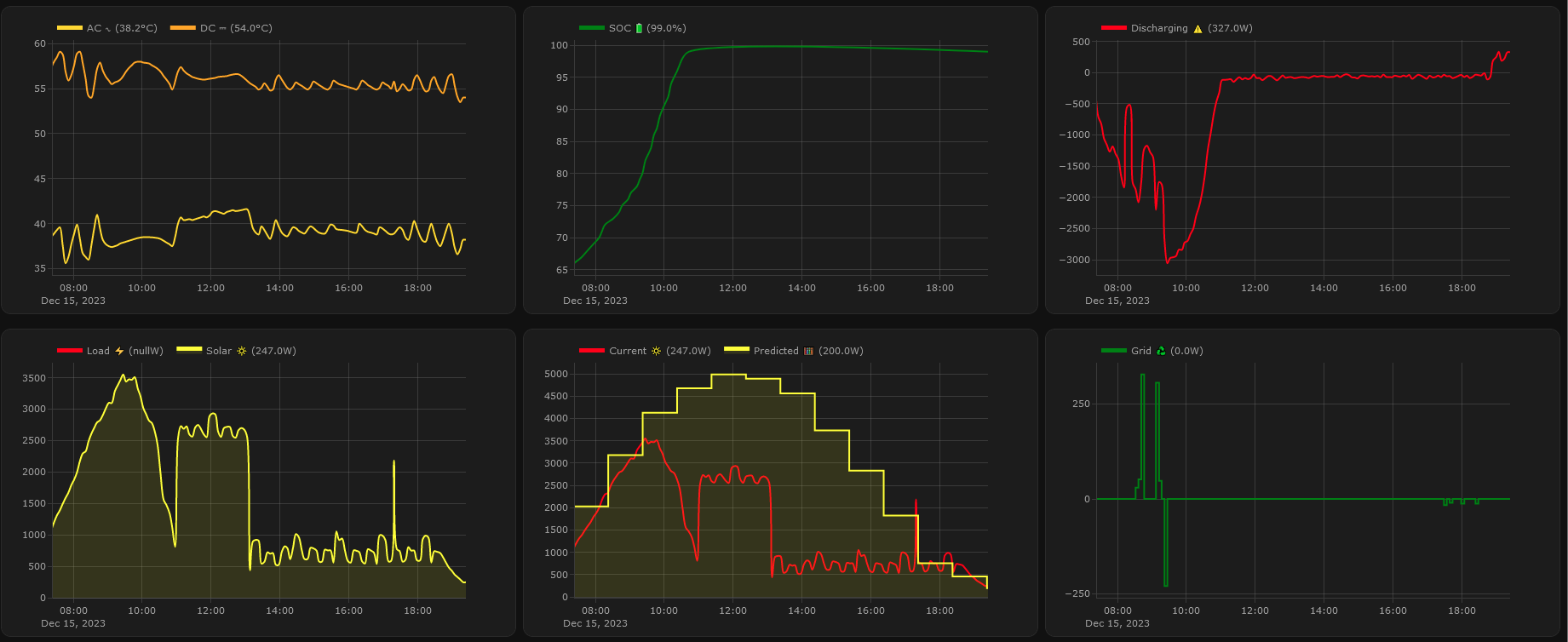

No plotly graph cards.
https://github.com/dbuezas/lovelace-plotly-graph-cardimage.png.22a063587dcdba7b98aa85ab23fb175c.png
Used to use the apex cards but switched the plotly cards mainly as you can scroll backwards and forwards on them to look stuff up beyond the set timeframe of the apex cards.
But I still have some apex cards hidden on my main display for those quick graph glances
Edited by -cK-
All of those power reading on the right are from sonoff devices.  Can't go wrong with them.  I like to use Dual R3's that have power reading you also get the lite version without power reading.  Just be mindfull of the power limit on these smart switches 10a per channel on the Dual R3 (two channels) and an overall 15a if both are pulling power if I'm not mistaken.
Our vacuum sometimes trip te smart switch when you turn it on with an initial high power spike so I always have an unmonitored plug I can use for these devices that can cause a spike on startup and trip them.
Hence a virtual DB was setup 😆

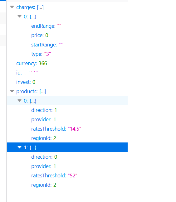

First of all i wanted to say what excellent work you have all done, the integration is great and i have had it running for a few months.
In the UK we have Octopus Agile tariff and there are some specific settings for battery charging and discharging against this 1/2 hourly pricing, these are hidden under the plant list and revenue info.
I would like to automatically update the numbers each night based on the day ahead calculation for the next day, i can calculate the price, but i don't know how i would build this into the node red flow and trigger it to send.
I captured the API call that is sent back to update
 {"id":"262605","currency":366,"invest":10000,"charges":[{"price":0,"type":"3","startRange":"","endRange":""}],"products":[{"direction":1,"ratesThreshold":14.5,"provider":1,"regionId":2},{"direction":0,"ratesThreshold":"52","provider":1,"regionId":2}]}
the two numbers are 14.5 & 52
Any help or pointing me in the right direction would be much appreciated
It isnt that easy :)
Quite a bit of work to add in new fields to monitor for changes and then code for teh updates. Let me have a look at mine later and see how my revenue info is set up
Been battling with a stoopid update ( true/false ) on the time?on sensors. Website says cool with the updates, but they never reflect
I have also updated teh request headers in the "developement" branch to more accurately reflect what region 2 is now doing
You cant just blindly send to teh website continually.
Bad coding and also not good and prone to causing problems.
So effectively need to see how to get teh current state 1st, make sure you are in a sane state ( logger online , updates in last 2 minutes etc and only send if there are changes.
Offhand it looks doable. Headers are slightly different to teh otehr settings requests
BUT the who settings request layout is a bugger up
It doesnt look like I even pull in the revenue information yet. The way I get the plant information is not teh way they do it to get the revenue information. Going to need to think on this as it could affect a lot of the logic flow I use.
Going to have to see how to handle this

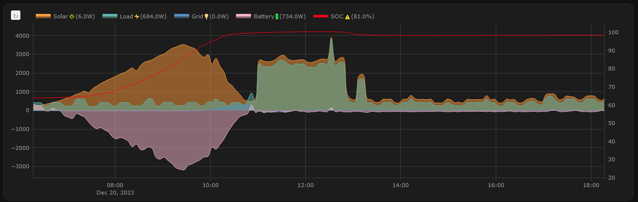

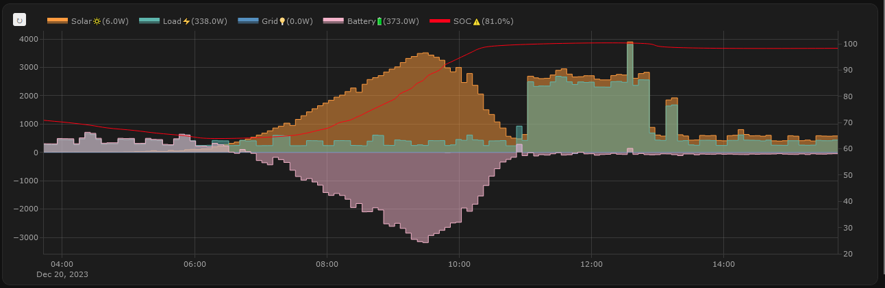

Trying to sooth out the lines ..
Any ideas  ?

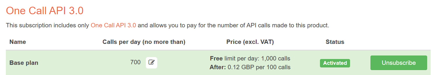

I use for my weather.
Funny enough I turn off my alarm monitoring on my electric fence for rainy weather. Still get notifications on my HA though
Predictions seem to be ok for me
Signed up for this plan . I stay under the 1000 API calls
image.thumb.png.9bb65074fece05d43b6e6f31dd58b706.pngimage.thumb.png.105542a621274b8e9dfd251713fe512a.png

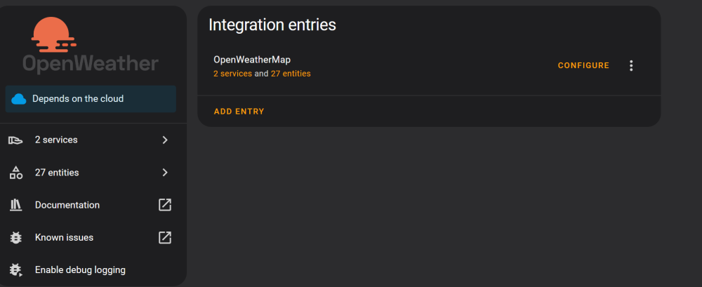

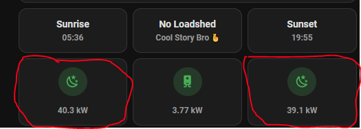

Also have that OpenWeather integration setup mostly accurate for the Solar prediction, might not be a bad idea to maybe add an additional condition to consider in my automation if the predicted production is also below xKw for the day.
Should help prevent triggering and switching when one could perhaps still push through without flipping to grid when the weather might pick up a bit later on. 🤔
Already have it showing the current day and next day expected production to help me make decisions on the day if need be.

Openweathermap does solar prediction ?
Pfft ok , never mind. A paid service and actually quite expensive ( South AFrican terms )
Edited by Gary Waterworth

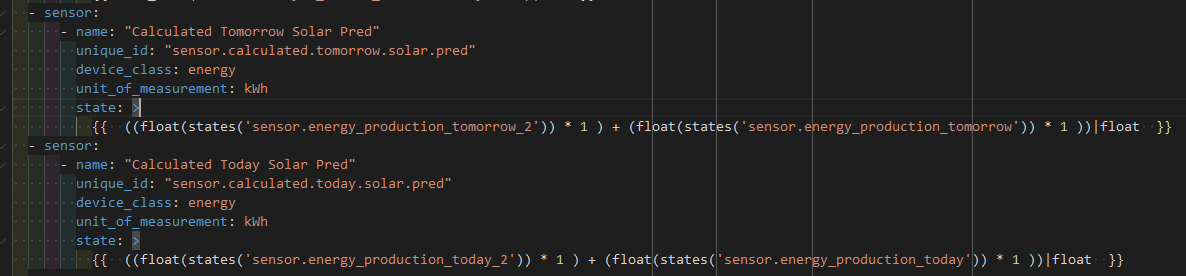

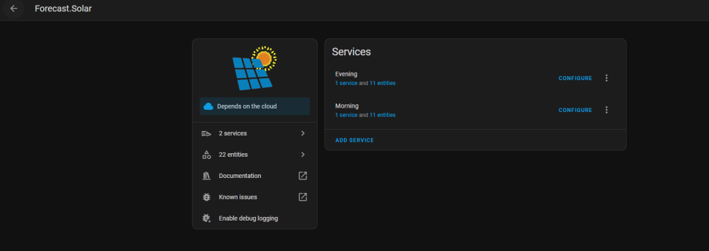

Appoligies those predictions are not from openweathermap but from forecast.solar 🤦‍♂️  image.thumb.png.ea168eaff82d553c54f62261da783ed6.png
I set that up so long ago I forgot what I used.

The only thing I found so far to smooth out the lines with my limited knowledge of the cards are
shape: spline
it doesn't always work though for instance the bottom center if I put spline on the yellow line it looks like this 🤷‍♂️
Without Spline
With spline
Edited by -cK-
It might also be useful to add a filter if you are getting drop outs or missing data.
  - entity: sensor.ss_battery_soc_184
      $fn ({ ys,meta }) =>
        "SOC" + "" + "(" +ys[ys.length - 1]+"%)"
    yaxis: y2
    line:
      color: red
      width: 1
      shape: spline
    fill: none
    filters:
      - median:
          window_size: 2
          extended: true
          centered: true
I don't like the sliding moving average as it flattens out spikes i.e. if you turn on the kettle for 1 min.
