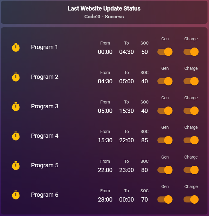

I had a quick look at your script and I noticed something that has come up in the past with scheduling. It may have been fixed, but older inverters will have a problem. I have seen the problem on mine
The 1st time slot should allways start at 00:00.
The way yours are done this wont be the case
example mine are :

example mine are :
Hi Gary, in the 3 months I have been running with this timer configuration it has worked flawlessly for me.
It sets the timer1 value to the nearest 5 minutes before the current time e.g. 16:23 becomes 16:20
timer2 is always set to 23:55, so the inverter only ever needs to look at timeslot 1; therefore all other time slots can be set to 00:00.

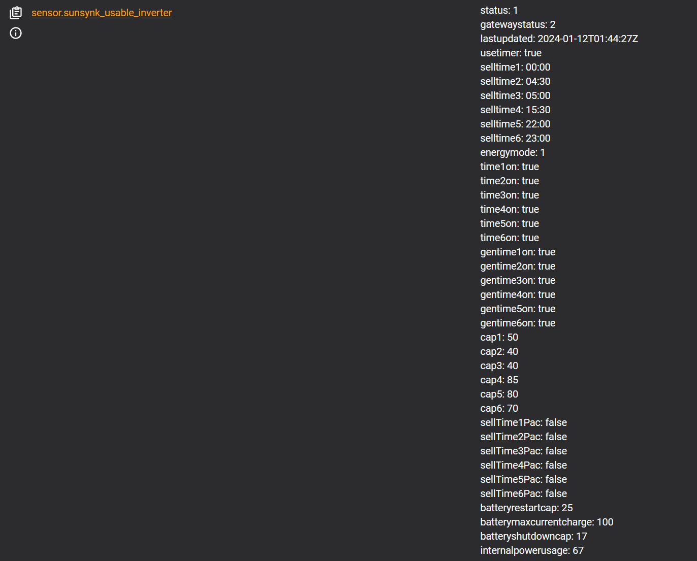

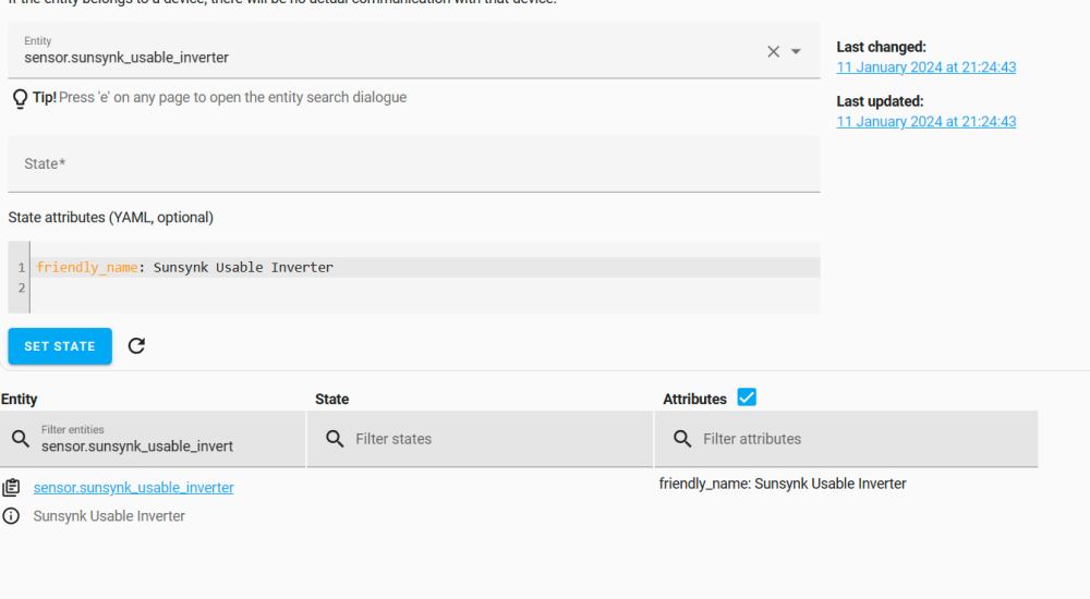

This get its information from the sensor :
Can you send me the output of yours ? Can see from there if it has been correctly populated.

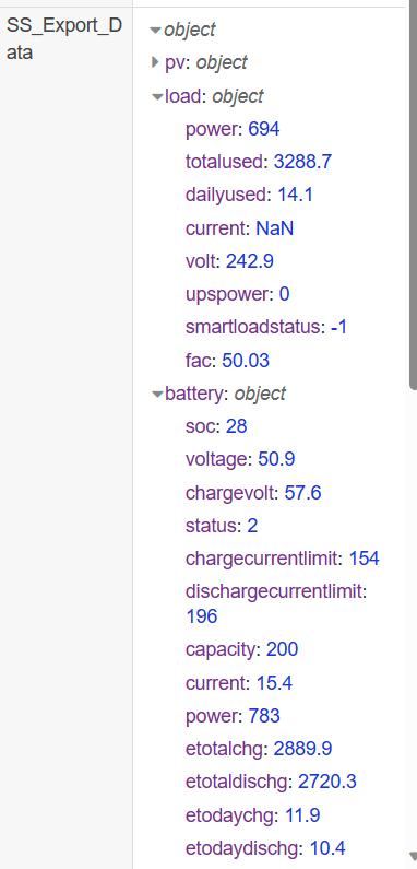

32 minutes ago, randomfool said:
Post the contents of your secrets file plse , Send it to me in DM, just blot out login and pwd

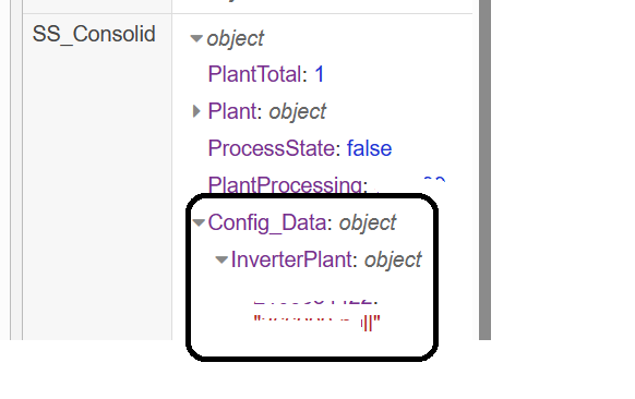

Also a screen shot of the the contents of the global context : ss_Consolid -> Config_data
Are there any errors under
and more important here
Then also check that data is in teh global context ready to be exported to entities
Edited by Gary Waterworth

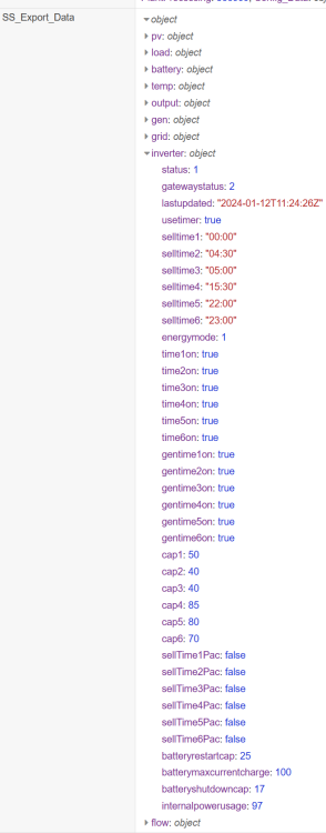

Just for reference @randomfool this is how mine looks and it works (obviously fake details)
One of the things I encountered when I had the wrong serial numbers in there was only partial info was pulling through.  I don't have anything relating to master of slave added to my serial numbers perhaps try it without that parameter if you have something setup for it, otherwise as Gary said send him your secrets files.
Edited by -cK-

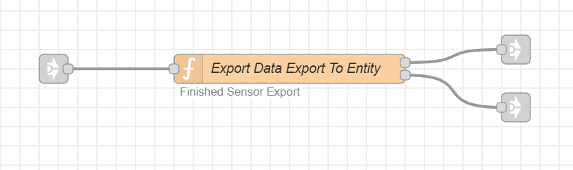

Just for Everybody's info
This is the flow of information
Data is 1st gathered into SS_Consolid - This is the COMPLETE set of raw data
layout is :
SS_Consolid -> Plant [plant id] -> Inverter [Inverter ID]
This data is then processed by [Export Data Export to Entity ] and placed in SS_Export_Data
SS_Export_Data is then populated to the Sunsynk_usable_* entities

I did the same (or rather tried).
I am getting the following errors from node-red.
I can see being retrieved and updated in SS_Consolid.Plant.<id>.Inverter.<id>. I can see the bmsSoc, soc, etc, but they are not updating on the card or the home assistant states.
I am pretty sure I missed something.
Hi all
yhis looks great. Been looking for an automation that doesn’t rely upon direct cabling into the inverter
my main use case is to automate force charging when we get a cheap period on our so toous Intelligent tarrif outside of the normal hours.
Before I start integrating can I check…
1. This will allow me to force charge (maybe my toggling the “Use timers” setting?
2. Presume it’s best to use v2?
I have a 10kW 3 phase Sunsynk inverter
Please send the information asked for a few posts back for a similar problem
