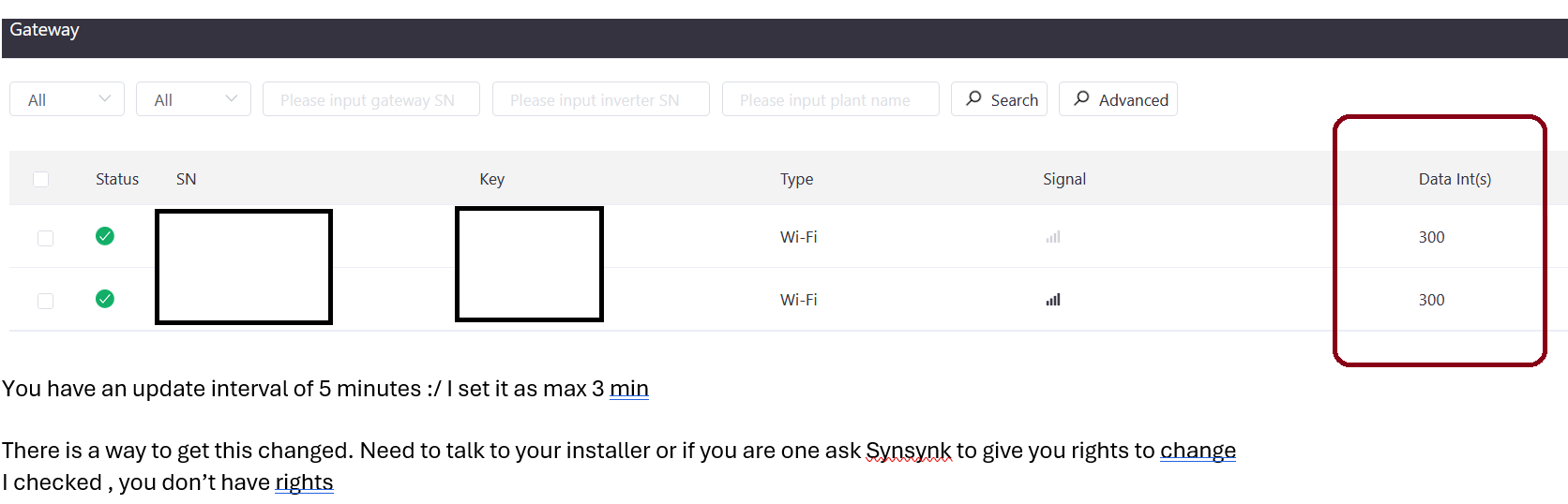

One thing that needs to be checked is your gateway update interval
All new installs seem to be 300 ( 5 minutes )
You will get outdated data errors and I definately would not turn on entity updates with it like that.
I will make a change on the flows to only complain of outdated data after 6 minutes
Going to have to build in some more error checking in the update flow to disable on this
Means I have to go gather gateway information as well
You can see this in teh app under equipment -> gateway

@Gary Waterworth I've previously requested my installer to set my intervals to 60s but it seems they don't have that admin right on the gateways either.  Actually had them show me and they have the gateways listed but the option to set the refresh interval ain't there.  I've requested them to ask Sunsynk to give them permission to change this or try and get mine changed but if I can't get this changed how will this effect me.  Is this just an error checking being disabled or will this effect my ability to push commands to the inverter, besides having a 5min long delay.
ATM it will affect commands being pushed to the inverter as currently it can result in "flipflopping"
I will work on this , for in the case of a long update delay, to put in a six minute post update delay
Thanks I've held back on updating my flows with this update when I read that and trying to get my interval set to 60s but not holding my breath at this stage it will happen anytime soon.  It is a pain in the a$$ to work around this 5min delay sometimes as it requires adding logic to your automation to take this into consideration to avoid "flipflopping" like you said.
You can request sunsynk to upgrade your user level to advanced, did not need to ask installer to do anything.
You have to request a user level elevation to Advanced User and then you should be able to drop it down to 60 seconds (down from the default of 300 seconds).
Visit here and scroll down to User Level Access Change, they will reply once it has been done then you need to login to the sunsynk.net website on a pc as the app doesn't allow you to change it yet.
Thanks this won't affect the installers access to monitor and amend things right.

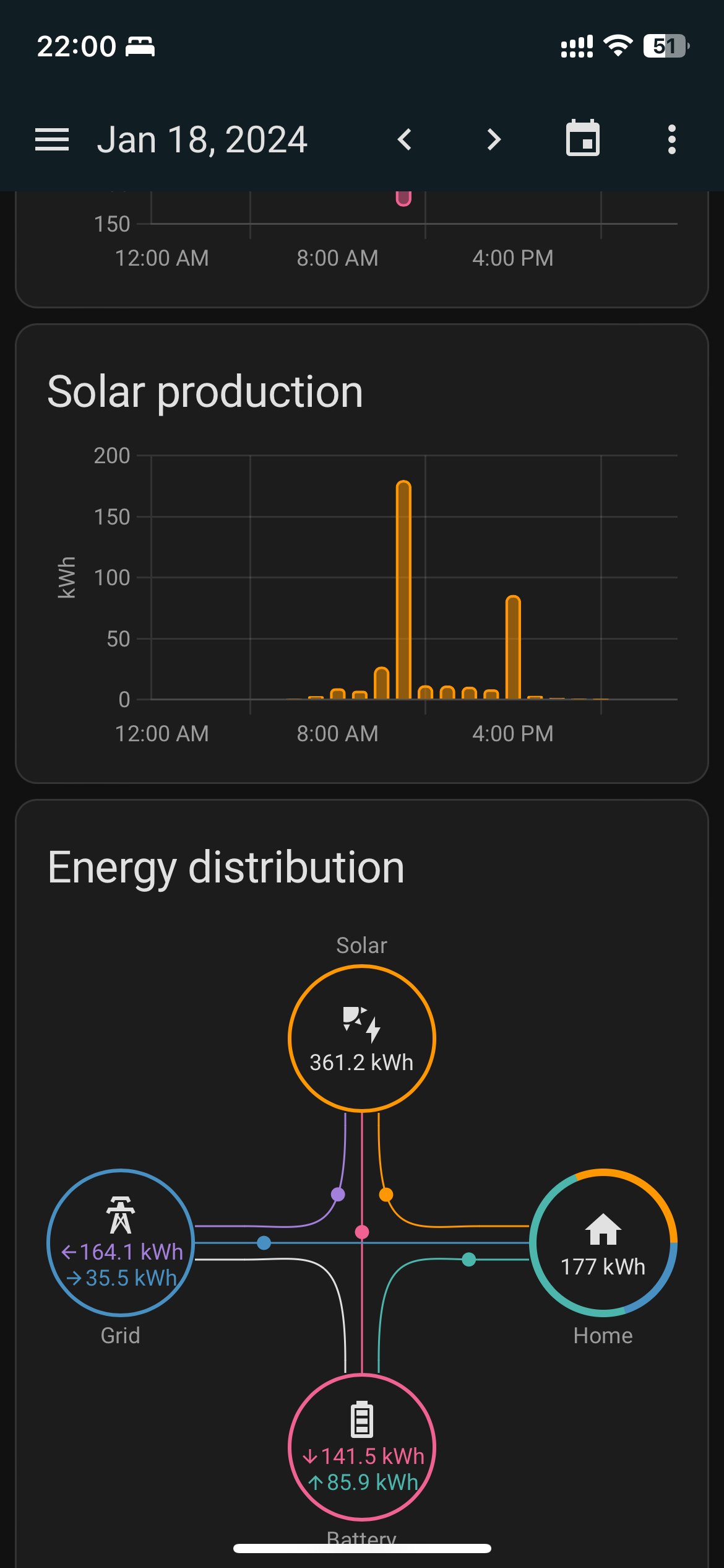

No idea but saw some random readings before noon today when my phone went nuts with notifications for a minute or 2 no solar then no battery then solar was giving double reading 🤷‍♂️.  Suspect something on the app side might have caused it.  Not seeing it on the sunsynk side so might be HA related.
Your energy dashboard is kinda fine compared to what I just saw mine looked like for today 😅.
43 minutes ago, Gary Waterworth said:
Definitely from sunsynk. I have to massage my statistical data now and again. I suspect sunsynk is still importing historical data into region 2
Yep I had to replace some with 0's the other day again as well.
