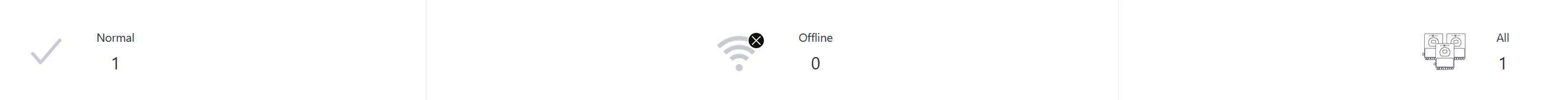

February 9, 20242 yr Author Note : This was all fine yesterday , going to reset my dongle again Revamping the error checking in the flows again. This is why I prefer functions to automations. Automation wont pick this up : Gateway itself says it was last seen at midnight : Gateway gathered shows gateway in warning mode, website doesnt show that But the Stats were just updated 😕 Go Figure the shitty Sunsynk data gathering Edited February 9, 20242 yr by Gary Waterworth

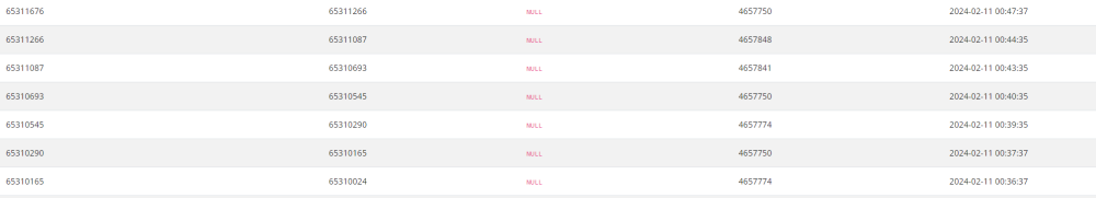

February 11, 20242 yr Author Very puzzled atm. Looking at the short term data the point in time readings are correc , but the sum jumps 😕 from 112596 -> 150134. Was no stats reset I can see Defies what I know of how the recorder works State data shows the problem Somewhere a figure of 37538.2 was returned .... Attribute data for raw data on Usable_pv for same time range Attributes for that time : Now etotal is a simple totalling for all inverters of which I have 1 : Tracing back further is hard, so going to have to see how I can log actual inverter data without breaking HA Got 2 options atm : 1. play with the filters I am testing to remove outliers 2. Keep digging and try see if I can log actual return data from the api Could be 2 causes : 1. Sunsynk is giving crap data ( not unheard of ) 2. Race condition in the node red flow. I am leaning to a race condition as the 37,538.2 value is exactly double what it should be This can only be caused by a longer running web api query. Will look at increasing the delay Edited February 11, 20242 yr by Gary Waterworth
