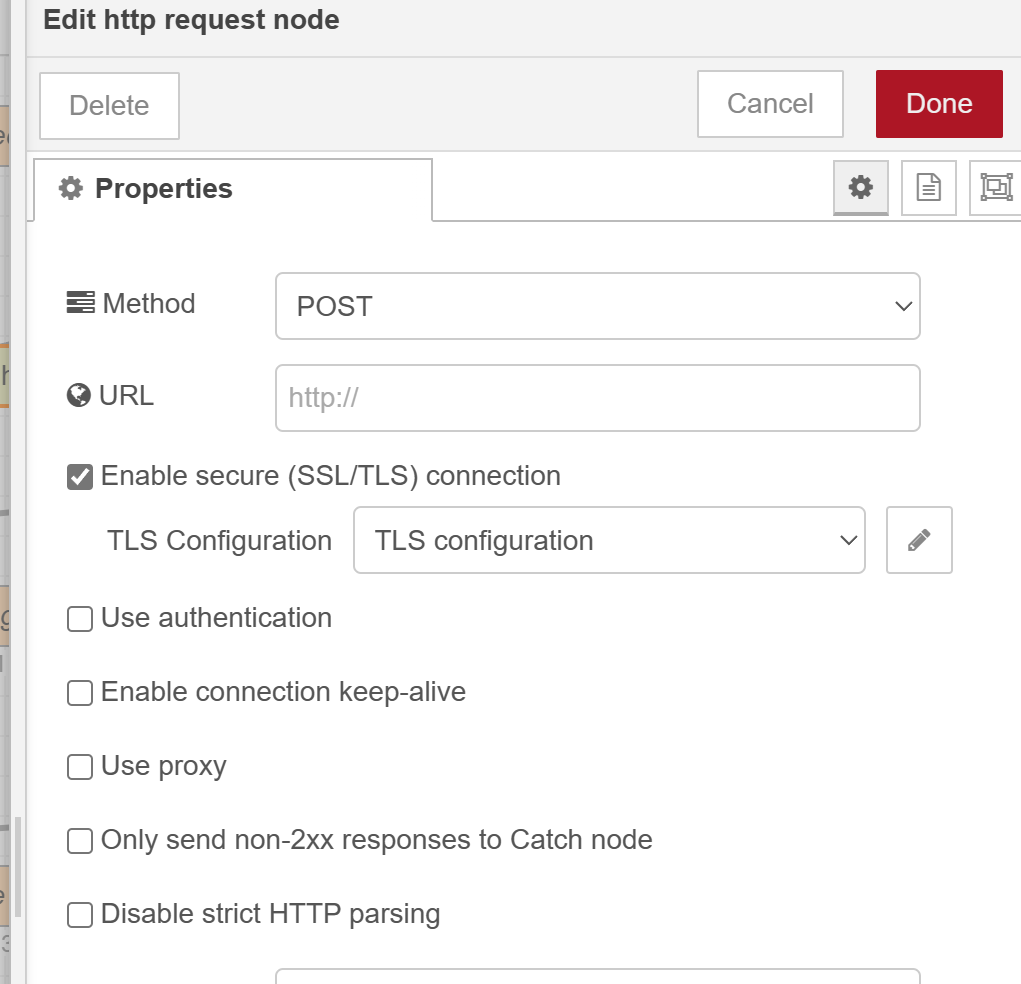

To fix the issue, I checked the SSL/TLS option on all HTTP requests.
Add a new config if one doesn't exist, and uncheck 'Verify server certificate' and Update.
Redeploy the node and that should fix the issue.
https://stackoverflow.com/questions/42983635/error-unable-to-verify-the-first-certificate-in-node-red

The error is a SSL cert that cannot be checked . This is their api website.
You could change the https to http ( so there are no certs ) , but couldnt be bothered to be honest unless they really mess up on that front . Not sure if their api support plain http
Ive been getting the message “Unable to verify the first certificate” recently.
any ideas what could be causing it? I notice the Sunsynk SSL cert renewed 2 weeks ago but can’t see any reason why that wouldn’t be recognised?
for now I’ve changed Node Red to skip verifying the SSL cert (not ideal)
