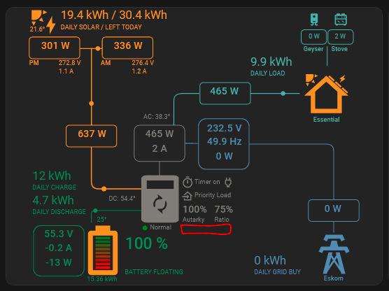

@slipx I was wondering if the logger last updated sensor could be added to the card similar to how it is in the card of Gary showing how long ago it was updated.
Was thinking it could maybe be added here:
and here:
I do have the logger card on a separate page but it would be more convenient to have it in the card.  No real space left on my dashboard to add it on as a separate card and having it on my front page will help a bit.
With all of the down time from Sunsynk lately the inverter doesn't always show offline so having this on the card you can at least easily see if it is up to date or not and not get false data from 3 hours ago like I did this morning giving me a false indication of my battery level 🤦‍♂️.
Hi @-cK- Thats a very unique requirement for a specific integration method and inverter combination and would not really benefit all the other users of the card. Why don't you see if you can use the  energy_cost_buy: or prepaid_units: entities to show this data

On teh other topic I will have a look at teh code to force offline the online indicater if teh logger hasnt been updated in the last x minutes
Just busy with work stuff , so may take a few days

@Gary Waterworth That would work as well 👌
@slipx Unfortunately using the suggested slots only returns 0 not a time stamp.
So was playing around with altering my dashboard but if the online status can incorporate the logger last update as a check this would be the better solution and I can revert back to my normal dashboard.
Just wondering if you should make the check linked to a configurable value or fix seeing not everyone is on 60s and having the option to fine tune this might be a bonus (but not a necessity), I'll leave that in your capable hands Gary which will work best for you when you get round to it. 👍
