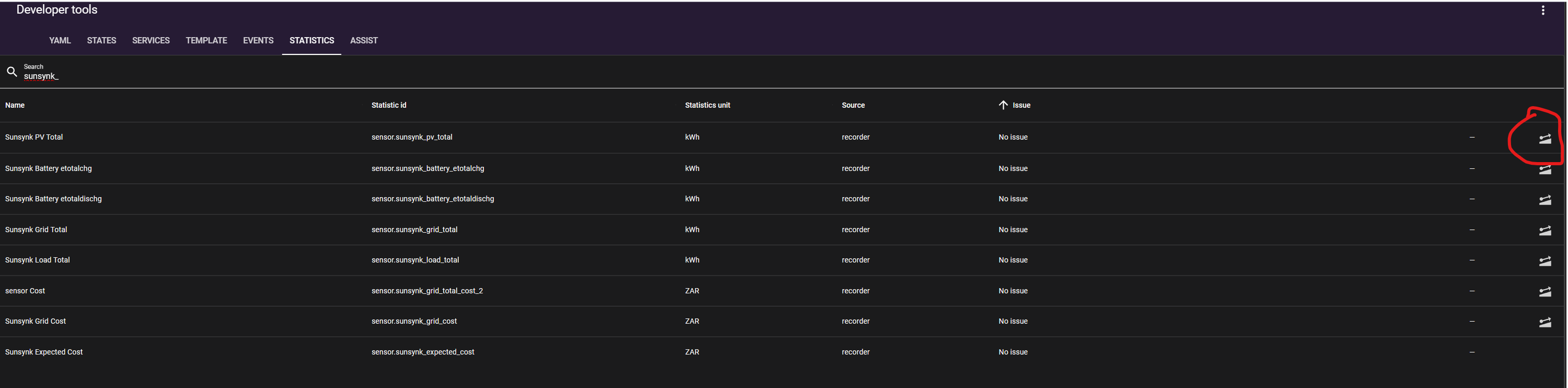

FYI : Sunsynk is importing the historical data atm. Had a nice "problem" I had to fix in my energy sensors this morning
I see my total energy sensors are also funky and abnormally high, yesterday my solar was showing 1600kWh and today I see the total grid, total return to grid and the total battery charge and discharge is showing some super high numbers.
12 minutes ago, Ronnie1102 said:
Thanks @Gary Waterworth importing and rebooting then will test.
You need to fix this through developer. Look on your energy screen to get an approximate time then in developer -> statistics
This is only a problem for the long term stats recorder. The short term stuff falls away after 7 days or so
Click on the icon on teh right
Go forward and back 30 minutes at a time and find teh large value and then 0 it out
Edited by Gary Waterworth
Ahhh thanks will look through and sort that out, all working now by the way appreciate your work!

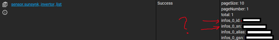

@Gary Waterworth Sorry but I need some assistance having a blond moment or am just blind as a bat.
##### sn_data:          Inverter SN to use for single data values
#####                   Do a run through then in node red look at global context data under
#####                   SS_Consolidat -> Config Data -> Inverter Plant
#####                   [Inverter SN]:[Plantid]
##### sn_flow:          Plant ID to use for flow data
Where to I get the global context data in node-red to get this info.  I tried my serial number on the inverter but then I get some sensor pulling data and some still as unavailable breaking some of my cards.
Or can I look this up on the v1.1 section and just input it and hit go.
if so lets say the id is 1234 and sn is 5678
which is which or do you mean both should be set as 5678:1234
[Inverter SN]:[Plantid] this is confusing me as well probably because I'm not seeing it where I should 🤷‍♂️
Node-red noobnish showing here 👀
[edit] See now you clearly say which is which and I think these are custom sensor I had setup that needs remapping, let me check that out gonna try those 2 ID's and see if things work.
[edit] Found the problem, proper case...
Some needed remapping and some had Capital letters that is now lower case.  Think I've got most sorted and the other sensor showing as unavailble might be because I didn't delete the old flow just disabled it to easily revert to v1.1 if needed.

Global Context
You may need to open teh debug view then pulldown top right , select context data , hit refresh button
SS :- General Work Area
SS_Consolid :- All Data actually pulled from account
SS_EXport_Data :- Processed Data that will be populated to the sunsynk_usable.* entities
This is the single function that is on it's own on that extra flow page.
Designed that way so it can be swopped in and out for different plant inverter setups.
Needs a lot of documentation so people can see how to edit it for their own needs
Because we are exploring all plants and inverters in an account , we cant just export everything to a single entity. I tried it and HA was not happy with a sensor of over 16k bytes :D
Thanks @Gary Waterworth got the correct plant ID now, freaking blind as a bat.

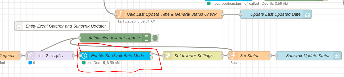

So do I need to set this to enabled then?  Flipping the sunsynk_auto_mode helper does nothing to the flow itself so I'm guessing that is just the indicator it use to trigger the 0 minutes to push the HA values through instead of pulling the data when it is set to enabled.
Edited by -cK-

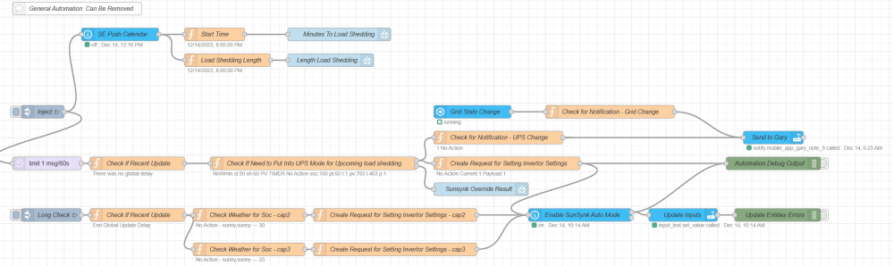

The input_boolean Sunsynj auto mode needs to be enabled.
That flow node should already be enabled
It will only show when a messages reaches it. So enable and then try change something
Awesome got it working 👍 not sure what the problem was but it's working now 😅
