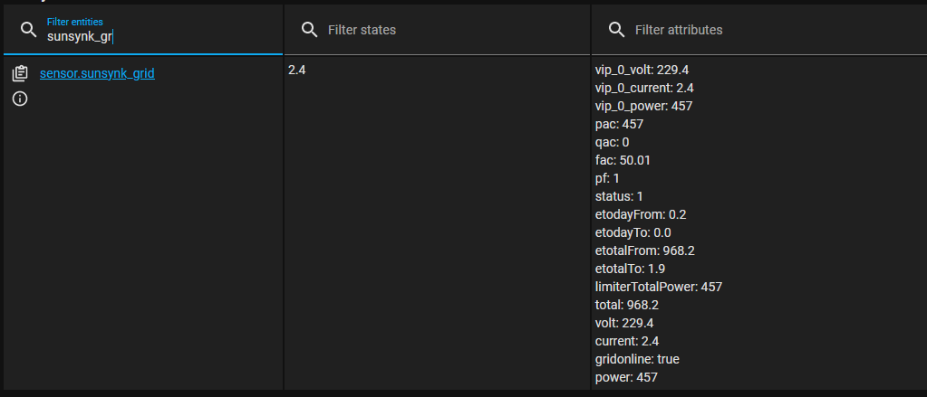

@HardeHout I finally got to play with the node red flows today and started creating/mapping all the sensors based on the required attributes. I have most of them as you can see below. The sensor you want is an attribute for the grid sensor.  You can create a template sensor and add to your configuration.yaml
169 - power attribute
172 - limiterTotalPower
  - sensor:
      - name: "Sunsynk Grid Power"
        state: >
          {{state_attr('sensor.sunsynk_grid', 'power')|float|round(0)}}
  - sensor:
      - name: "Sunsynk Grid Power 172"
        state: >
          {{state_attr('sensor.sunsynk_grid', 'limiterTotalPower')|float|round(0)}}
  - sensor:
      - name: "Sunsynk Load Power"
        state: >
          {{state_attr('sensor.sunsynk_load', 'totalpower')|float|round(0)}}

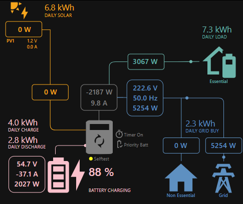

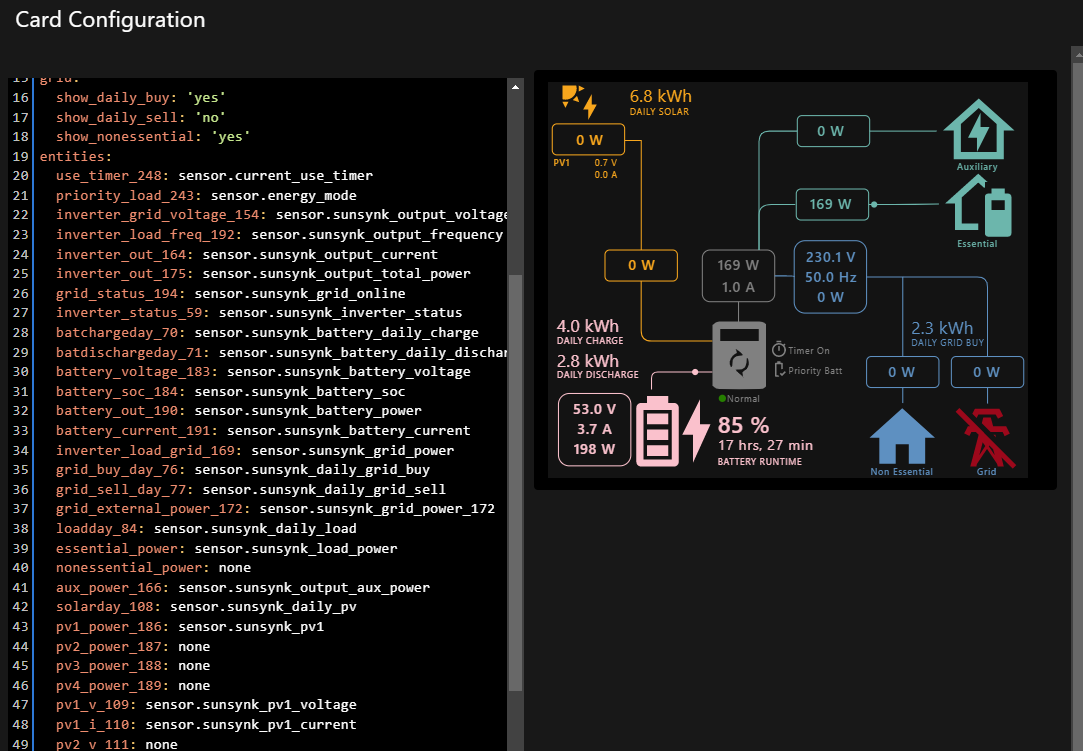

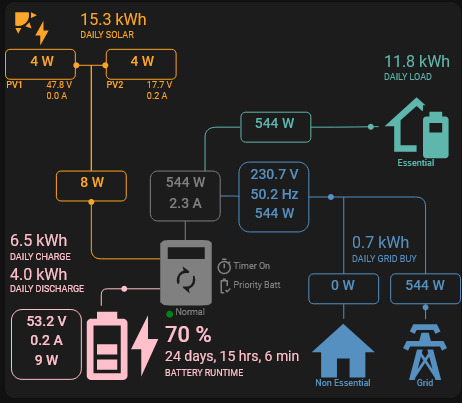

I've completed the mapping of the template sensors to work in the Sunsynk Power Flow Card and updated the WIKI with details. @Gary Waterworth I've also created a pull request to include updated templates and sample card configuration files in your repo. Attaching here as well
EDIT: Sorry I see I attached the wrong file. Fixed now
Sample Card for Power flow based on work by slipx on powerforum.co.za NEW.txt
Templates Slipx PowerFlow Card - NEW.txt
Edited by slipx
Sample Card for Power flow based on work by slipx on powerforum.co.za NEW.txt 1.85 kB · 0 downloads

@francoisj1 I provided working template sensors and card configuration in my post above. Its 98% there. Gary is busy checking a few things. You can simply copy and add to your configuration.yaml as it creates a complete new set of template sensors with mapping to the card attributes. The card config is also there as an attachment. I have template sensors for those xxx sensors that work. You should also set a default value i.e. float(0) when creating your sensors.
EDIT. Sorry I see I attached the wrong template file above. Fixed now. Note the filename

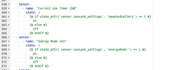

@slipx

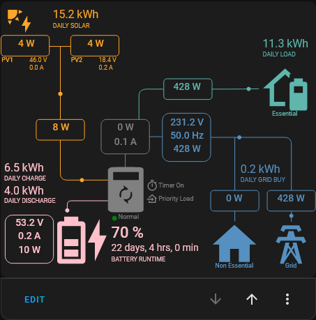

Checking out your new card, just a few things I've noticed so far that I had to amend to get it working correctly:
  - sensor:
      - name: "Sunsynk PV2 Current 112"
        state: >
          {{state_attr('sensor.sunsynk_input', 'pvIV_2_ipv')|float(0)|round(1)}}
should be:
  - sensor:
        state: >
          {{state_attr('sensor.sunsynk_input', 'pvIV_1_ipv')|float(0)|round(1)}}

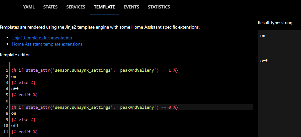

also I had to flip the on/off around to reflect correctly
  - sensor:
      - name: "Current Use Timer 248"
        state: >
          {% if state_attr('sensor.sunsynk_settings', 'peakAndVallery') == 1 %}
            on
          {% else %}
            off
          {% endif %}
  - sensor:
      - name: "Energy Mode 243"
        state: >
          {% if state_attr('sensor.sunsynk_settings', 'energyMode:') == 1 %}
            on
          {% else %}
            off
          {% endif %}
This gives me the correct read out on the card
  - sensor:
        state: >
            off
          {% else %}
            on
          {% endif %}
  - sensor:
        state: >
            off
          {% else %}
            on
          {% endif %}
Will try and figure out sensor 175 a bit later it is currently giving me 0W but think it should be at least equal to my essential load when running off grid (well in the previous card it would give me that reading so thinking it is just trying to pull from the wrong sensor)
Edited by -cK-
typo
Thanks that was a typo

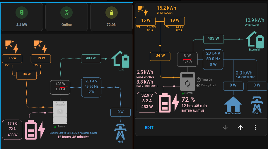

You should not have to flip the logic for Current Use Timer 248 and Energy Mode 243. I'm using them as is and it reports correctly. I'm testing on a 5KW Sunsynk. Maybe it is different for your inverter
And these are the sensor values
and the card logic expects
peakAndValley to be "on" for Use Timer Active
energyMode to be "on" for Priority Load, "off" for Priority Batt

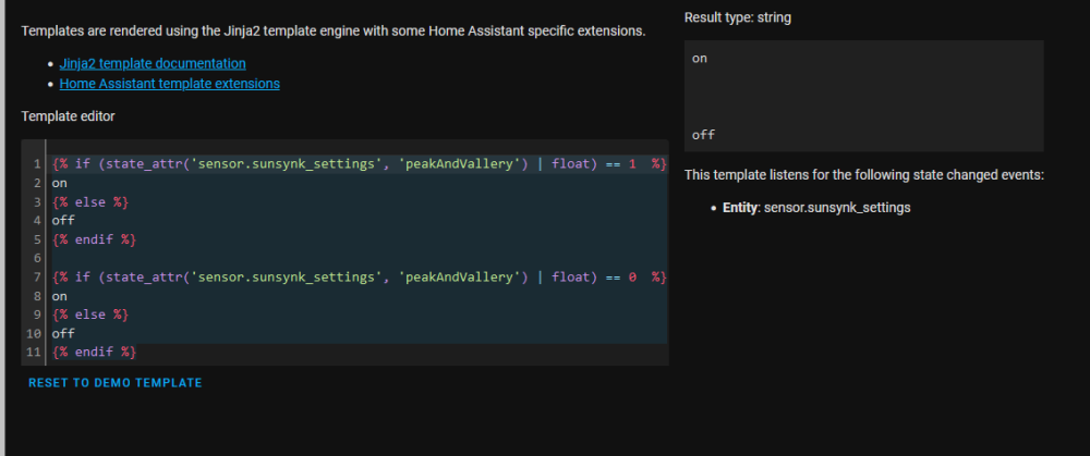

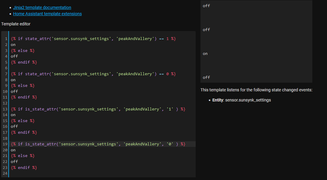

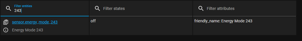

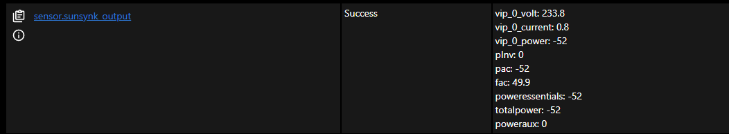

can you have a look at the attributes reported by this sensor
My EnergyMode is the opisite of yours but the peakandvallery isn't but if I flip it, it reflects correctly though 🤷‍♂️
I have fewer attributes listed it seems...
So it would seem my essential load reading would then just be 169 which would be grid power as 166 and 175 is reading sensors I don't have
Am I correct that in the previous card it pointed to the load sensor
Edited by -cK-
Additional info provided
It looks the same. My priority is set to Batt so its shows as 0. Yours is set as Load and it correctly shows a 1.
Check your sensors. Yours should be "on" using the original logic in the template
and your timer is enabled like mine so it should also be on
What inverter do you have? I wonder if its firmware related? Or maybe the integration is not reading all the data correctly
Edited by slipx
5kw Sunsynk

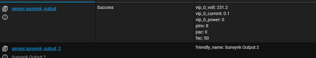

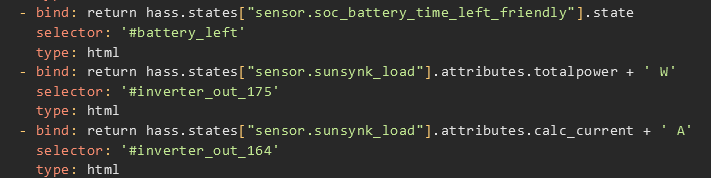

I've also amended 175 and 164 to the following as it would seem how Gary had is configured on the old card to test and see if it works correctly:
  - sensor:
      - name: "Sunsynk Output Total Power 175"
        state: >
          {{state_attr('sensor.sunsynk_load', 'totalpower')|float(0)|round(0)}}
  - sensor:
      - name: "Sunsynk Output current 164"
        state: >
          {{state_attr('sensor.sunsynk_load', 'calc_current')|float(0)|round(1)}}

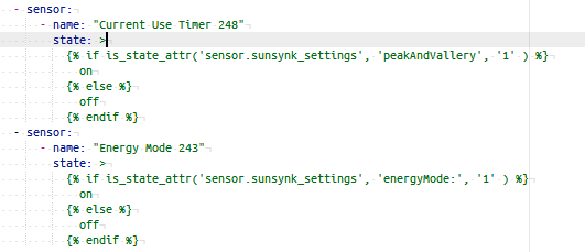

Okay looks like the orginal code isn't working on my end, the below is derived from my previous sensor and it would seem that rewriting the code to '1' instead off == 1 would fix it for me
Okay this would seem to be the fix for me 😉
  - sensor:
        state: >
          {% if is_state_attr('sensor.sunsynk_settings', 'peakAndVallery', '1' ) %}
            on
          {% else %}
            off
          {% endif %}
  - sensor:
        state: >
          {% if is_state_attr('sensor.sunsynk_settings', 'energyMode:', '1' ) %}
            on
          {% else %}
            off
          {% endif %}
Oh and I've amended 175 and 164 to the following as a test seeing as this is what Gary had it set to on the old card:
Seems to be working to give me a correct value but should probably note I do not have any non essentials hooked up anymore so don't know if this is the correct fix for people using non essentials
