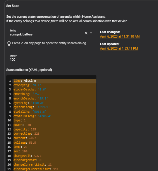

On 2023/04/03 at 3:24 PM, randomfool said:
Still unsure what I am doing wrong.
Go to developer tools -> states ... filter for sensor.sunsynk_battery
no look at the attributes
you are expecting a EtodayChg... since the state_attr  refers to the attribute for an entity
time: Missing
etodayChg: '11.4'
etodayDischg: '2.6'
emonthChg: '61.1'
emonthDischg: '49.0'
eyearChg: '446.1'
eyearDischg: '404.2'
etotalChg: '405.7'
etotalDischg: '365.3'
type: 1
power: 325
capacity: 200
correctCap: 200
current: 6.1
voltage: 53.2
temp: 19
soc: 99
chargeVolt: 57.6
dischargeVolt: 0
chargeCurrentLimit: 21
dischargeCurrentLimit: 192
maxChargeCurrentLimit: 0
maxDischargeCurrentLimit: 0
bms1Version1: 0
bms1Version2: 0
current2: Missing
voltage2: Missing
temp2: Missing
soc2: Missing
chargeVolt2: Missing
dischargeVolt2: Missing
chargeCurrentLimit2: Missing
dischargeCurrentLimit2: Missing
maxChargeCurrentLimit2: Missing
maxDischargeCurrentLimit2: Missing
bms2Version1: Missing
bms2Version2: Missing
status: 2
batterySoc1: 0
batteryCurrent1: 0
batteryVolt1: 0
batteryPower1: 0
batteryTemp1: 0
batteryStatus2: 0
batterySoc2: Missing
batteryCurrent2: Missing
batteryVolt2: Missing
batteryPower2: Missing
batteryTemp2: Missing
numberOfBatteries: Missing
batt1Factory: Missing
batt2Factory: Missing
correctcapacity: 200
etotalchg: 405.7
etotaldischg: 365.3
I think I have just fixed it and noticed what is wrong.
In the attributes when you look at "Entities" it shows for example "EtodayChg", but the attribute when you go to Developer Tools and States shows "etodayChg". I was not aware it would be different and did not know the Developer Tools State Attributes could differ from the entities attribute values.
Edited by randomfool

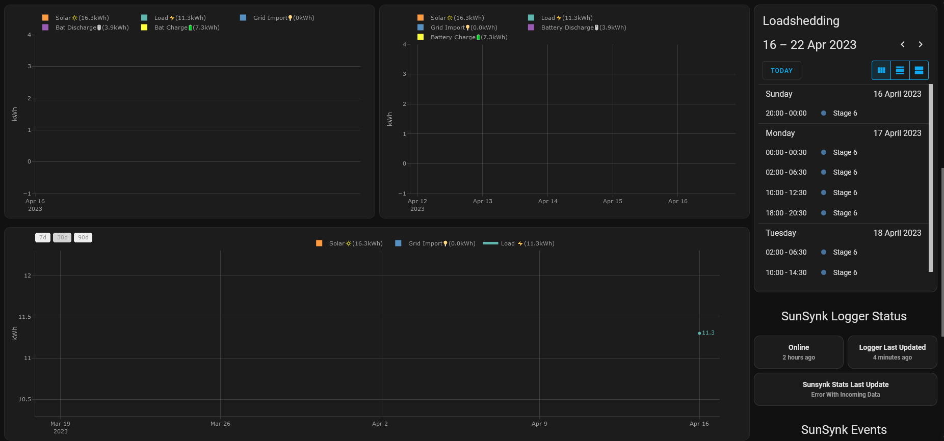

Ok here goes; caveats to begin with - I am no HA expert, in fact I only discovered HA a few weeks ago through Gary's post and his subsequent links to slip06x dashboard, so my ability to provide "support" will be limited. I am more than happy for any of this work to be updated and improved upon and added to any github to help others as needed. I will be making many other changes to suit my specific needs (e.g. integrating Octupus Agile automations and cards); have left this largely vanilla so you can customise to your own specific requirements.
All of that said; attached is the modified slip06x Sunsynk dashboard; I have made a few changes:-
  • Removed load shedding as it's not applicable to the UK
  • Moved some of the cards around; dropped the energy cards from the bottom as I felt they were a duplication although I may add them back in at a later date.
  • Today's graph focuses on last 6 hours; not 24 hour period (scroll still enabled). I'm still playing around with this and may change to 12 hours but for the UK a 24 hour period didn't look right to me.
  • Integrated Gary's Time Left to Discharge - this requires the Sunsynk automation flows Gary provided on his github.
  • Added the event card and integrated the timer card; note the "Override Mode" currently does nothing; and I will probably change this around in the coming months to better suit my needs.
  • Only 2 grid layouts; desktop (I am using 2560x1440 and it aligns perfectly) and mobile/tablet 800px - you will need to modify to suit your needs.
  • You will need to add the additions below to your configuration.yaml or equivalent.

Screenshots (Monthly Production missing from screenshots below but it is included on the dashboard, there is just no data as yet so I have not posted it):-

Just want to confirm the 3 bottom graphs are those based on the sensors that was just added in the config?  Asking as mine is blank at the moment so if it is based of the new sensors that will make sense why it is blank.
Will also see if I can figure it out how to swap out the SunSynk Automations for the loadshedding Calender as I don't use the automation of Gary just the gathering, pretty new to all of this myself and only google/youtube educated in HA 😅
Whoops just saw I need to go set my SOC back to normal (had 2 bad weather days so had to run long and deep to stay off grid)
Glad to see it's working for you. Re the daily and total that should populate tomorrow then onwards will work as expected (that's what happened for me anyway).
Monthly still has not populated anything for me, waiting until May to determine if there is an issue or not.

The monthly card should update each day but you need to use the right sensor i.e daily totals. It fetches HA statistics, calculating the delta between the daily totals of two consecutive days and then summing them.
      - entity: sensor.daily_load_power_kwh
        statistic: sum
          $fn ({ ys,meta }) =>
            "Load" + ""
        period: month
        type: bar
        filters:
          - delta
        texttemplate: '%{y}'
        marker:
          color: rgb(95, 182, 173)
On 2023/03/20 at 9:18 AM, Gary Waterworth said:

Trying to figure out why the monthly card isn't populating because to me it looks like it is pointing to the daily totals and if I understand slipx correctly it should update daily and then at the end of the month you end up with your montly total?
Any ideas what the issue might be
