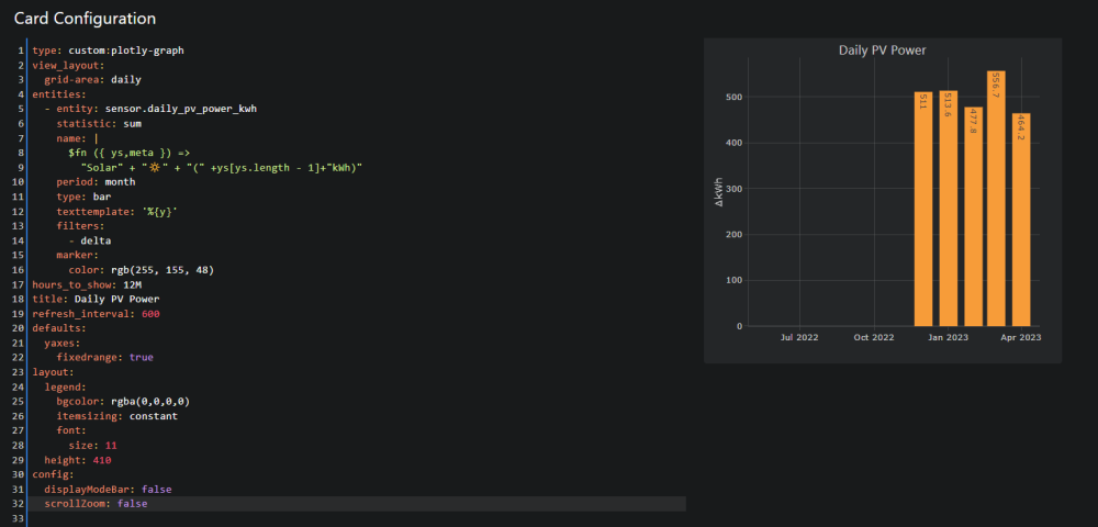

19 minutes ago, -cK- said:
Trying to figure out why the monthly card isn't populating because to me it looks like it is pointing to the daily totals and if I understand slipx correctly it should update daily and then at the end of the month you end up with your montly total?
Any ideas what the issue might be
Have you tried creating a monthly view for just one sensor?
type: custom:plotly-graph
view_layout:
  grid-area: daily
entities:
  - entity: sensor.daily_pv_power_kwh
    statistic: sum
      $fn ({ ys,meta }) =>
        "Solar" + "" + "(" +ys[ys.length - 1]+"kWh)"
    period: month
    type: bar
    texttemplate: '%{y}'
    filters:
      - delta
    marker:
      color: rgb(255, 155, 48)
hours_to_show: 12M
title: Daily PV Power
refresh_interval: 600
defaults:
  yaxes:
    fixedrange: true
layout:
  legend:
    bgcolor: rgba(0,0,0,0)
    itemsizing: constant
    font:
  height: 410
config:
  displayModeBar: false
  scrollZoom: false
** Ignore the graph Title

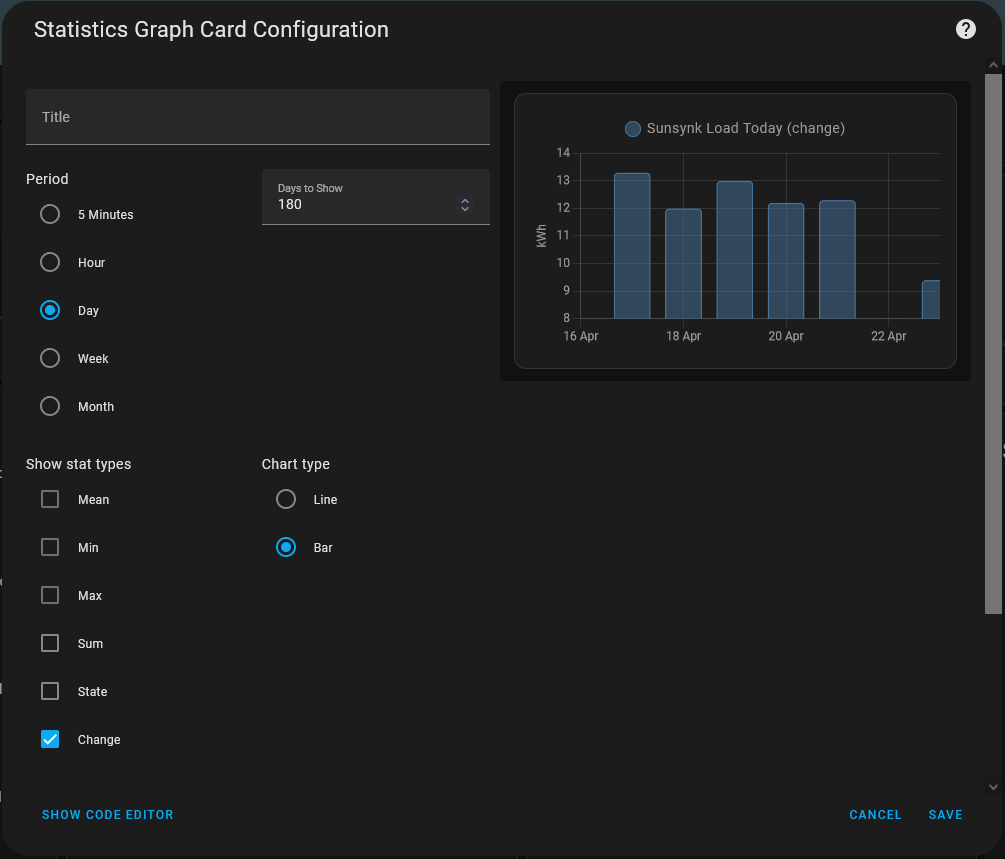

If I set it to a Month I get nothing
If I set it to Day or Week I get data

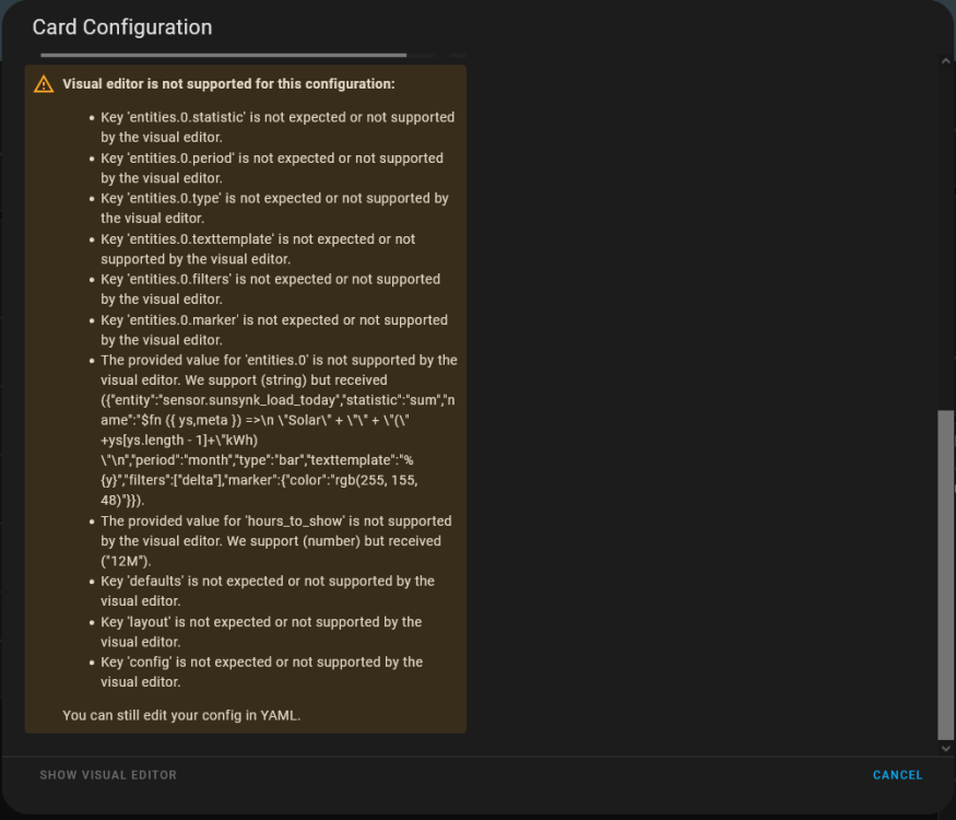

Trying the first suggestions did kick out this:
  • Key 'entities.0.statistic' is not expected or not supported by the visual editor.
  • Key 'entities.0.period' is not expected or not supported by the visual editor.
  • Key 'entities.0.type' is not expected or not supported by the visual editor.
  • Key 'entities.0.texttemplate' is not expected or not supported by the visual editor.
  • Key 'entities.0.filters' is not expected or not supported by the visual editor.
  • Key 'entities.0.marker' is not expected or not supported by the visual editor.
  • The provided value for 'entities.0' is not supported by the visual editor. We support (string) but received ({"entity":"sensor.sunsynk_load_today","statistic":"sum","name":"$fn ({ ys,meta }) =>\n \"Solar\" + \"\" + \"(\" +ys[ys.length - 1]+\"kWh)\"\n","period":"month","type":"bar","texttemplate":"%{y}","filters":["delta"],"marker":{"color":"rgb(255, 155, 48)"}}).
  • The provided value for 'hours_to_show' is not supported by the visual editor. We support (number) but received ("12M").
  • Key 'defaults' is not expected or not supported by the visual editor.
  • Key 'layout' is not expected or not supported by the visual editor.
  • Key 'config' is not expected or not supported by the visual editor.
You can still edit your config in YAML.

4 minutes ago, slipx said:
Looks like you don't have enough data points, only a couple of days so you just have to wait.
Okay thought so after seeing the days and weeks working, patience was never my virtue 😁

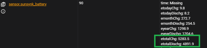

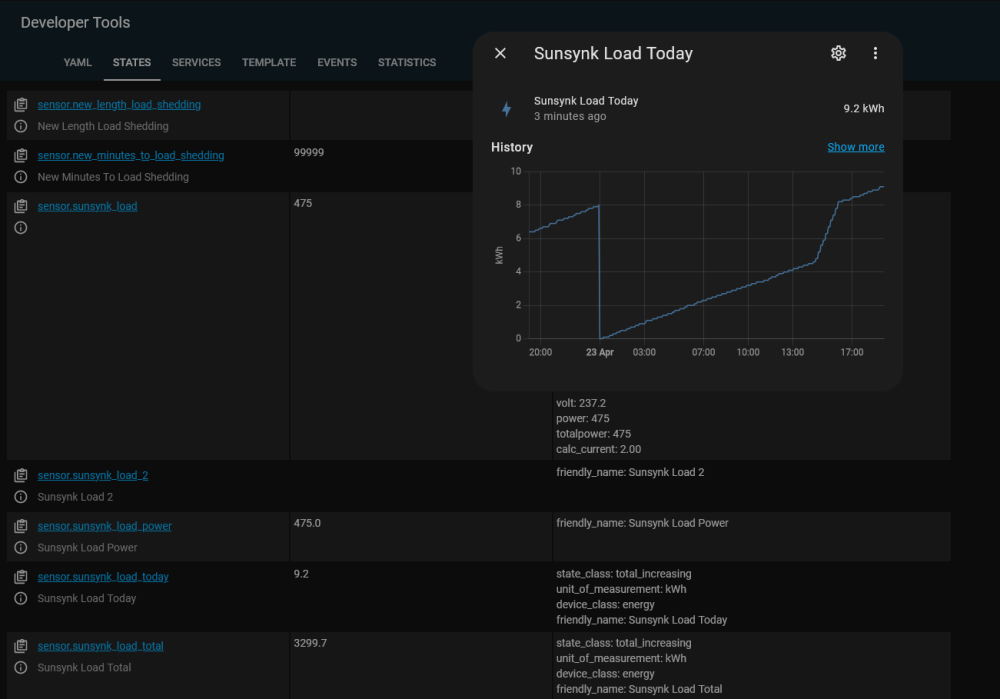

1 hour ago, slipx said:
You can also check using the statistics graph?
Just some notes on the best attributes to use for statistics .
Dont use the "today" ones. They reset sometimes at odd hours and it screws with the stats.
This is a royal PITA and I have spent too much time trying to make the today ones work.
One of a few quirks I have found with data from the sunsynk website.
Use the "forever" increasing ones that never reset like ( examples ):
They will have *total* in the name
When you create the template that uses them. To setup as a energy ( statistic ) do it like this :
  - sensor:
      - name: "Sunsynk Battery etotaldischg"
        state_class: total_increasing
        unique_id: "sensor.sunsynk_battery_etotaldischg"
        device_class: energy
        unit_of_measurement: kWh
        state: >
            {{state_attr('sensor.sunsynk_battery', 'etotaldischg')|float}}
NB
state_class: total_increasing --> This then takes teh difference between the start and end measurement time to get the ammount used.
Always make sure you convert the string to a float :) Been caught like this to often where I think it is dealing with a number when it isnt.
Always give it a unique ID. You end up with funny entity crap sometimes when you dont
Edited by Gary Waterworth

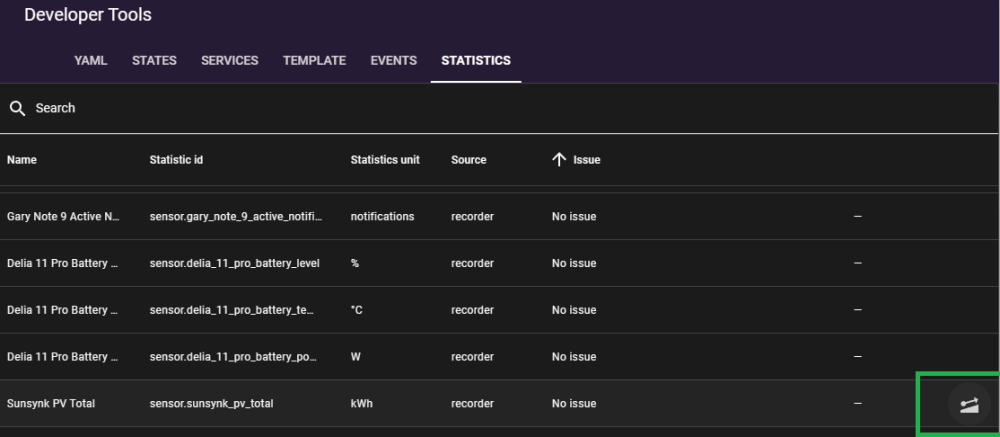

To check if you are getting data
Development tools -> Stasistics -> Click on icon for entity
Will only see an icon like this for state class: total_increasing.
You can use this to fix errors etc
Should see some collected data points
