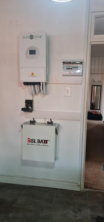

Had my system installed today, went with BSL battery, Sunsynk batteries was out of stock at the supplier and the contractor managed to give me the BSL at the same price. Thanks for all the advice here, I really appreciate it.
