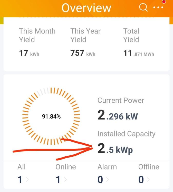

May 29, 20233 yr It seems that once equipment is sold the user is stuck. Following the update if the Solis Cloud APP it seems that Solis does not even care if the APP lost some functions. I wonder if there are any tests after an update as even the landing page being an overview one can see the PV installed is shown as zero. All places in the APP the correct data is displayed for 1 inverter. The 2nd inverter on the profile they changed the size. Further if they add up 1.5+1.5 their results is 2.5 🤔 Now if they don't even act on the bad reviews it shows they don't really care. 1st picture shows the zero value of the new version. @SEGEN SOLAR @James Frank
June 7, 20233 yr Author Just an update on the problem I encountered with the new cloud APP. In order to get the % generation to be displayed again turned out as simple as logging out and back in. Yes it is this simple if one just knew or if a standard msg is sent via the daily msg function in the APP. I was sorted out by Solis SA support by Charles after he bounced it to China. It is just a pity that a lot of daily data is gone for good as part of the upgrade. No wonder i am so against upgrades if it is not known that the upgrade has merit and fixing bugs. I wish I could roll back. As it stands if a go back to view my daily stats I find some 4 days in succession the APP shows the same values which is not correct. Luckily I had it recorded but still bad that the historic data will then never be correct. 😕 Some days even show a zero Wh value. Some members reminded me that this is the norm when one uses the manufacturer's cloud APP.
