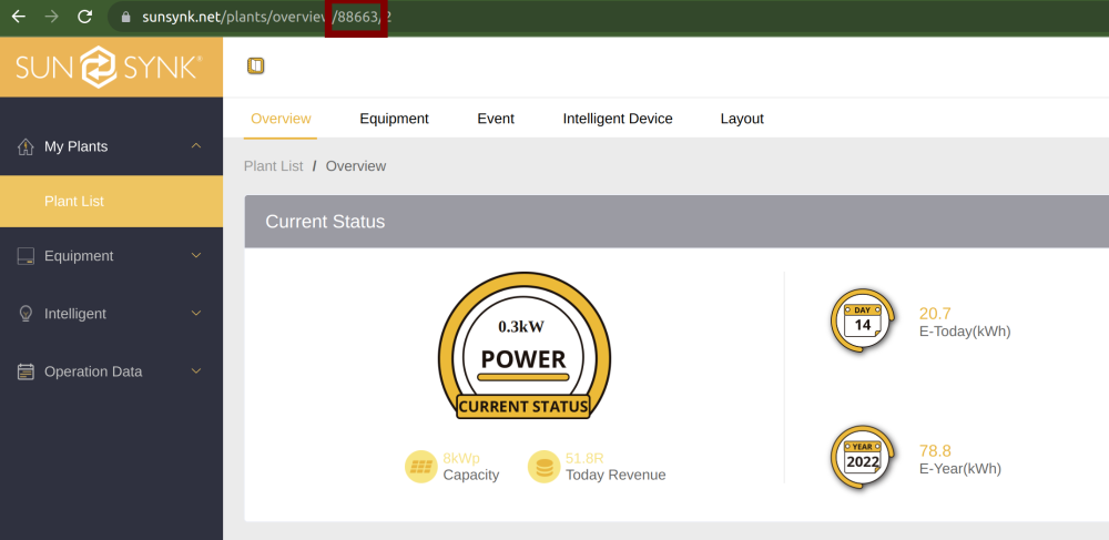

9) In the script set your Sunsynk connect username and password on rows 4 & 5 for SUNSYNK_USER and SUNSYNK_PASS. Then set SUNSYNK_PLANT on row 6 with the plant ID you see if you login to sunsynk connect in your browser. E.g. mine is 88663:
