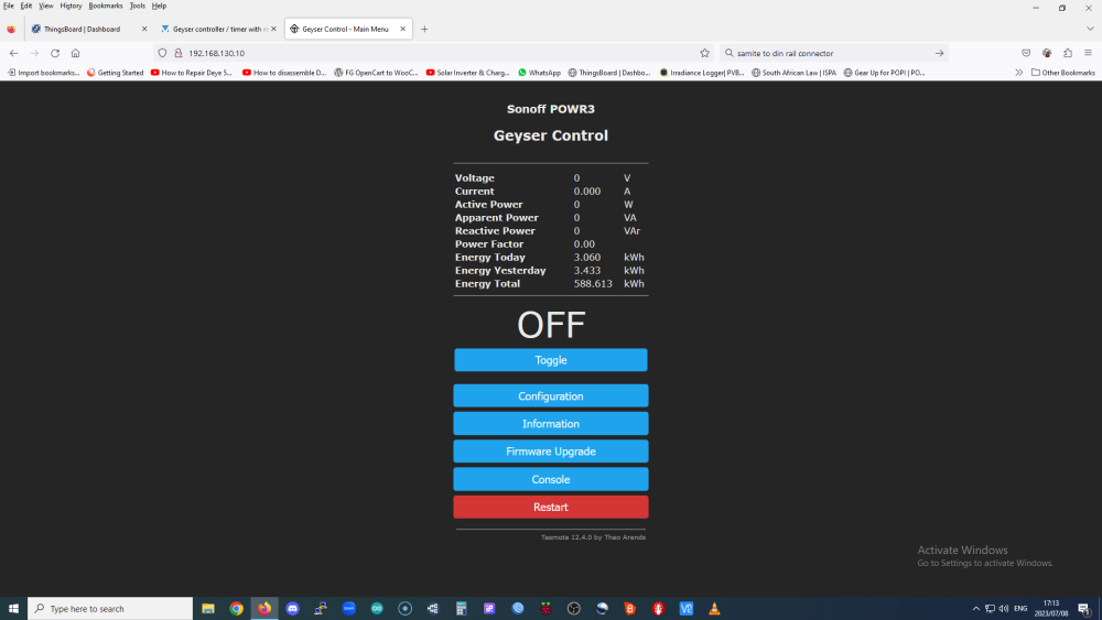

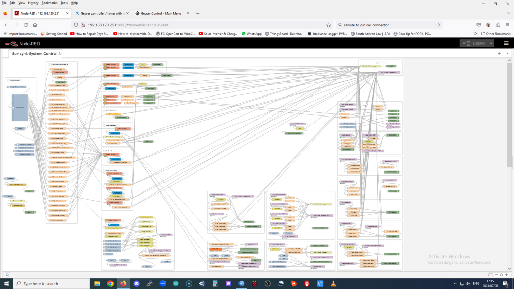

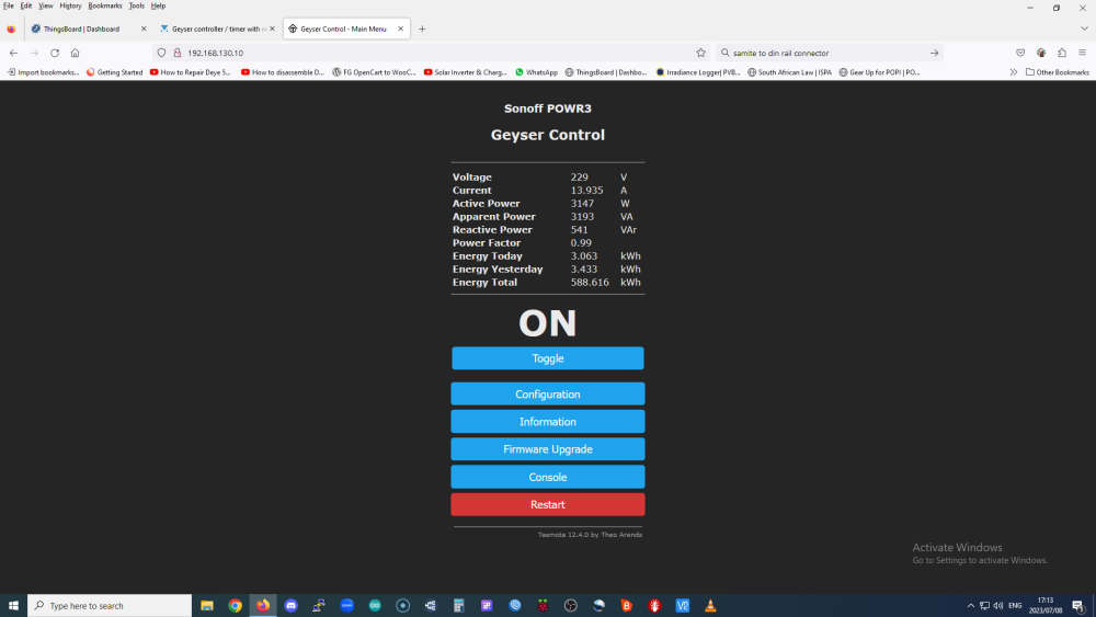

Mine is a tasmotised-POWR3 which checks for loadshedding, battery SOC, available solar etc and then  "decides" if it should be on or not. Most sunny days it runs midday, but on the odd winter days it comes on automatically if/when needed and draws from the most efficient power source available.

Control side
RPi4 with nodered+mosquitto mqtt broker
Automation side
Whole bunch of tasmotised smart switches and monitoring devices
Mostly Sonoff and visia power monitoring switches and plugs.
https://github.com/arendst/Tasmota
I personally do not use home-assistant but many here on the forum do:
https://www.home-assistant.io/
https://nodered.org/
Here is a nice simple to follow guide:
https://ezcontents.org/mqtt-home-automation-rapsberry-pi
Nice easy to follow guide on using powr3 ( perfect for geyser control ) and tasmotise it
