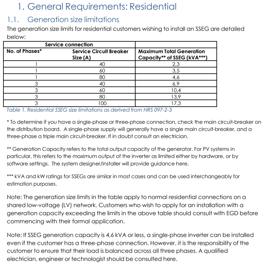

3.6kW
So, I have two questions.  Various folks are saying various things on various numbers.
So far as I understand it, the limit for a GTI is 3.5 not 3.6.  So if I want an inverter given the rules I would need to go for one of these instead of one of these?
The rules from CoCT appear pretty clear on this.
So what gives on the 3.5/3.6 numbers going on here on the forum?
Further, the main breaker is generally rated at 63A not 60A (it actually says so on my breaker).
Would this make any material difference to the above 3.5/3.6 number?
Don't flame me, just asking because I am a bit confused on the numbers.

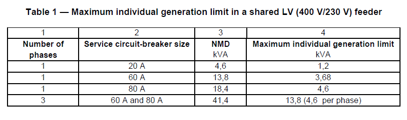

17 hours ago, Fuenkli said:
I am also not sure. According to NRS 097-2-3:2014 it is 3.68kW
So those PF members with off-grid installs will be looking for another source of power other than the "Utility" and assuming the setting would "SBU" with U being on prem AC source. yes/no?
9 hours ago, Power Me said:
Wouldn't be anywhere near as bad as the massive load switching that occurs at the end of a load shedding interval.
True... the difference is you KNOW this one is coming and you can manage it. It's a bit different when you're at the mercy of the weather (again, don't get me wrong, I don't necessarily agree with their interpretation, just trying to be fair by acknowledging it's not exactly neutral).
So, I have read through NRS-097-2-3-final-2014.
It says the following with regards to the limits that @Fuenkli posted:
Quote
NOTE The values have been adjusted to align with VDE-AR-N 4105 and hence vary slightly from 25 % of the NMD. For circuit-breaker sizes not included  in  table  1,  the  maximum  individual generation  limit is 25 % of the customer notified maximum demand, i.e. 25 % of the circuit-breaker size. The individual limit is only dependent on the service circuit-breaker rating, and not on the feeder After Diversity Maximum Demand (ADMD). Future refinements of these criteria will assess the incorporation of ADMD into the decision framework.
So, the NMD for a 60 amp breaker is 13.8 KVa, thus 25% is 3.45 KVa (3.5 rounded up).
So, I believe that CoCT has gone with the strict 25% of NMD rather than the adjusted values given VDE-AR-N 4105.  It is a partial interpretation and thus to my mind irrational in terms of the law and disqualifies CoCT from saying 'we are just applying the NERSA rules'.
This explains the discrepancy, but it doesn't explain why they have chosen to do this given NRS and VDE-AR-N 4105 and inverter sizes in this range.  It isn't just a 0.1 KVa limit, it is in effect is a 0.6 KVa limit.
This doesn't really affect me as I only have 3kw of panels, but I do have space for a couple more, so I would likely have gone for a 3.6 inverter so I could safely add a couple of additional panels down the line if I wanted to.  But I am sure there are plenty of folks which might have existing 3.6 installations.
