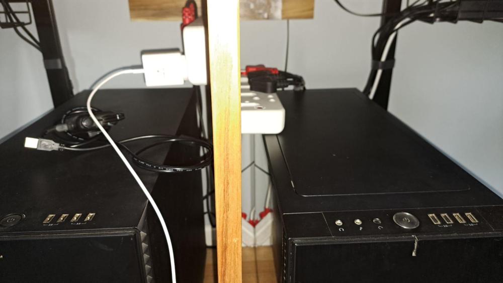

September 6, 20232 yr Hello All Hoping you can put my mind at ease as I've looked over the internet and other forums with various answers but nothing ultimately conclusive. I did realize at some point that i did something silly. First the equipment: My Inverter - Mecer 1200 VA - Modified sine wave My surge protector - ELECTRICMATE 1 X 16AMP + 1 X SCHUKO HIGH LEVEL SURGE PROTECTED ADAPTOR - GENTECH (gentechindustries.co.za) Second - How it was connected at the time: a) Inverter was plugged OUT of the wall socket (battery mode) b) Extension cable went across where another extension cable plugs into it and goes to 2 multiplugs that 2 pc's and router and ONT are plugged into (See attached) So, i plugged the surge protector into the extension cord as seen in the screenshot attached - while the inverter made a weird "bzzz" then realized my computers weren't recieving power. So, i thought well "that is odd" and took out the surge protector once, turned on my PC , no problem, then did it again - without issue again. The inverter stayed on the entire time. Then i looked at the manual and had a mini stroke - "Dont plug into inverter" Baring in mind every "seems" fine now Now my question is - were my PC's at any point in danger of electrical damage? I cannot find any information online as to "why its bad or what the potential damage could be"
September 6, 20232 yr 16 minutes ago, aggressiveGrey said: Hello All Hoping you can put my mind at ease as I've looked over the internet and other forums with various answers but nothing ultimately conclusive. I did realize at some point that i did something silly. First the equipment: My Inverter - Mecer 1200 VA - Modified sine wave My surge protector - ELECTRICMATE 1 X 16AMP + 1 X SCHUKO HIGH LEVEL SURGE PROTECTED ADAPTOR - GENTECH (gentechindustries.co.za) Second - How it was connected at the time: a) Inverter was plugged OUT of the wall socket (battery mode) b) Extension cable went across where another extension cable plugs into it and goes to 2 multiplugs that 2 pc's and router and ONT are plugged into (See attached) So, i plugged the surge protector into the extension cord as seen in the screenshot attached - while the inverter made a weird "bzzz" then realized my computers weren't recieving power. So, i thought well "that is odd" and took out the surge protector once, turned on my PC , no problem, then did it again - without issue again. The inverter stayed on the entire time. Then i looked at the manual and had a mini stroke - "Dont plug into inverter" Baring in mind every "seems" fine now Now my question is - were my PC's at any point in danger of electrical damage? I cannot find any information online as to "why its bad or what the potential damage could be" If the inverter still works you should be ok remember any surge protection device needs to be on the ac input side when using inverters it should have been a problem if your inverter was an true sine wave inverter( nice smooth sinewave without distortions) being a square wave output inverter it had a reaction to the Mov's( metal oxide varistors) inside the surge plug. The surge multiplug needs to be in the 16amp wall socket supplied by Eskom( db board).
September 6, 20232 yr Author 2 minutes ago, TaliaB said: If the inverter still works you should be ok remember any surge protection device needs to be on the ac input side when using inverters it should have been a problem if your inverter was an true sine wave inverter( nice smooth sinewave without distortions) being a square wave output inverter it had a reaction to the Mov's( metal oxide varistors) inside the surge plug. The surge multiplug needs to be in the 16amp wall socket supplied by Eskom( db board). Ironically - im less worried about the inverter - super worried about the computers
September 6, 20232 yr 25 minutes ago, aggressiveGrey said: Hello All Hoping you can put my mind at ease as I've looked over the internet and other forums with various answers but nothing ultimately conclusive. I did realize at some point that i did something silly. First the equipment: My Inverter - Mecer 1200 VA - Modified sine wave My surge protector - ELECTRICMATE 1 X 16AMP + 1 X SCHUKO HIGH LEVEL SURGE PROTECTED ADAPTOR - GENTECH (gentechindustries.co.za) Second - How it was connected at the time: a) Inverter was plugged OUT of the wall socket (battery mode) b) Extension cable went across where another extension cable plugs into it and goes to 2 multiplugs that 2 pc's and router and ONT are plugged into (See attached) So, i plugged the surge protector into the extension cord as seen in the screenshot attached - while the inverter made a weird "bzzz" then realized my computers weren't recieving power. So, i thought well "that is odd" and took out the surge protector once, turned on my PC , no problem, then did it again - without issue again. The inverter stayed on the entire time. Then i looked at the manual and had a mini stroke - "Dont plug into inverter" Baring in mind every "seems" fine now Now my question is - were my PC's at any point in danger of electrical damage? I cannot find any information online as to "why its bad or what the potential damage could be" If the inverter still works you should be ok remember any surge protection device needs to be on the ac input side when using inverters it should have been a problem if your inverter was an true sine wave inverter( nice smooth sinewave without distortions) being a square wave output inverter it had a reaction to the Mov's( metal oxide varistors) inside the surge plug. The surge multiplug needs to be in the 16amp wall socket supplied by Eskom( db board).
September 6, 20232 yr Author 3 minutes ago, TaliaB said: If the inverter still works you should be ok remember any surge protection device needs to be on the ac input side when using inverters it should have been a problem if your inverter was an true sine wave inverter( nice smooth sinewave without distortions) being a square wave output inverter it had a reaction to the Mov's( metal oxide varistors) inside the surge plug. The surge multiplug needs to be in the 16amp wall socket supplied by Eskom( db board). I did realize it after it happened, the whole supplied by Eskom bit - but ye not finding much info online as to what any "effects" would be in doing the "mistake" that i made... and a few times too.
September 6, 20232 yr 1 hour ago, aggressiveGrey said: So, i plugged the surge protector into the extension cord as seen in the screenshot attached - while the inverter made a weird "bzzz" then realized my computers weren't recieving power. Why would you want to use a surge protector to begin with? Yes, there are numerous rumors to the alleged benefit of it. And if at all it only makes some sense right at the input from the grid. If you are in a region with underground service - forget about it! Even with over head connection the risk is extremely remote. One may argue that there are lots of high voltage overhead lines feeding the low voltage distribution that are exposed to lightning. That's correct. However those are protected with their own surge protectors. The power companies do this to protect their own equipment like cables and transformers. Another thought is that in today's electronic prepaid meters there must already be some sort of surge protection to protect their own electronics.
September 6, 20232 yr Author 2 minutes ago, Beat said: Why would you want to use a surge protector to begin with? Yes, there are numerous rumors to the alleged benefit of it. And if at all it only makes some sense right at the input from the grid. If you are in a region with underground service - forget about it! Even with over head connection the risk is extremely remote. One may argue that there are lots of high voltage overhead lines feeding the low voltage distribution that are exposed to lightning. That's correct. However those are protected with their own surge protectors. The power companies do this to protect their own equipment like cables and transformers. Another thought is that in today's electronic prepaid meters there must already be some sort of surge protection to protect their own electronics. Ye was more ignorance than anything, basically "in case" loadshedding cause surge..
September 6, 20232 yr Author But ye, im going nuerotic... because i don't have the knowledge of what potentially could of happened by doing what i said in OP
September 6, 20232 yr You don't need a surge protector after your inverter. It's not going to play nice with square (modified) wave. Your computers are fine if they still power up. https://electronics.stackexchange.com/questions/10340/is-it-safe-to-use-surge-protector-with-12vdc-mobile-power-inverter Edited September 6, 20232 yr by jbroo
September 7, 20232 yr Author 11 hours ago, jbroo said: You don't need a surge protector after your inverter. It's not going to play nice with square (modified) wave. Your computers are fine if they still power up. https://electronics.stackexchange.com/questions/10340/is-it-safe-to-use-surge-protector-with-12vdc-mobile-power-inverter Any logical way to think otherwise even if they power up? Just kinda want to understand if theres a scenario where it had some effect
September 7, 20232 yr Not really. Unless they are exhibiting problems or reporting errors, they are probably fine. Not really sure what you're looking for here...
September 7, 20232 yr Author 10 minutes ago, jbroo said: Not really. Unless they are exhibiting problems or reporting errors, they are probably fine. Not really sure what you're looking for here... well in my OP i stated: Now my question is - were my PC's at any point in danger of electrical damage? I cannot find any information online as to "why its bad or what the potential damage could be" and 11 minutes ago, jbroo said: they are probably fine Probably here is the keyword, because i dont know, seems nobody else knows the "practicality" of what generally happens in this situation nor can i find conclusive thoughts about it online
September 7, 20232 yr There seems to be a fair amount of information on the internet, depending on what you search for. https://www.informit.com/articles/article.aspx?p=31105&seqNum=12 https://www.youtube.com/watch?v=Utxdioq4lNk https://www.velocitymicro.com/blog/top-10-signs-of-power-supply-failure/
