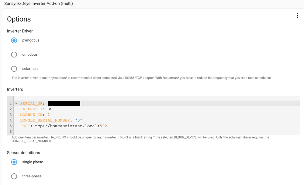

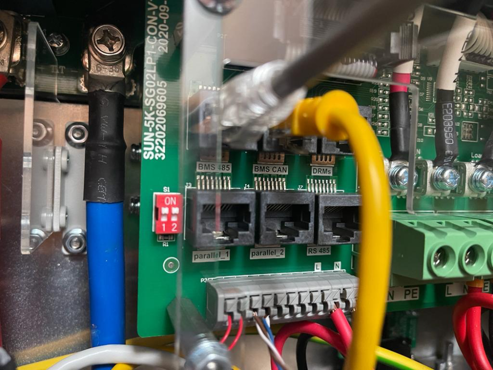

Thanks again for all of the help here, a big request for assistance here, so I am still unable to communicate with my 5kw sunsynk, here is my sequence of installation:
Purchased the USB to RS485 Converter Cable, 4 Pin adaptor as recommended
Then wired a rj45 according to T568B spec as follows:
Then wired the converter according to the table in the T568B table as follows:
Orange/white to B
Orange to A
Green/white to Neutral
Went through the Youtube installation process, installing the add on etc.
As im already running Mosquito on my paradox install I used the same username and password there
Used the following settings in the configuration
Then plugged the RJ45 into both the BATT485; the 485 port and neither are generating any comms the only other option appears to be the BMS CAN port which I also plugged into and all results were the same
all of these returned the same result as pasted below.
The log file fails at the initial comms:
11:07:41 INFO    Added hidden sensors as other sensors depend on it: Rated power, Serial
11:07:41 INFO    Connecting to tcp://homeassistant.local:502
11:07:41 INFO    PyModbus 3.4.1 tcp: homeassistant.local:502
11:07:41 WARNING Failed to connect Multiple exceptions: [Errno 111] Connect call failed ('172.30.32.1', 502), [Errno 111] Connect call failed ('172.30.232.1', 502), [Errno 111] Connect call failed ('192.168.68.148', 502), [Errno 22] Invalid argument, [Errno 22] Invalid argument, [Errno 22] Invalid argument, [Errno 22] Invalid argument, [Errno 22] Invalid argument, [Errno 22] Invalid argument, [Errno 22] Invalid argument, [Errno 22] Invalid argument, [Errno 22] Invalid argument, [Errno 22] Invalid argument, [Errno 22] Invalid argument, [Errno 22] Invalid argument, [Errno 22] Invalid argument, [Errno 22] Invalid argument, [Errno 22] Invalid argument, [Errno 22] Invalid argument, [Errno 22] Invalid argument
11:07:41 INFO    ############################################################
11:07:41 INFO        Could not connect to tcp://homeassistant.local:502:
11:07:41 CRITICAL This Add-On will terminate in 30 seconds, use the Supervisor Watchdog to restart automatically.
I have also been through as many of the online posts to try find out the reason for this but to no avail, this is my second round after getting a similar outcome on the ESP32 option.
I have the usb adapter plugged directly into an intel NUC running HAOS which currently runs the cloud (nodered) sunsynk connection with slow update and no ability to write settings back to the inverter. I doubt this could be a conflict.
Somehow I suspect that it could be
1. the port settings in the config ?
2. need for separate driver install in HAOS (never outlined in any docs) ?
3. Possible faulty RJ45 termination although these were the push through type and I triple checked them before trimming ?
4. Possible mosquito username/password issue but seems to fail at base comms and have copied directly from the Mosquito config.
5. Other modbus settings I could not figure out im pretty sure
Really appreciate any input I can get here

Hi @Dunc
Sorry to hear you are struggling.
1. Have you tried disconnecting the ground? Not sure that it is necessary and may be causing issues, maybe try no 2 1st

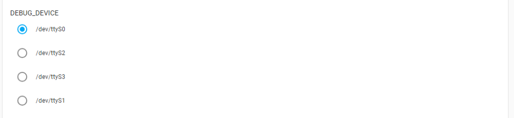

2. Would check that you are on the correct USB port, Settings/System/Hardware/All Hardware and it will give you a list
Thanks Scoobs
Not entirely sure as to which usb setting I should use, I think S3 was auto selected, I then selected S0 but this returned the same error, I then tried the one that stood out in syntax namely /dev/serial/by-id/usb-1a86_USB_Serial-if00-port0
This also failed with same message
The hardware list seems to have the same entries they all seem to be appropriately initialised and have the same sequential values the only one that stands out with populated data is this below where there is a clear difference between ttyS0 and tty USB0 ? Strange
I have swapped the various usb ports on the NUC with no alteration
I then removed the ground connection and tried again with no change
