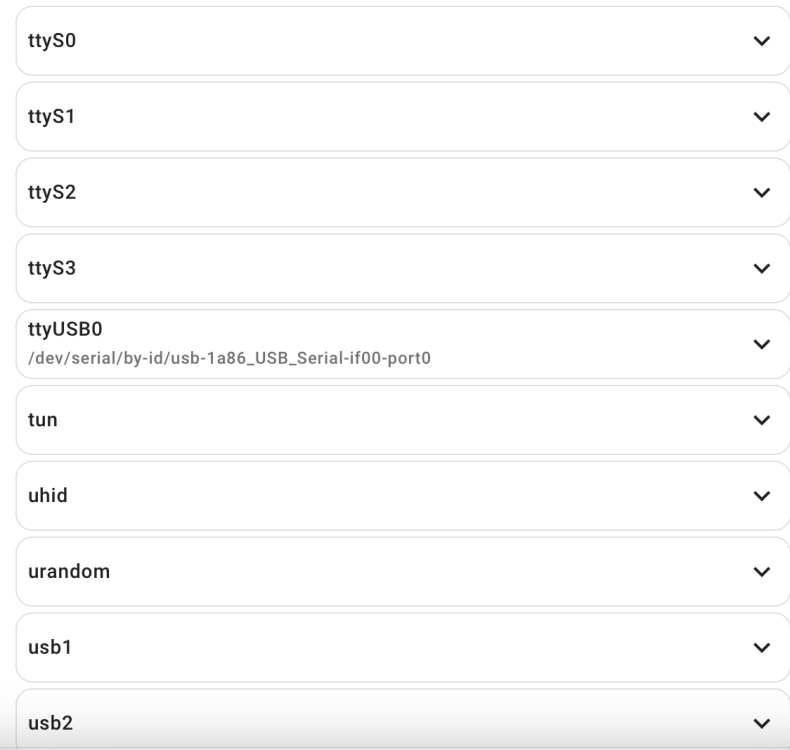

@Dunc your port is wrong - it tried to connect to an IP on port 502. This is typically the port that the mbusd addon would expose, but no mention that you use it?
Set the port to an empty string - "" then use the DEBUG_DEVICE to select the usb port

I am struggling to connect with a USB-RS485 adapter to my sunsynk 8kva inverter. I have the new sunsynk dongle so I cannot use the solarman integration.
Have a pi4 running home assistant connected to the inverter but just can't seem to get the MQTT connection working. Anyone have any idea why?
On 2023/09/20 at 8:50 PM, Sc00bs said:
I am doing the easy stuff :-), @kellerza does all the heavy lifting 🙂
Maybe just buy a USB - RS485 adapter, is dead easy to set up
I am having a similar problem. Bought a usb rs485 adapter. Connected it to my pi 4 but can’t seem to pick it up on the Mqtt mosquito. If you don’t go via solarman do you need the esp32 integration?

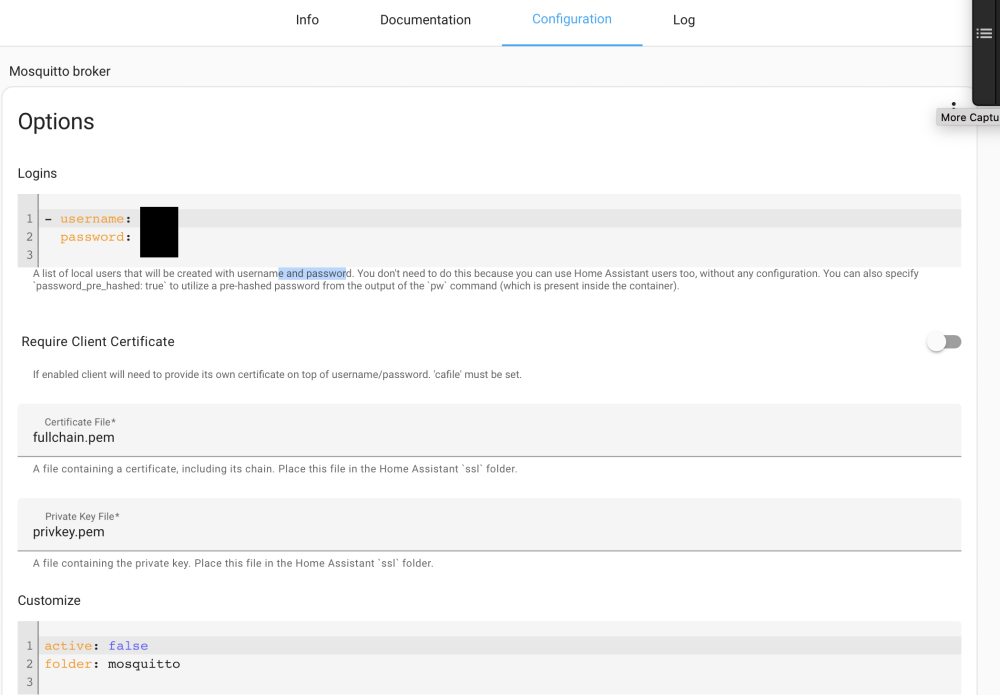

Hey, I just tried to install the mttq integration to my home assistant. - I hit a snaque... after following instructions in the above video - the mosquito starts well but after configuration in the video there is 1 device and was it 61 entities - I have no devices nor entities... - can not check states and so on... - I think something went wrong. Any hints / suggestions?
I am a bit newbie in here so bare with me ;(
I have Deye hybrid inverter which I am trying to control according to electricity price.
after restart moquette log:

So this seems ok - right?
Sorry folks - my stupidity... Port configuration was mistyped... now it works ;)

Not sure if this will help you, but may help someone :)
When using the RS485 to USB method, the port needs to be changed to /dev/ttyUSB0 (substitute the 0 with 1 or 2 or 3 or however many USB ports you have)
I was lucky and it picked it up as USB0.
