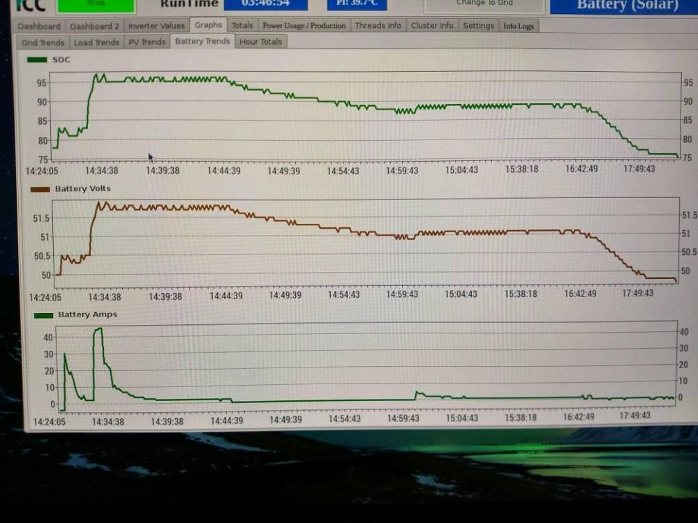

It would seem that I have solved my particular issue. I tried @Coulombs suggestion and lowered the voltages only for it to have no effect. I then figured I'd just check all the wires again and low and behold one of the red and black coms wires were loose. 😤 It was seated properly in the slot but the holding screw wasn't done up very tight so the cable pulled a bit when I added tension. Tightened it all up and all seems well. I can only assume the loose wire was causing some form of miscommunication between the two inverters.
The offending wire.
Expected output readings finally happening with no voltage spikes
The afternoons results.
