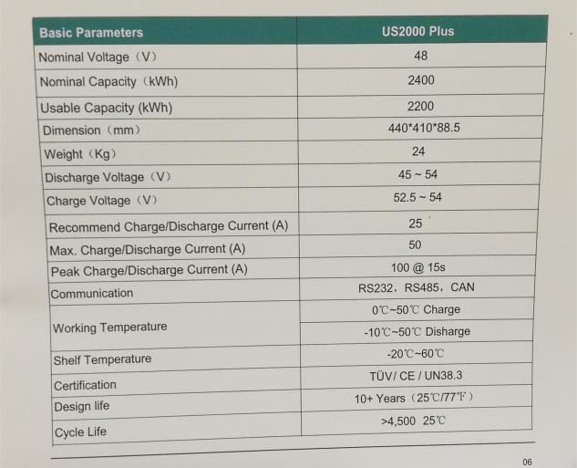

therein the problem, i can [not ;-)] fork out another 28k for two pylontechs [plus a washing mashine] hence an option using the sun's energy
