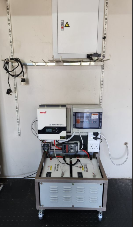

So where this trolley is now, the batteries will be stacked, and the inverter to the left and slightly lower than the DB board. Yep, it is pretty much plug and play, especially the batteries. In process to determine what is the Estate requirement in terms of their Master Electrician sign-off and any other requirements
