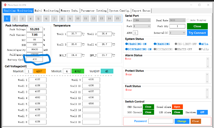

I would like to tag along with this post as I want to know the Battery Cycles on my Freedom Won 10/8 S/N: FW2022-37299. This has a USB-B port on the left hand side next to the Reset button.
PBMS Tools are installed.
When the USB cable is plugged into the laptop, it makes the sound denoting a USB device is connected.
Port defaults to Com3.
When I select the "Try Connect" button, it comes up with an error messagimage.pnge.
The ADDR cannot be set.
Any suggestions?

50 minutes ago, Sidewinder said:
@SRTosen ,
In @Steve87 's port 3 above, he specifies how to "talk" to a FW 10/8. You can't use PBMSTools, as only the FW eTower has a Pace BMS.

Looks like the cycle count is not available.
