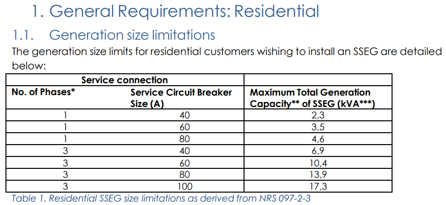

The limit you on the main breaker in the DB board to what size inverter, from here: CoCT Regulalations
4 minutes ago, plonkster said:
It's just a matter of time, it almost certainly will be certified BUT... the more direct issue is that you need an 80A feed from the grid to install a 5KVA (grid-tied capacity is is less than the allowed 4.6kva). Many houses only have a 60A feed and can't install a 5KVA.
I have a 3-phase installation at 60A per phase, albeit currently essential loads are on one phase and non-essential loads on the others. Does this have any impact on the above point?
Edit: Based on TTT post, am I allowed 10KVA generation capability?
This is where it gets more confusing for the newbies, the Goodwe ES 5048 is 4.6kw and on the list, the 5KVA multi would result in 4kw, but we might have an issue?
Well, how many inverters were you thinking of buying? 🙂
For a full three phase backup solution you will need three inverters, and they'd have to be less than 10.4KVA combined which again leaves you with 3KVA per phase.
