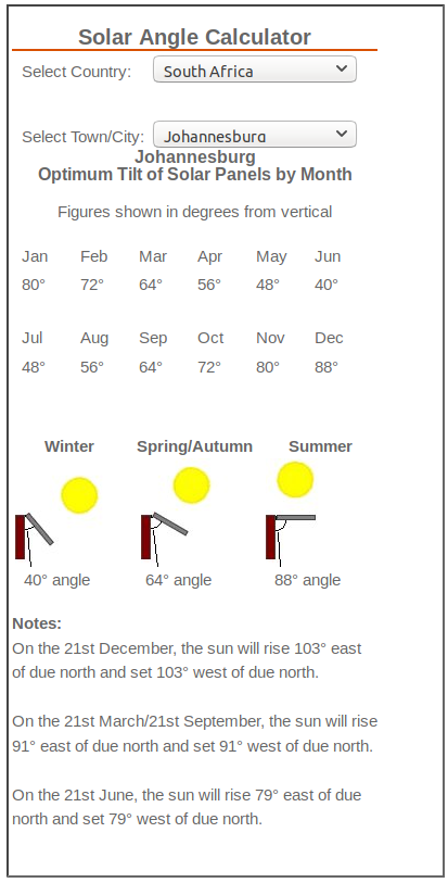

Oh, and I know this isn't optimal, but honestly I'd just put them flat on it. See here. Angles are from vertical (ie subtract it from 90). At almost 20 degrees you are just about bang on for November and February. It would be better to aim for October/March in my opinion (around 30 degrees), but weigh up the cost as well as the aesthetics.
Valid points, is there a way to calculate the potential loss by mounting at 20 degrees? I can then perhaps oversize the array by a panel or two to compensate for the loss.
You multiply the irradiance by the cosine of the angle of incidence.
So in summer you are 10 degrees off, 0.175 radians, cos(0.175) = 98.5%. So 1.5% loss.
In early autumn/late spring you're just about bang on.
In winter you're off 72-48 = 24 degrees, 0.42 radian. cos(0.42) = 91%, so 9% loss. Also in winter you have the additional loss in the atmosphere (1.5 atmospheres), but that is unavoidable.
So an extra 300W module ought to do the trick 🙂
Bias the array towards the winter angle as in summer you have more hours of sunshine, but in winter more power drawn because of heating geysers etc.

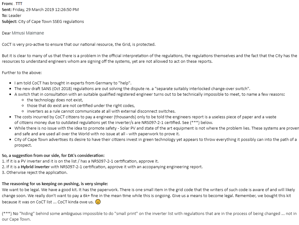

So I though, let me email the DA "chief in charge" i.e. Mmusi Maimane re. our solar plight, same email I sent last to the local guys.

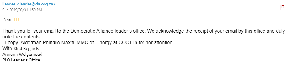

Low and behold, they acknowledged the receipt and it was forwarded, I gather it is from "top dog" to "top dog" locally.
Lets see where this goes ...
I sent this email - like I said, it is not engineer against engineer, it is non-engineer to official whom must "help" me. 🙂
Edited by Guest
The point I am pushing is that if I have spoken locally, then gone up the chain a bit, then to the very top. Somewhere someone may realize, probably in a meeting, that the same person is pressing all the buttons up and down the chain taking up "their time" - that WE pay for - so deal with this matter sooner.
It MAY just be that one last straw, I can dream, that allows the CoCT engineers to start talking to  the voter payed for engineers and not having some oak somewhere pushing an ulterior agenda. They got badly burnt with Zille / Lille saga's.
@Rautenk @The Bulldog @plonkster @Fuenkli - join me in the emails? Send it to Mmusi Maimane's office, let them send it down the chain?
Would be really nice Plonkster, if our mutual friend at Victron can also send a email via the same office, with some more technical details?
Rautenk, maybe you have a few people that could send a email or two?
Bulldog, your engineer, maybe you?
It is a shot in the dark but guys, we need to get the attention of the right person somewhere inside this official structure.
Edited by Guest
Thanks @Fuenkli
Makes me wonder, how many people will do as we did?
This is no longer a engineering debate, that ship has sailed, because if it was an engineering debate, then it would have been resolved.
This is a political / Eskom hot potato. A voter / citizen of Cape Town debate. We are being stopped to be part of the solution, because "someone" is going to lose income.
PS. If she does not respond, forward that email to the DA leader, CC her in. Put some pressure all round. 😉
