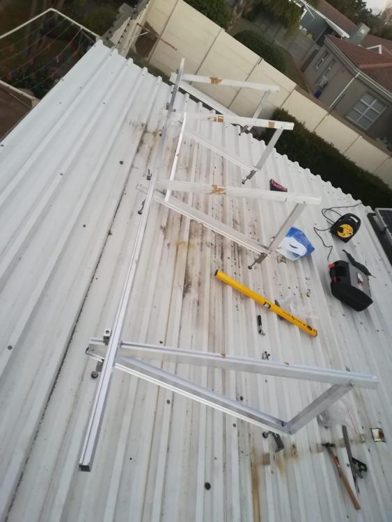

I recently put up a new frame (space for 4 x 350W modules). I also bought 3 x PV modules but let's assume it was 4. The PV modules would have been R7400, about 8k with delivery. The Frame was 3.5k with delivery. That was before labour (cause I mos werk verniet 😛 ). OK, so this was triangles for a flat roof... but  if I had to put brackets on a tile roof the time it takes to neatly move roof tiles and make a notch in them with an angle grinder where required will hit you again on the labour side.
So truth be told, 2k for the panel and 1k for the hardware to mount it... and some labour on top. 1.3k is probably not that far out. Will probably get better when you do larger arrays, I do believe the daily fee weighs heavy on TTT's number.
Just to give you an idea. Some years ago (about 5) I made a frame from steel. I had a welder, steel was cheap, and I knew it was a stop-gap thing at the time. You do what you have to. I threw that frame off the roof 3 weeks ago. This is what it looked like.
Now that frame took a few days to make! The steel was cheap, but it had to be cut to size, welded, and then painted more than one layer (that was the downfall of this one... wrong product!) and finally installed on the roof. I replaced it with this one (about halfway done on this picture):
53526711_10156850160200619_8505897651273728000_o.thumb.jpg.65076e99e227b33dba83db16fdf2d4f2.jpg
The material was three times the price, but the labour was so much less!
(Yes, that is a level... cause apparently I have OCD... and yes that is an non-cordless drill... cause the cordless has a dead battery) 🙂

Now in terms of time, I spent an hour or two spead over a few days. I estimate I had the job done in about 8 hours. That is man alone -- as in I have to get off the roof and fetch my own tools. So I guess a man with a team could probably do it in a bit less... but that man has overheads. It adds up, but for good reason.
