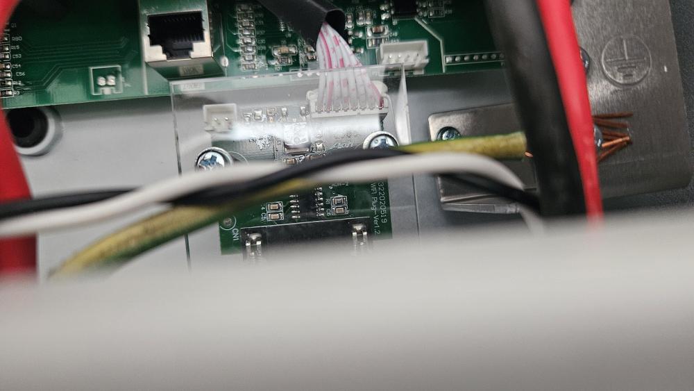

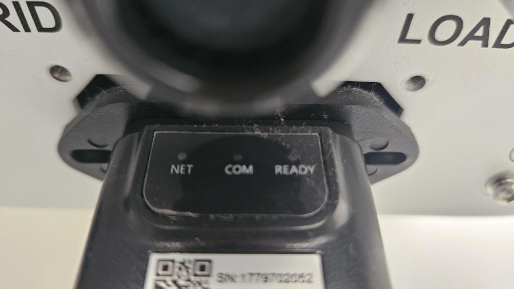

Hi all. Have a deye 8kw inverter, the wifi module doesnt power on. Bought a replacement  module and the same occurs with the new module stick logger lsw-3.
There is a small board inside the inverter, that the module connects  too. Where can i buy this module? Im assuming a capacitor went or something.

1. Could it be a setting in the deye inverter that enables it? If so where in settings do i go to enable the logger?
2. Where can i purchase the little board that it connects too? Attached pic... wifi plug v1.2 or so it says

I also have the same problem on my Deye 8kW inverter, the logger's lights are all dead.

  7. You may need to set up the Solarman Smart app again (I had to) and get the dongle connected. The Net light will only illuminate if you've set up the app correctly - it involves temporarily connecting to it's Wifi connection via your phone.

The issue is not the dongle itself, but the wifi port inside the inverter that is damaged.
The WiFi on my Deye 8k stopped working yesterday, the inverter is about 10 months old and has been working well so far..............anyway, after much searching I found a solution on Youtube; https://www.youtube.com/watch?v=5pgZurPpJqI&t=426s. It's hard to see exactly what he is doing but you basically have to break/remove the little resistor, C9 on the top left corner of the module. After that the dongle will light up and start working again. I don't know what the resistor is for so I am looking to get a new board sometime soon but this does work. For safety, make sure everything: grid, solar, and battery, are turned off when you are doing this.
replace the c9 100nf
I was about to spend an awful lot of money on a new Wifi logger which would not have worked. https://www.youtube.com/watch?v=5pgZurPpJqI For those like me who do not understand the language. Power down everything going through the Inverter, mains, batteries, Inverter power switches, absolutely everything. You do not want to accidently make contact with a live wire although you would have to be very careless to do so. Anyway once you have removed the cover you will see a small board that your Wifi Stick is connected to and in the top left corner there is that small white connector which in my case had nothing plugged into and likely yours to. Next to that on the right is the cause of all your problems, the C9 capacitor who's only function appears to be failure. I used a narrow tipped flat head long screwdriver to break it off, took a small amount of force to work it loose. Scrape against it from right to left so you do not risk breaking something else off ,right to left means if you slip all you will hit is that white connector block. My wifi is fixed and 100% working now.

Mine stopped working yesterday and I'm still identifying if it's the logger or the wifi rs232 board. I've identified a lot of the components of that pcb but am not sure about this 100nf.
So to recap, I removed c9 and my wifi logger is back on. I am going to draw this circuit for that board, however, I think c9 was dead short but I don't have a connection that seems to use it. I'll replace it when I can find a replacement.
