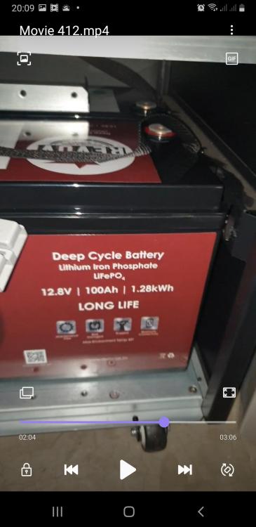

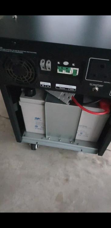

Drop in Lithium-ion for SLA
Got tired of replacing Sealed Lead Acid batteries
Decided to try Li-Fe on the trolley inverter with no lithium charging option.
The REVOV 12v battery is supposedly a drop in replacement for lead acidand has a built in BMS you can monitor via bluetooth
So far so good!
 Wish me, and the poor BMS luck🫣
So far so good!
Update: all works fine.
The BMS's have have registered their first full cycle with me.  They came with 1 from factory. I've suspect their quality checking. But they've never hit zero %, so I suspect the BMS counts a cycle each time the batteries produce 100Ah or 100% of their capacity?
E.g. the 2x50% discharges I've done now = 1 cycle?

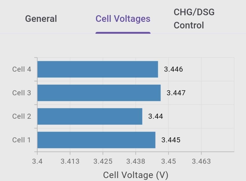

@BigotedUncle,
Great, seems you got it right...BUT....
Monitoring overall battery voltage is not a 100% method of determining COV (Cell Over Voltage).
Your battery Voltage may be say 14.2V max (add may I add again Voltronics based inverters tendency to overshoot) will give you ave 3.55V per cell. Still safe.
However, what you don't know is what each cell is doing in the battery pack. e.g. instead of 3.55+3.55+3.55+3.55 = 14.2V,
you could be unknowingly sitting with: 3.55+3.44+3.55+3.66 = 14.2V.
So overall all looks OK, but cell no.2 is undercharged, and cell no.4 is overvoltage.
Hope you can find a better monitoring tool for this battery.
Unfortunately,  many such Apps don't do this, and one wonders what went wrong.
Typically, Manufacturers have proprietary software to show UV/OV, and 3rd party solutions sometimes is possible,  depending on how available the battery info is, and some very clever people to decipher all of this info! Any that's why it is relatively easy for them to proof OV condition at the cell level, even if your monitoring system shows everything is within limits.
Good luck. Hope your new battery will not fail you soon!

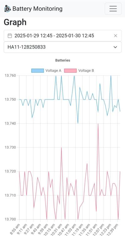

P.s.

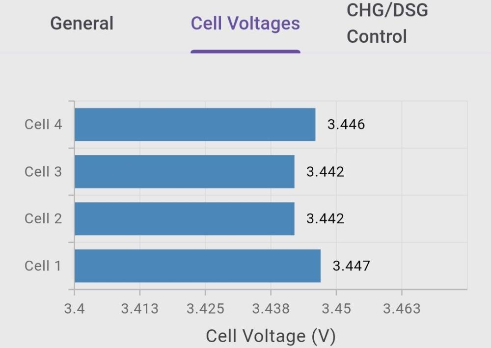

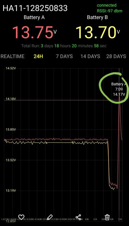

Incase you're curious, this is a snap shot of how the REVOV batteries maintain the 13.7 float voltage of the battery manufacturer.
I'll keep watching them!

5~7mv delta that is a well balanced battery.

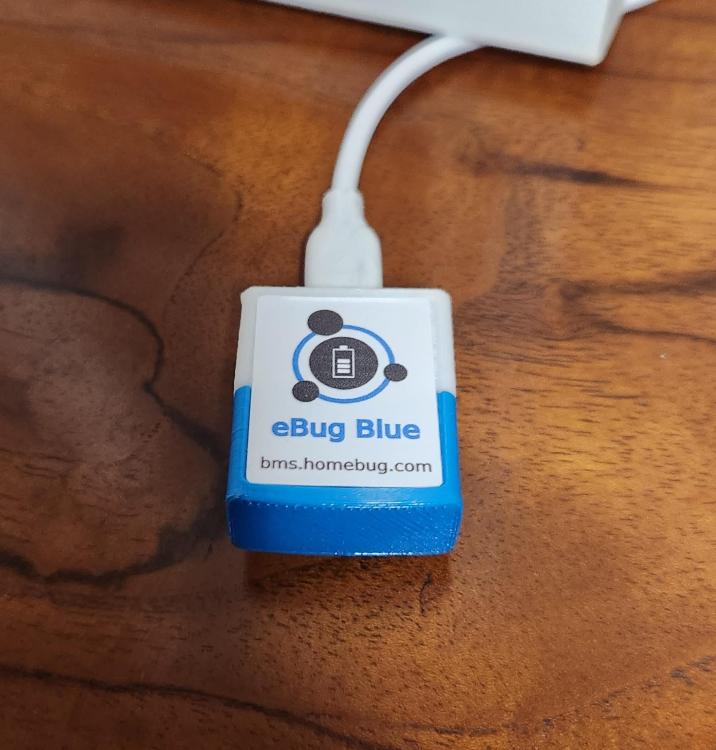

I am trying to use some remote monitoring tool from homebug, poor choice of name 😅 (https://homebug.com/product/ebug-blue/) , but no luck... I want to be able to monitor the batteries bms even when remote, over wi-fi. (instead of only when standing next to them)
the device only shows the Battery Equalizer (which shows a good ballance), but not the actual battery BMSs in the batteries... I contacted https://homebug.com/ Asking them for support.
wish me luck
P.S. Locally the 8 cells are between 3,440 and 3.448 Volts and the Battery Monitor is looking at the Battery Equalizer. This i can view remotely thanks to the home bug.
